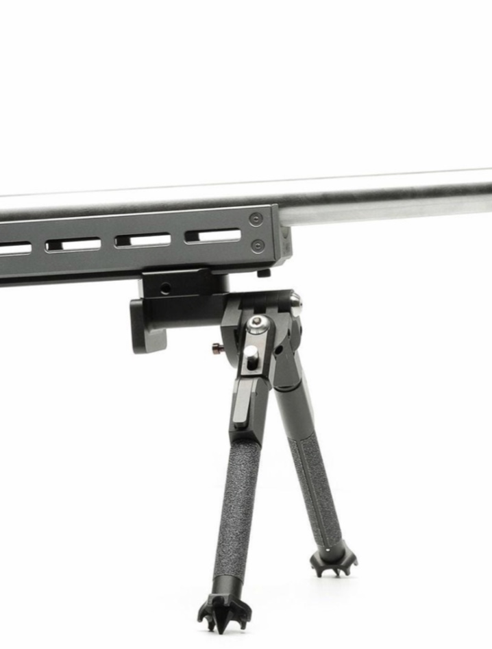

    I realize that RRS and Sawtooth Precision both make Arca rail options for the AI AT and I've been talking with Area 419 about their Universal Dovetail rails (10" and 12") and they say it should work if I purchase AI keyslot hardware from AI. Has anyone actually tried this with success?
    Why not just get the Sawtooth or RRS you ask? The reason is I really like the idea of the Area 419's scalloped lock slots, but I also realize I could easily use Area 419's barricade stops with the Sawtooth/RRS without the lock slots. One question I do have is even with the Sawtooth (10.9") it extends beyond the end of the AT chassis, for those who've used it, how sturdy is that portion when using a bipod? I'm wondering if this option can do away with the spigot altogether... thanks in advance for your input.
    I used the Sawtooth on my AT and currently use a Sawtooth on my AX and love it. Yes the rail extends past the front of the stock of the AT, negating the need for a spigot. I never had any issues with the part that extends past flexing, but I know Frank mentions it in one of the Everyday sniper podcasts. In my opinion you would really have to be loading the bipod excessively or not have the keyslot screws torqued all the way down. Maybe there was a tolerance stacking issue? Idk but I never had any issues with it.
    My recommendation would be the sawtooth rail and no spigot. Keeps it super streamline. The RRS adds some height to an already tall AT stock. I have no experience with the Area419 product, but don’t think it is necessary. I have never had anything slip on the Sawtooth arca rail.
    ^^^ thank you blb, that is the direction I was leaning, seems the Sawtooth is highly regarded. While I like the idea of the Area 419's scalloped dovetail, it may be more heartache trying to get their rail to fit just right with the spacing of the AT keyslots. Thanks also for the info on the extension and flex under load, good to know you have not run into any issues with this.
    @wjm308 I don't know how you'd actually attach the Area 419 rail to the forend using AI KeySlot screws. They are M8 LH threaded and have a proprietary interface, so they definitely will not thread into the Area 419 rail, and using any other type of fastener (M-Lok or Key Mod) will be a bandage approach.
    While the Area 419's Arca-Lock is cool, it is not needed if you use a RRS-dovetail spec rail and bipod clamp.

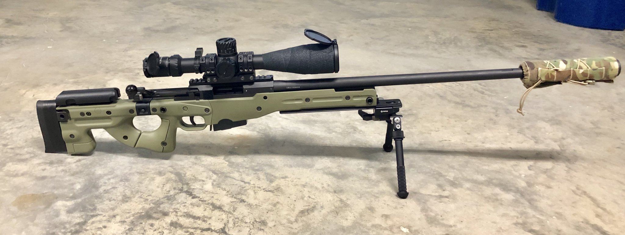

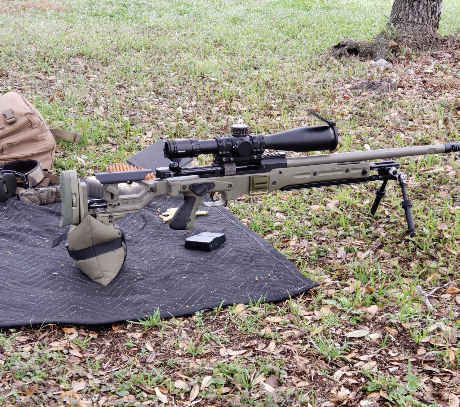

    Picture for reference of Sawtooth rail on AT
    The problem with that, is the front-most KeySlot screw location is about 1.5" from the end of the forend. Then you've got your additional ~3" of rail extending in front of that. When you load the bipod, it causes the rail to flex down, which amplifies the problem because it's pulling away from the forend - not pushing it up into it. Of course if you don't put your bipod in front of the end of the forend you shouldn't have that issue.

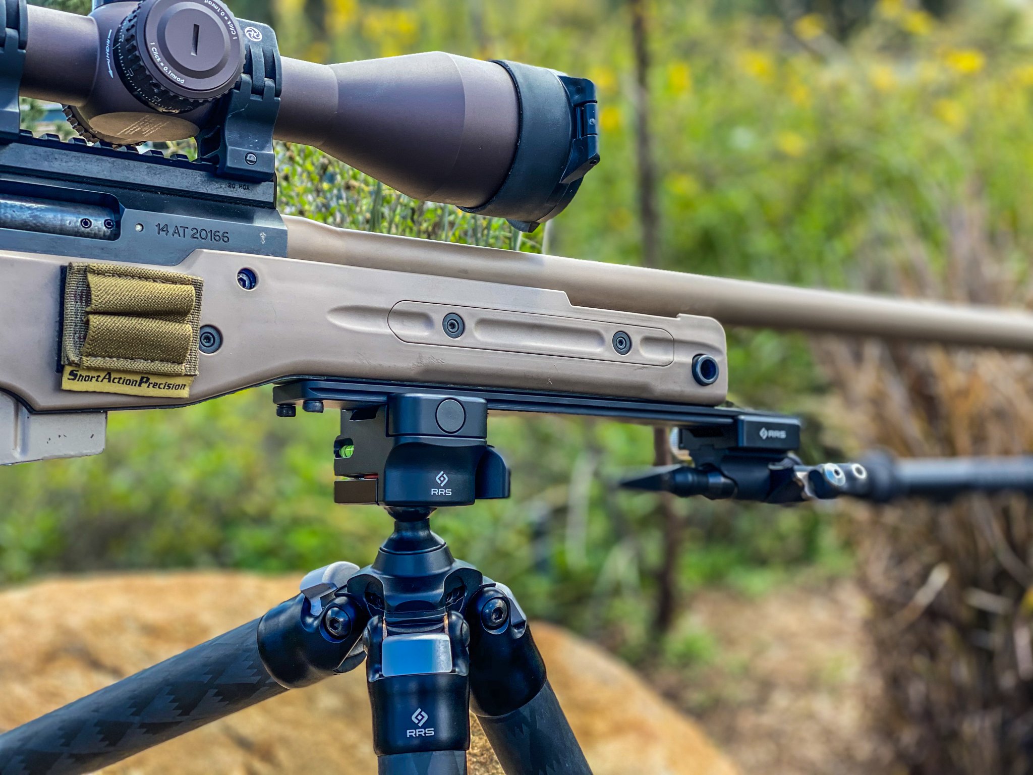

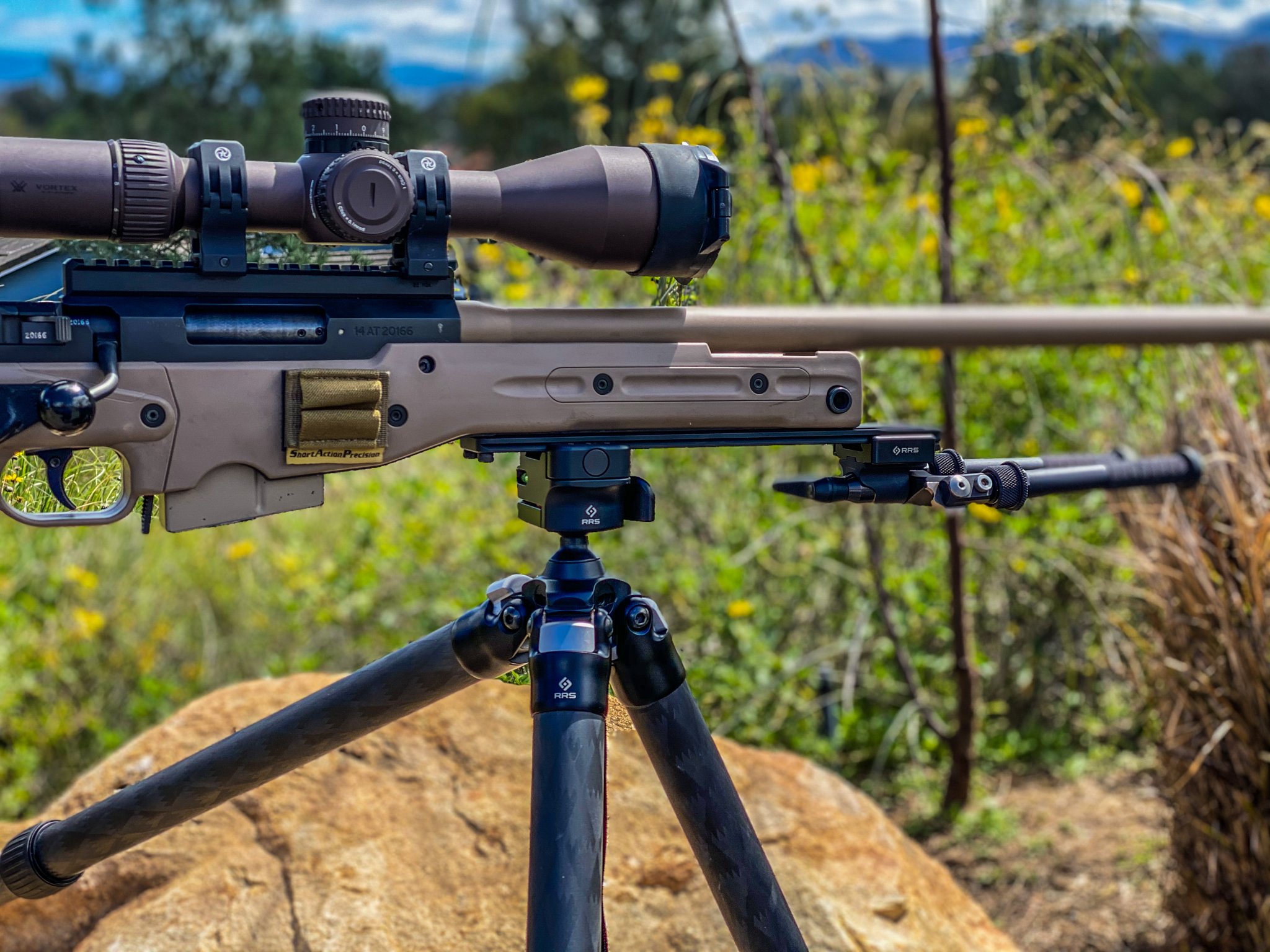

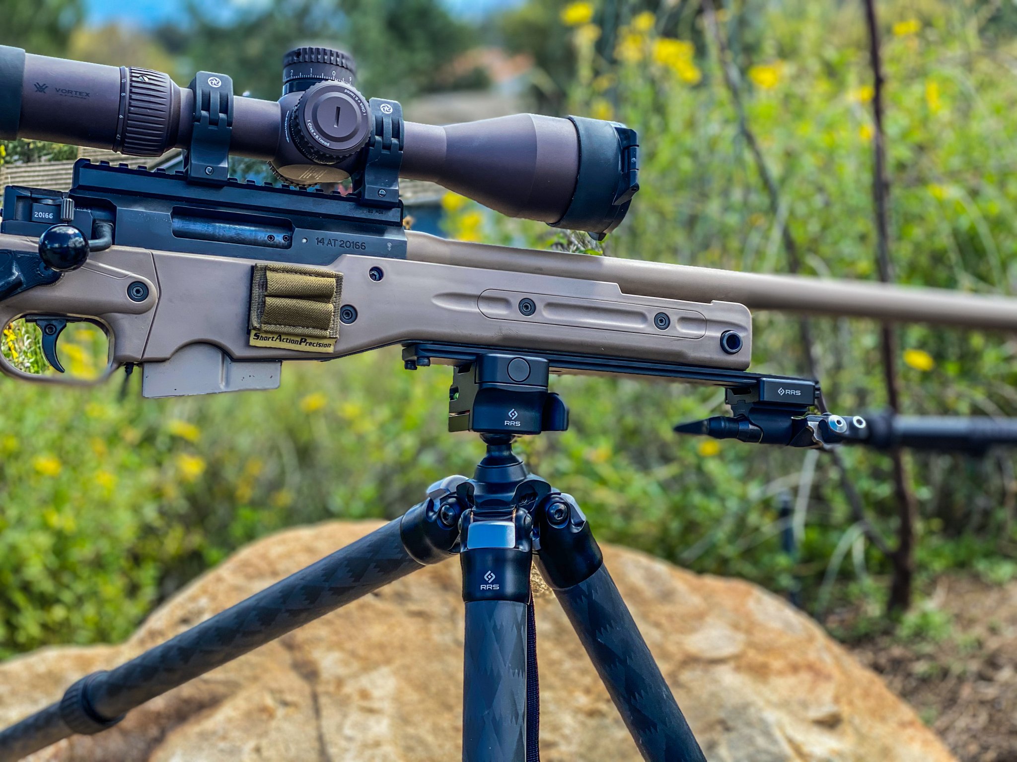

    Here’s a pic of the RRS + Arca spigot (not my rifle) for reference.
    Reactions: Glassaholic

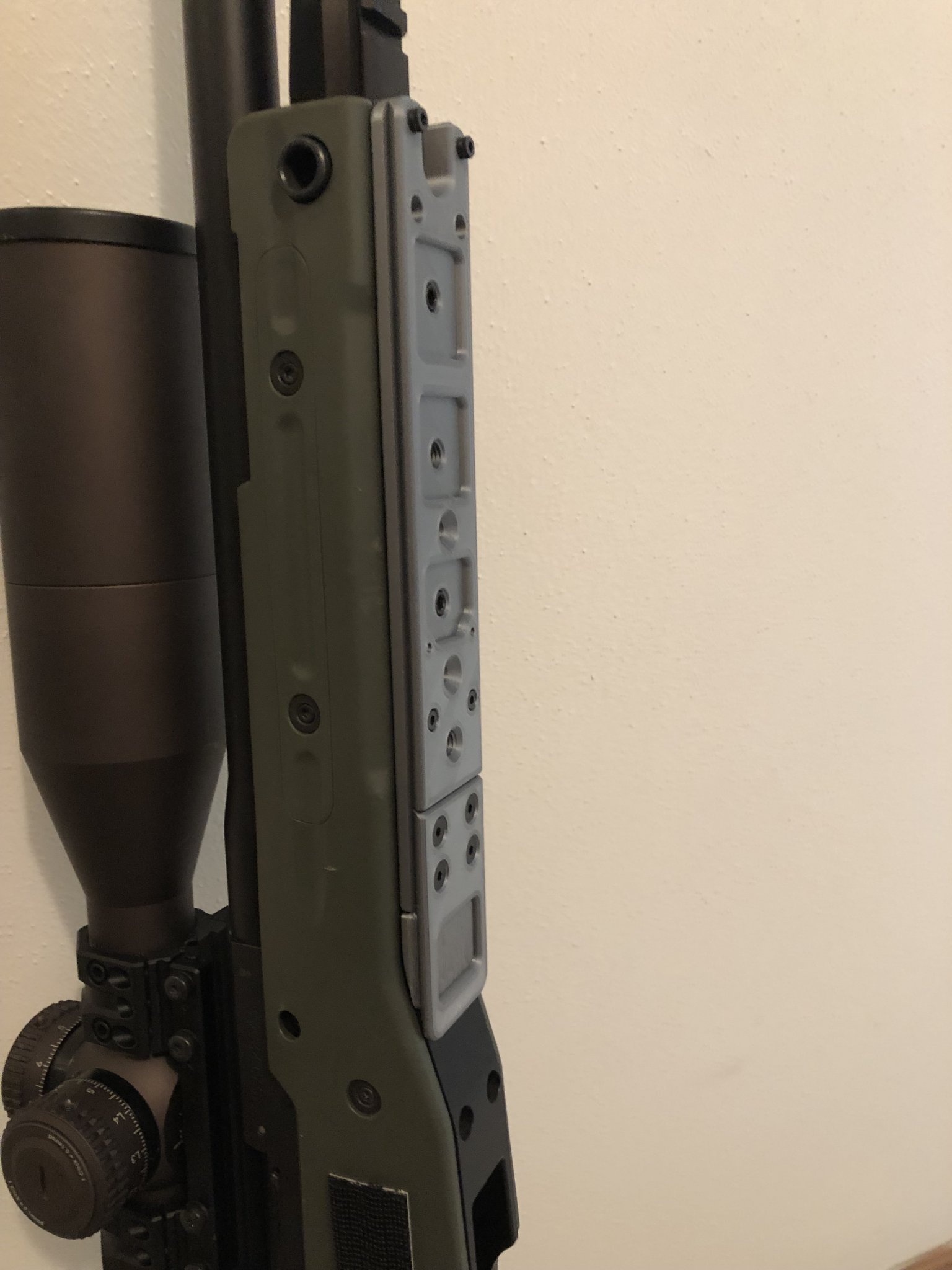

    I just heard from Anarchy and it sounds like the 2-piece AT Arca rail is now a go. It was tabled for a while but is back on. This is a unique design that sits nice and flush with the angled section in front of the magwell, and you can add an optional 1# internal weight behind the spigot mount which attaches via the rail. I don’t have any details on price or availability though.
    That looks nice, maybe even better than the RRS. But I'm sure I won't have an issue selling the RRS if I like this better once available (y)
    Reactions: MarinePMI

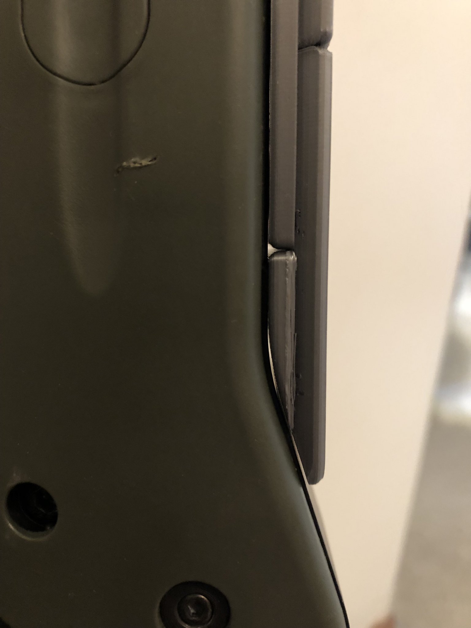

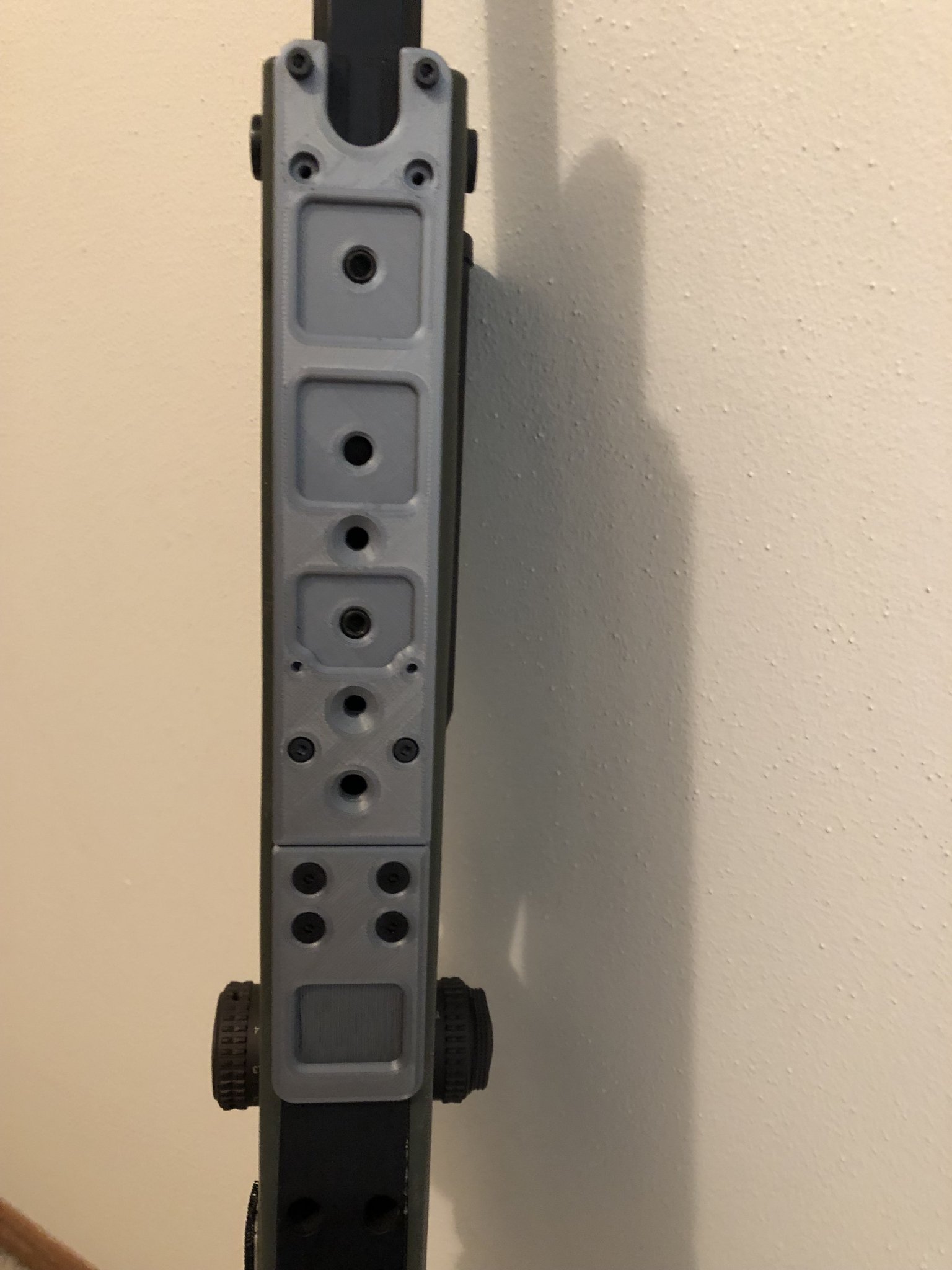

    View attachment 7276039View attachment 7276040View attachment 7276041View attachment 7276043

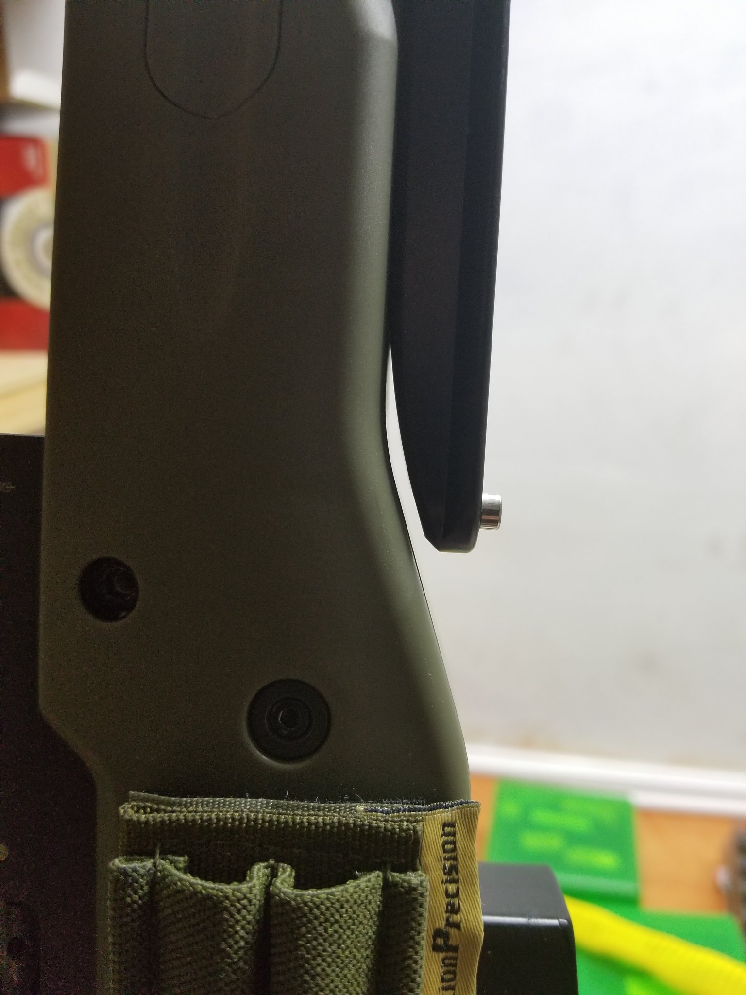

    This might solve the only issue I have with he RRS Rail. The gap!!
    Reactions: samb300
    Sam, I assume you will be notifying us with a thread when these are available for sale?

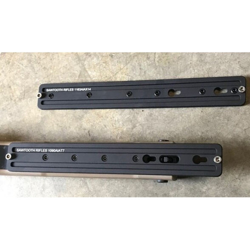

    I have a newer (updated) Sawtooth ARCA rail for the AT, which is substantially more rigid, with only a minor increase in thickness. Once the range opens back up (Corona virus crap), I'll check vertical dispersion. I suspect it will be gone. As an aside, it retains the same footprint as the gen 1 version, but also supports a pic rail on the front end (if desired).
    So, just to update this thread...
    This is the one they show on their website right now is that correct? It is still the version that overhangs the front, or is this a new version that does not overhang?
    It still overhangs the front. Not sure if this is the one on the site or not.

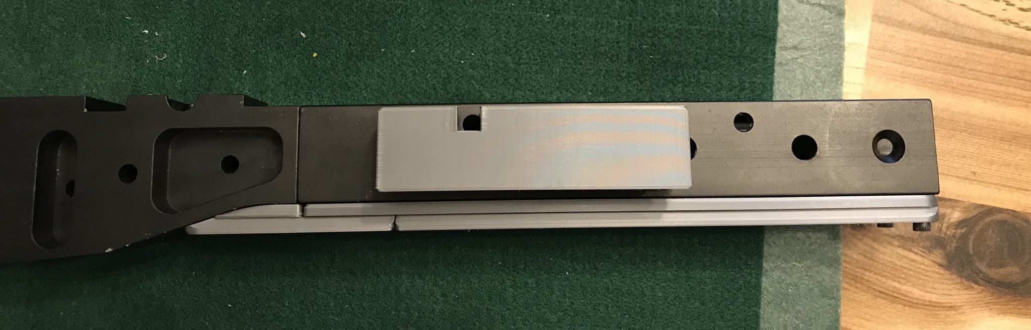

    This is what I have as far as pics go. If you can show detailed pics of the bottom with key slot and new placement of stop screws to work better with RRS dual pic rail/ dovetail mounts, that will be great. Its def a thicker more rigid rail than the older model to help with the “flex” at the front end.
