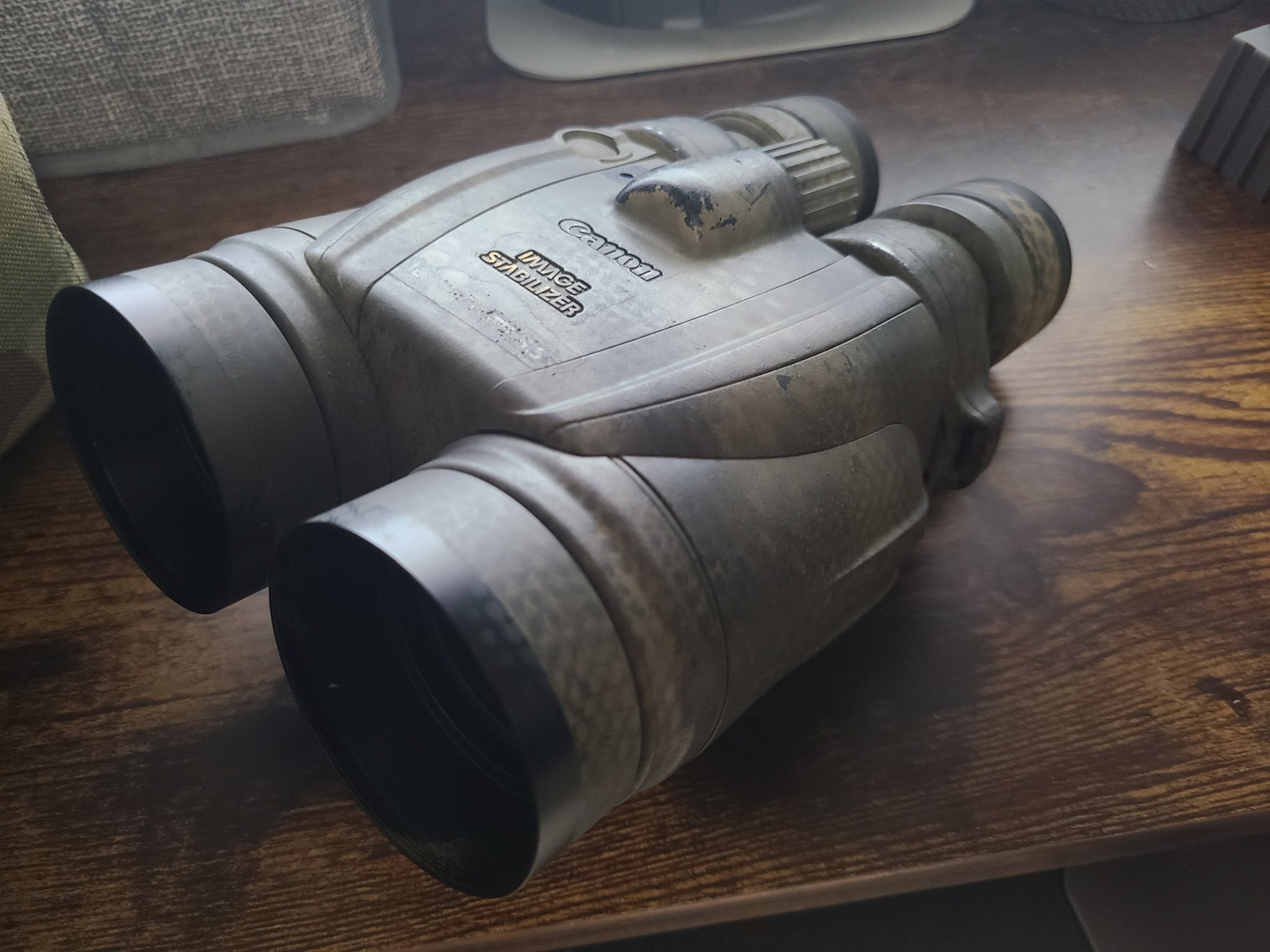

I have had the 10x42 L for about a year now and they are my go to!
The 10x are the only L glass variant so can not attest to the other models but they are as good if not better than my steiners plus they have IS so it is a no brainer! Wish they would make an L variant of the 15x.
