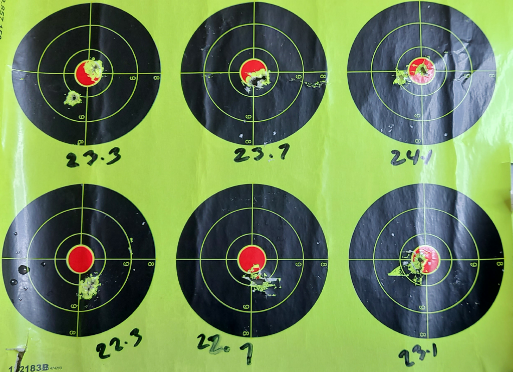

    So I grabbed some MP450, 2 shot group tests in a 26" Criterion 223 match chamber 700 rifle.
    It was POURING rain today so not really a good day for any serious testing but I simply wanted to get a feel
    for the velocity numbers this powder would produce.
    I shot a control load 77 SMK 2.255 Coal, 23.0 8208 XBR that produced 2835 FPS.
    No pressure signs at all and accuracy looks promising concidering the amount of bullet jump for this rifles chamber.
    68gr Hornady BTHP coal 2.255
    23.3 2769 FPS
    23.7 2814 FPS
    24.1 2873 FPS
    24.5 2942 FPS
    77 SMK coal 2.255
    22.3 2642 FPS
    22.7 2654 FPS
    23.1 2700 FPS
    23.5 2743 FPS
    So what do you think? Worth buying?
    Accuracy was very good in my bolt gun, although that particular rifle shoots most everything well. Now that I have some data I will test it in a gasser and see what it will do.
