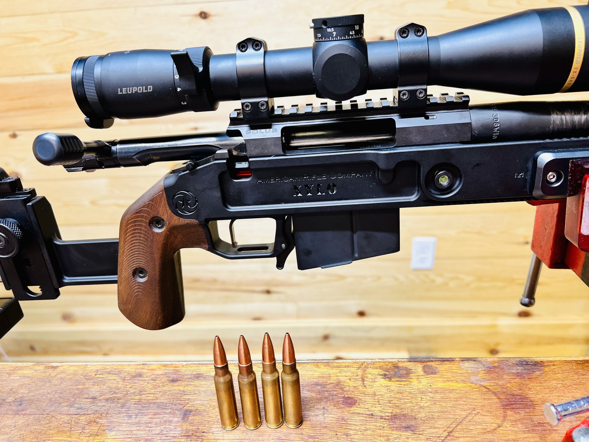

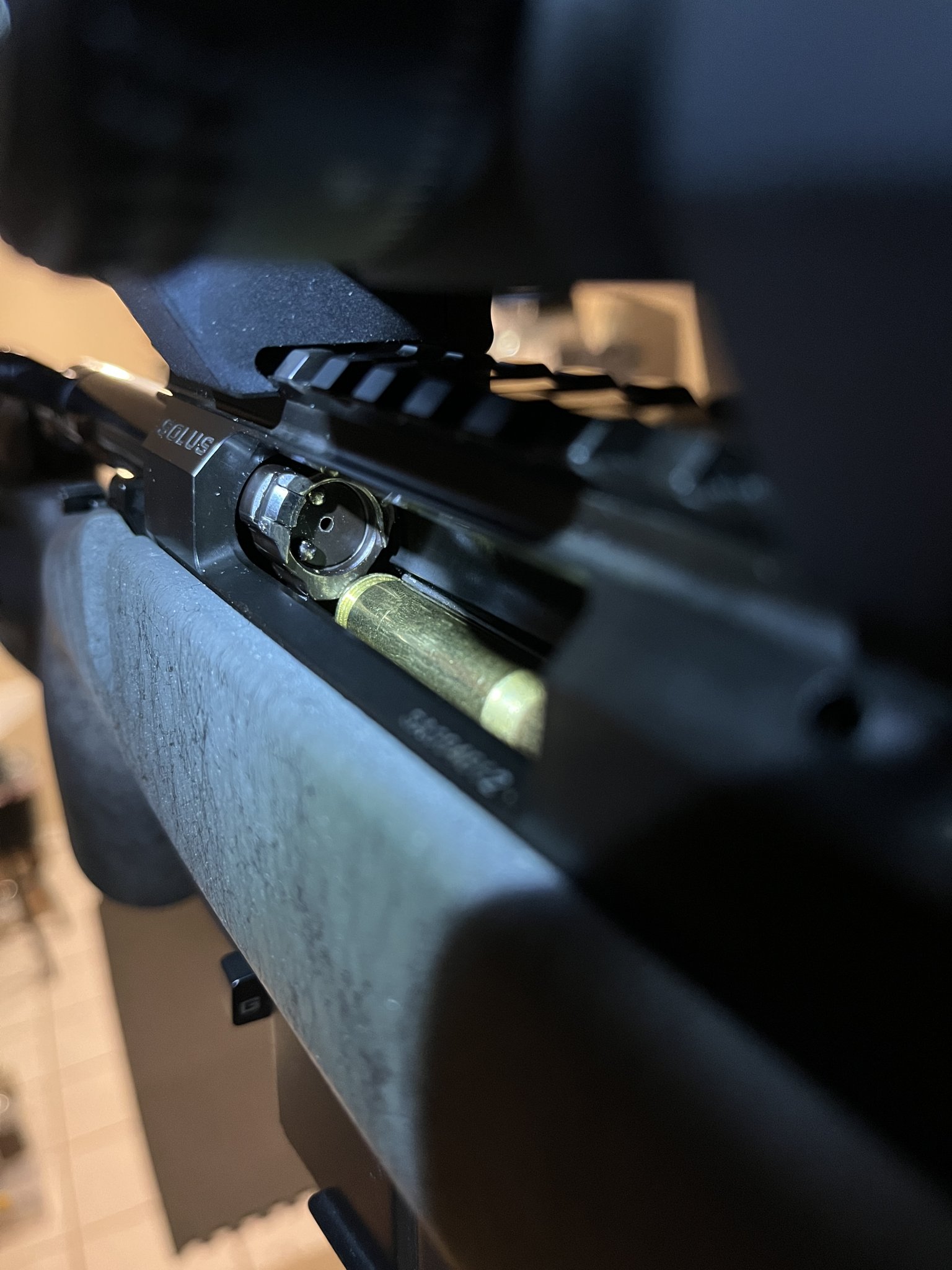

Just curious if anyone is using a Solus action with AW mags as I haven't seen it mentioned yet? Wondering how they are working and what your stock/chassis configuration is?

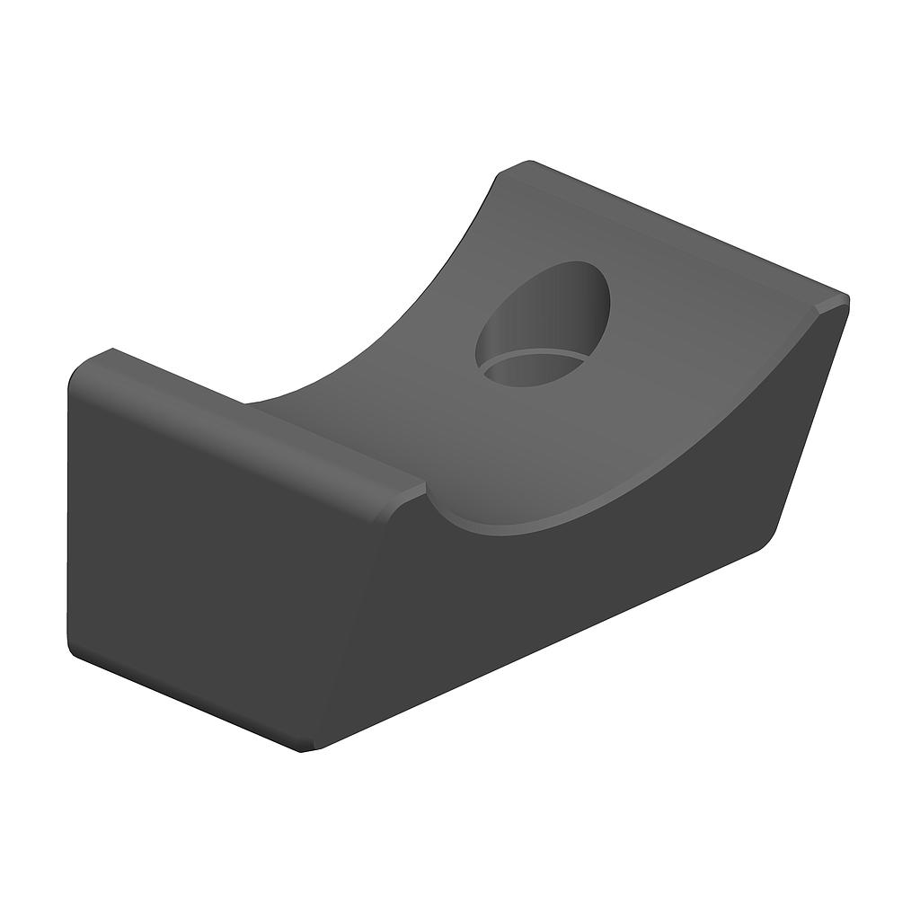

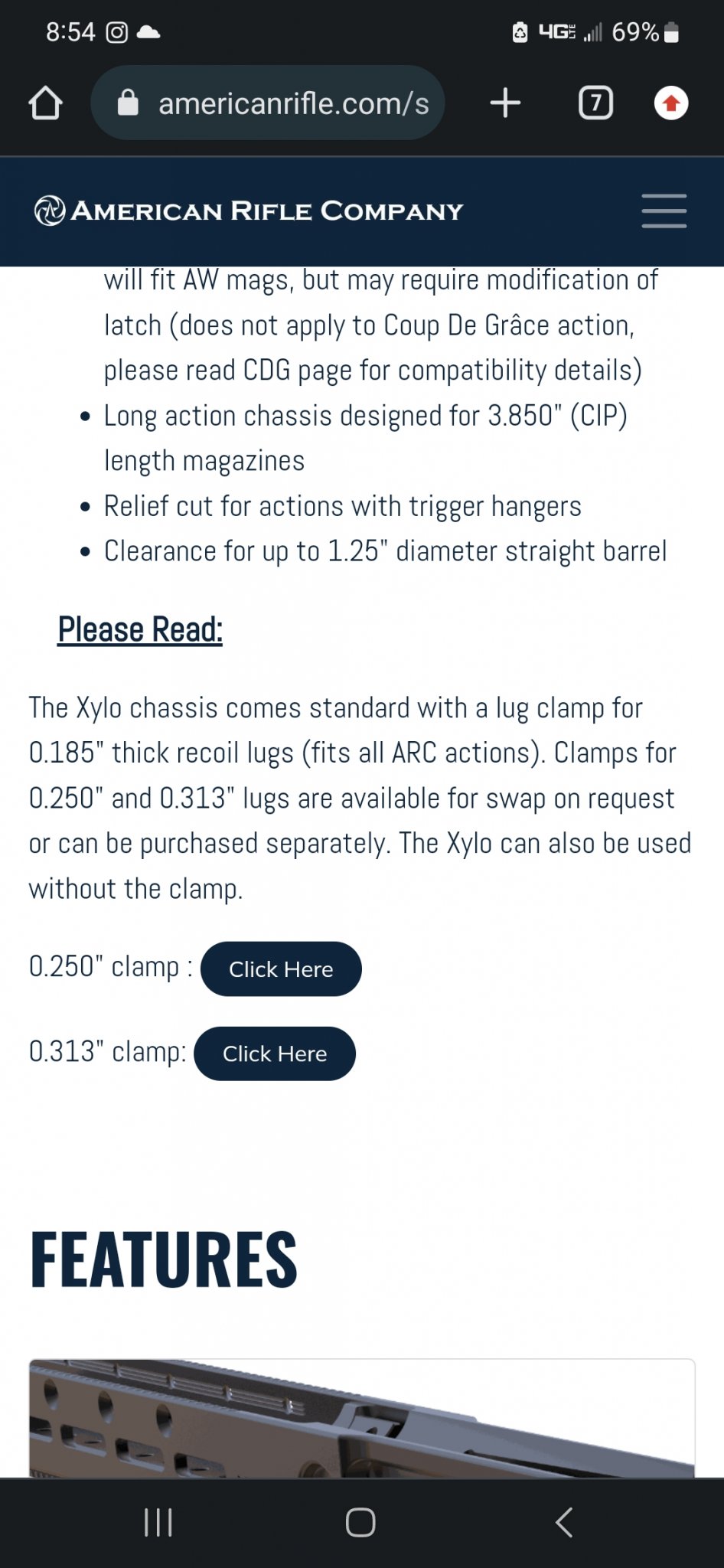

Well, if you want to roll the Solus in the Xylo you can’t use the recoil lug clamp. The clamp I think is what makes a Xylo based rig so fucken precise!What makes me think ARC makes these Solus actions for Aero?
You can get multiple sized wedge blocks for the lug clamp from ARC. I have had multiple actions locked in of various lug thickness.Well, if you want to roll the Solus in the Xylo you can’t use the recoil lug clamp. The clamp I think is what makes a Xylo based rig so fucken precise!
None come thinner than .185 stock I see on the site.You can get multiple sized wedge blocks for the lug clamp from ARC. I have had multiple actions locked in of various lug thickness.
The number associated with the ARC lug clamp, is referring to the thickness of your lug. I'd think the solus has a 250 lug, as it's become the norm."Lug thickness" so the thicker the lug, the thinner the clamp. I see. Thanks
So the Aero lug would need a .250 clamp I should think.
