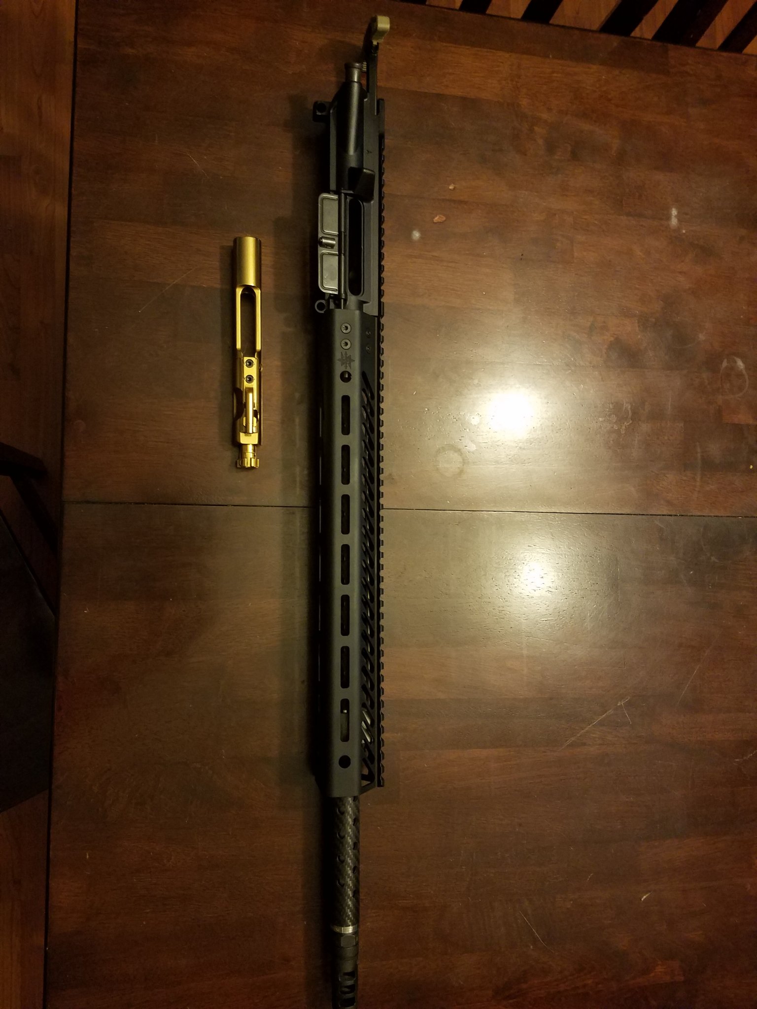

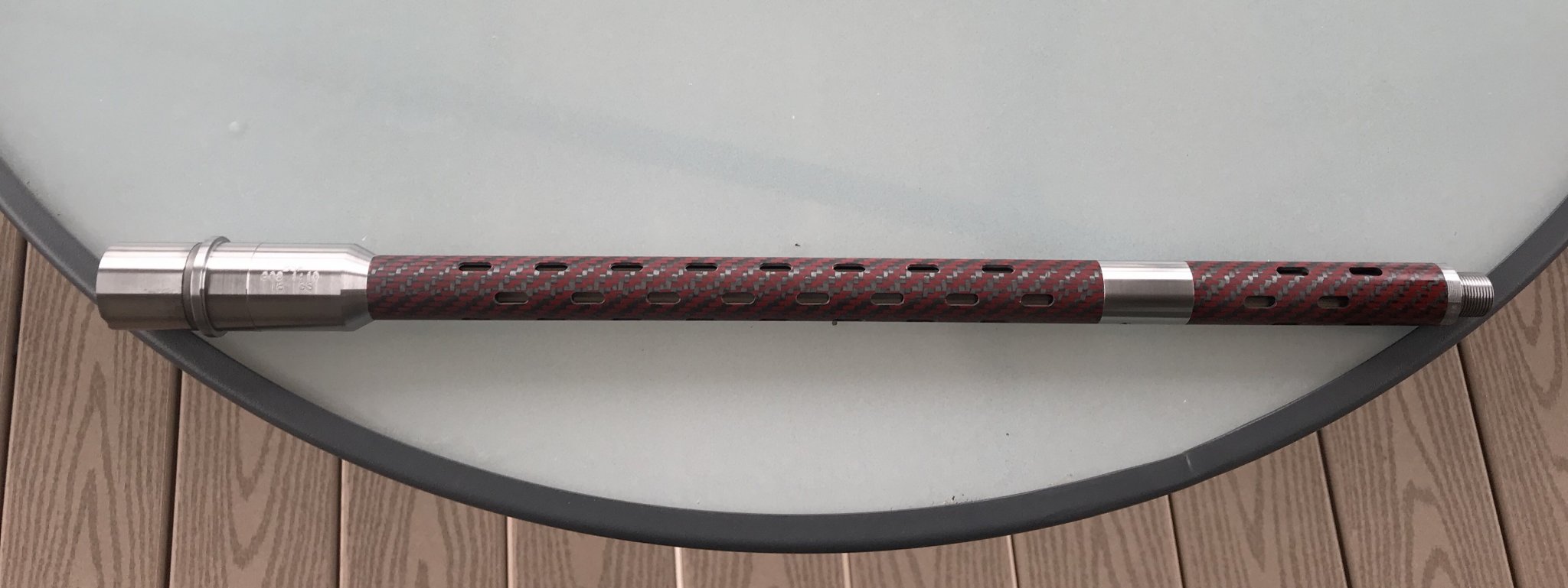

So, this is the barrel I have. As you can see from the first image, the gas block journal is massive. And that's a 15 inch rail on the upper in the second image.
Reactions: Str8shot and rcnut
