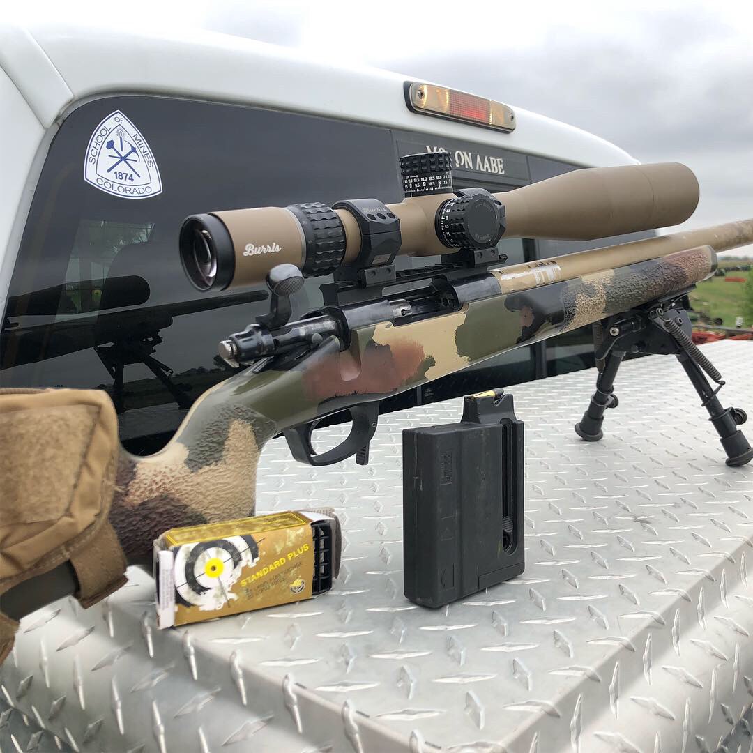

lOVE them esp with rimfire. Being ablt to max out the scope for those long shots was a big deal. I want to be able to dial 300 yards at least so with my 40x, I have a 20 moa base and another 10 moa in the rings and im able to dial to 400 now.
GL
DT
