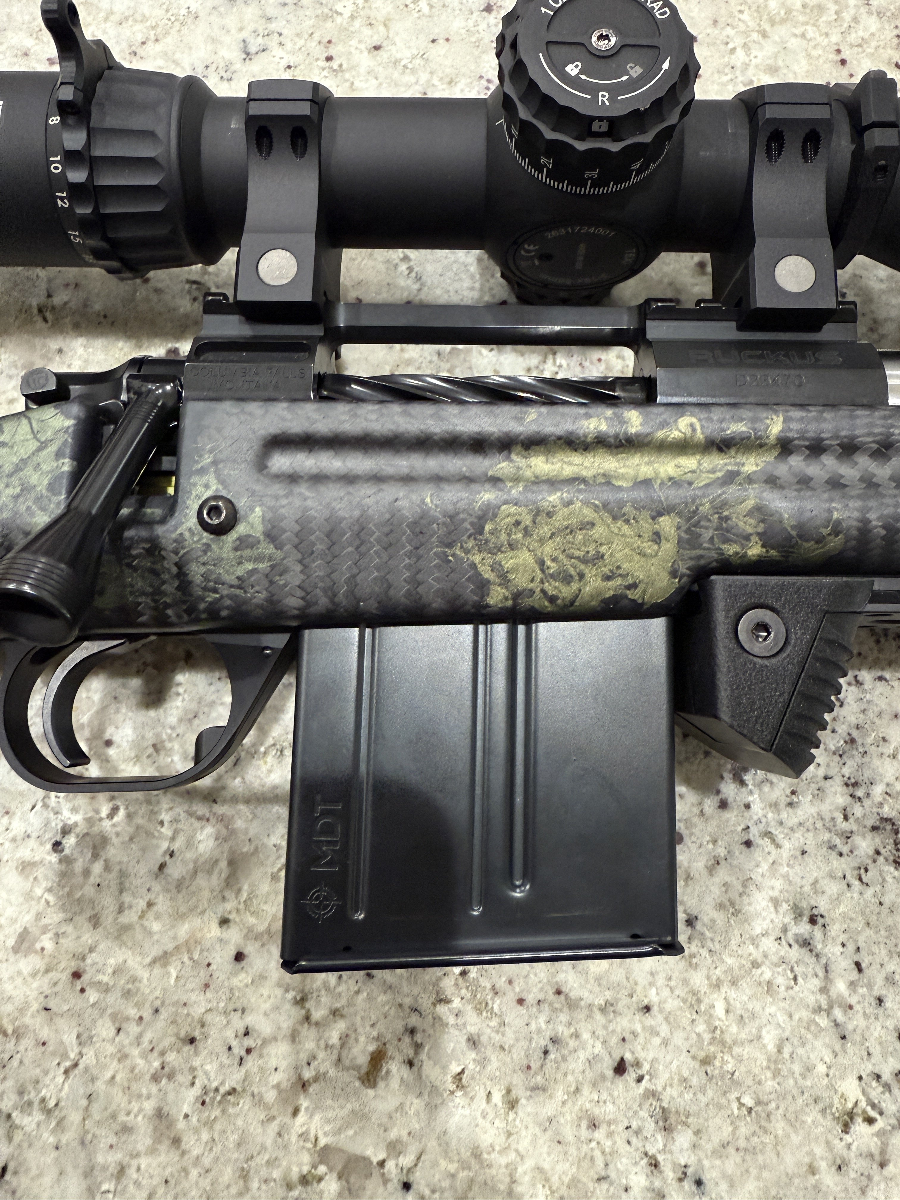

No problem with the MDT metal mags. I also have the MDT polymer magazine and it is definitely a tighter fit than the metal mag.
