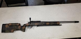

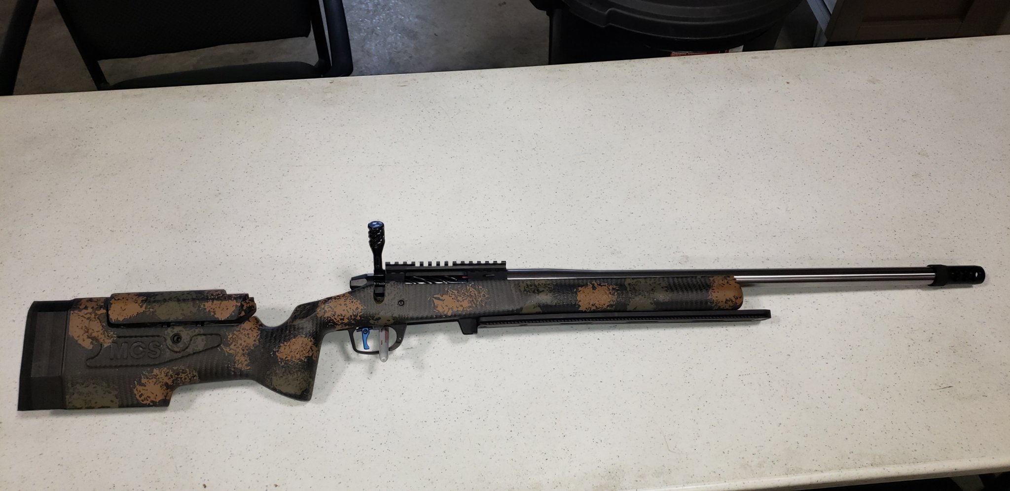

I've got one but it's down by Manners for the fitting to a stock. For my son and will be in 6GT.
Overall quality....I can't pick it apart at all. Standard Remmy threads so if you wanted to do a Remage drop in set up I don't know why you couldn't.

It's put together. Caliber is 6GT.
As a note to everyone...if you run this action in a Manners chassis stock and similar...you need to put a little bedding in the recoil lug area. The lug on the receiver the way it is machined is a tad different.

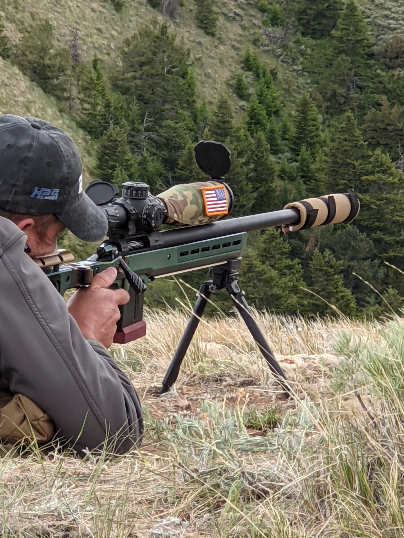

I've been using the Falkor 7even action for a short while already this year. One match with it, another coming up in a week.
Nothing negative or any criticism of the action yet. It's smooth, fit great in the Magpul Pro 700 chassis, and no issues with accuracy.
It's a really nice action!

I did a heavy palma contour on his gun. Set it up like normal. Look at the picture.
For now it has a CG Extreme trigger in it.

The scope finally came for the rifle in early November (Razor GenII 3-18x). I put it on the gun and we shot it on Nov. 13th.
First time out we only put 14 rounds on it. Go easy on the barrel and put a good zero on it. My kid did all the trigger work and scope adjusting. I told what to make for adjustments. At 117 yards the thing just shot small dots!
I gave him the dope for the 400+ yard target. I told him just to watch the wind flag and let him pull the trigger on the next 3 rounds. He shot a .334MOA group with the rifle at over 400 yards.
Then the next weekend deer hunting started and now Christmas.
I'll say it's a hammer and good to go!
