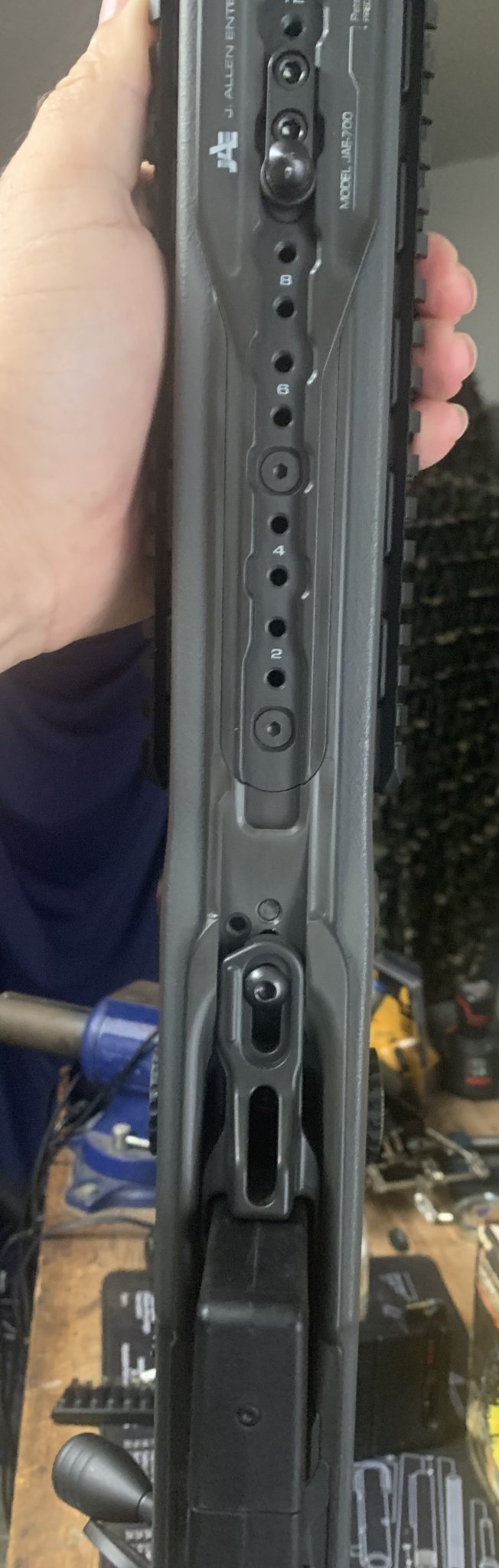

Have an original JAE 700 chassis and looking for the best way to protect my magazine from getting jammed againt shooting bag causing misfeeds, they make a barricade stop but for the newer version JAE chassis from MDT, but nothing for the original ones. Any help or suggestions would be appreciated. Thanks

I’ve got an OG jae as well. Unfortunately nothing out at the moment. There’s some stuff being tested but not sure if it’ll ever even come to market due to lack of interest and lack of use in the JAE chassis.
Best recommendation is probably the gray ops arca barricade stop. Other than that something homemade.
Send it in for warranty refund. It has a design flaw.
Buy a Foundation or a Matrix or an ACC and sell that thing to some other unsuspecting newb.

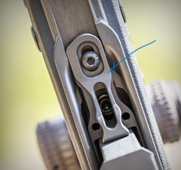

Adjust that thing in the picture (is that some kind of magazine tension clamp) to keep the jam from happening.
Bolt, tape, glue, or weld something to the chassis immediately ahead of your magazine.
Thread a bolt into hole number two (there’s a joke there) that sticks out far enough to keep you from going any farther forward.
But seriously. Sell it and get a piece of equipment that is designed for what you are trying to do.
Have you messed with the collet fitment (forward and back) on the magazine? I used a JAE back in 2018 is and never had much of a problem with mags feeding.
You can also put an arca rail on it and then get a Gray Ops bag stop.
Reactions: kthomas
Also, I just remembered.....there was a thinner collet that was offered by JAE for vudoo mags (looks like vudoo mag in your pic). But I believe they wouldn't fit without it. So if your mag fits, it's probably the right collet.
I'm sure I probably tweaked the mag fitment. So you'll likely need to. But I never had any issues with feeding in mine. In the pic below, I'm loaded into back fairly well. This was a Vudoo gen 1.

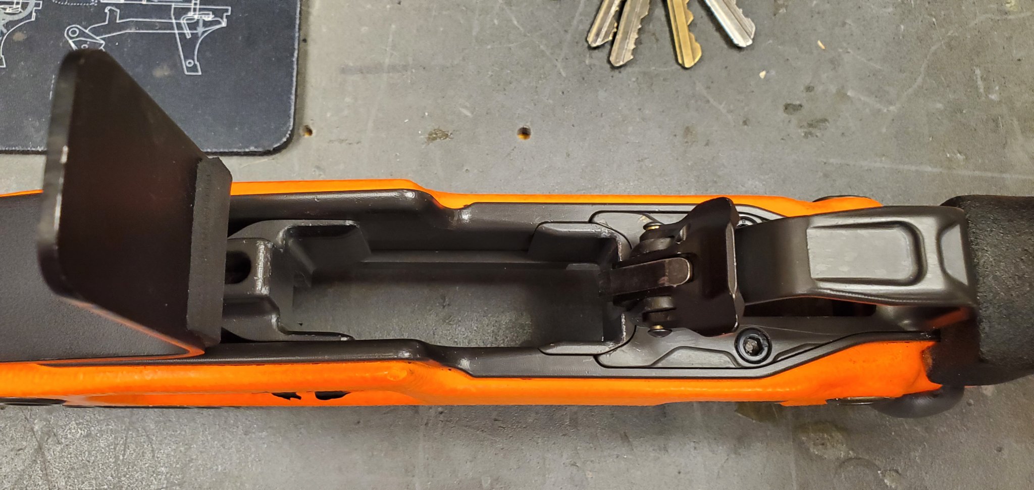

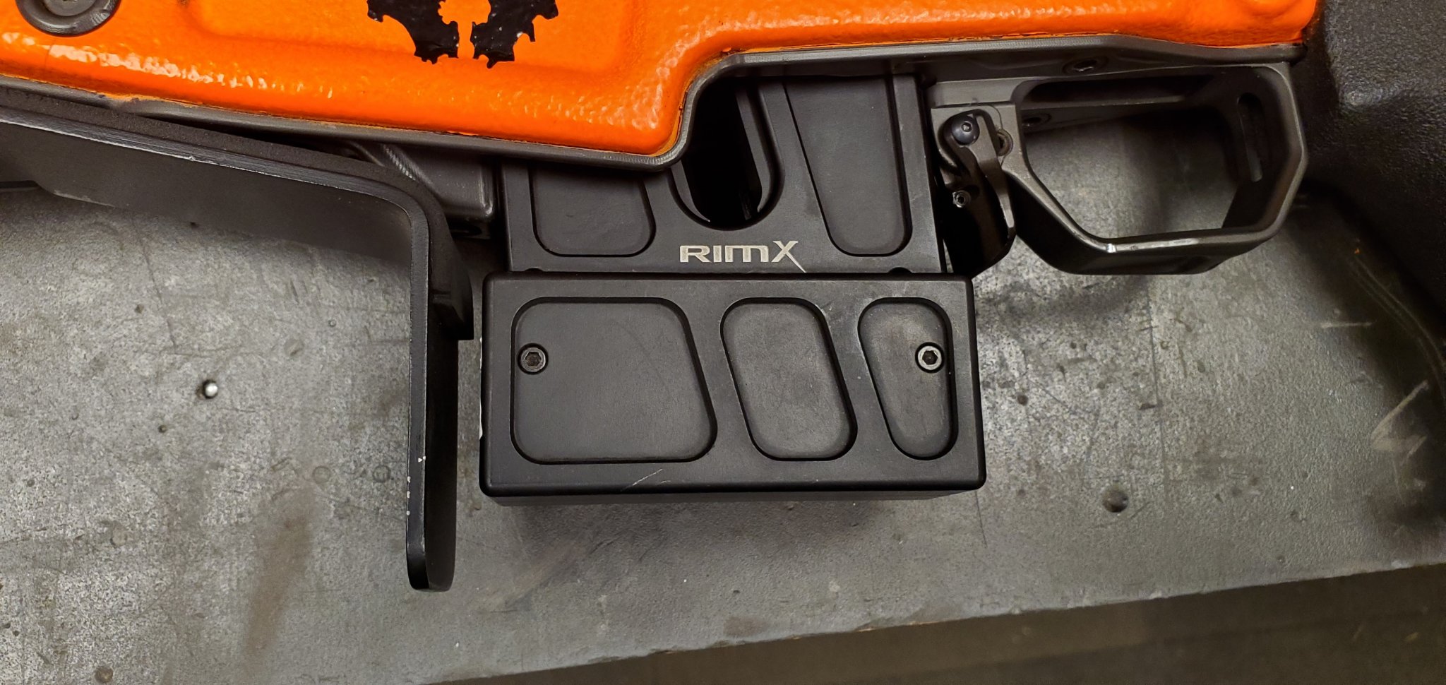

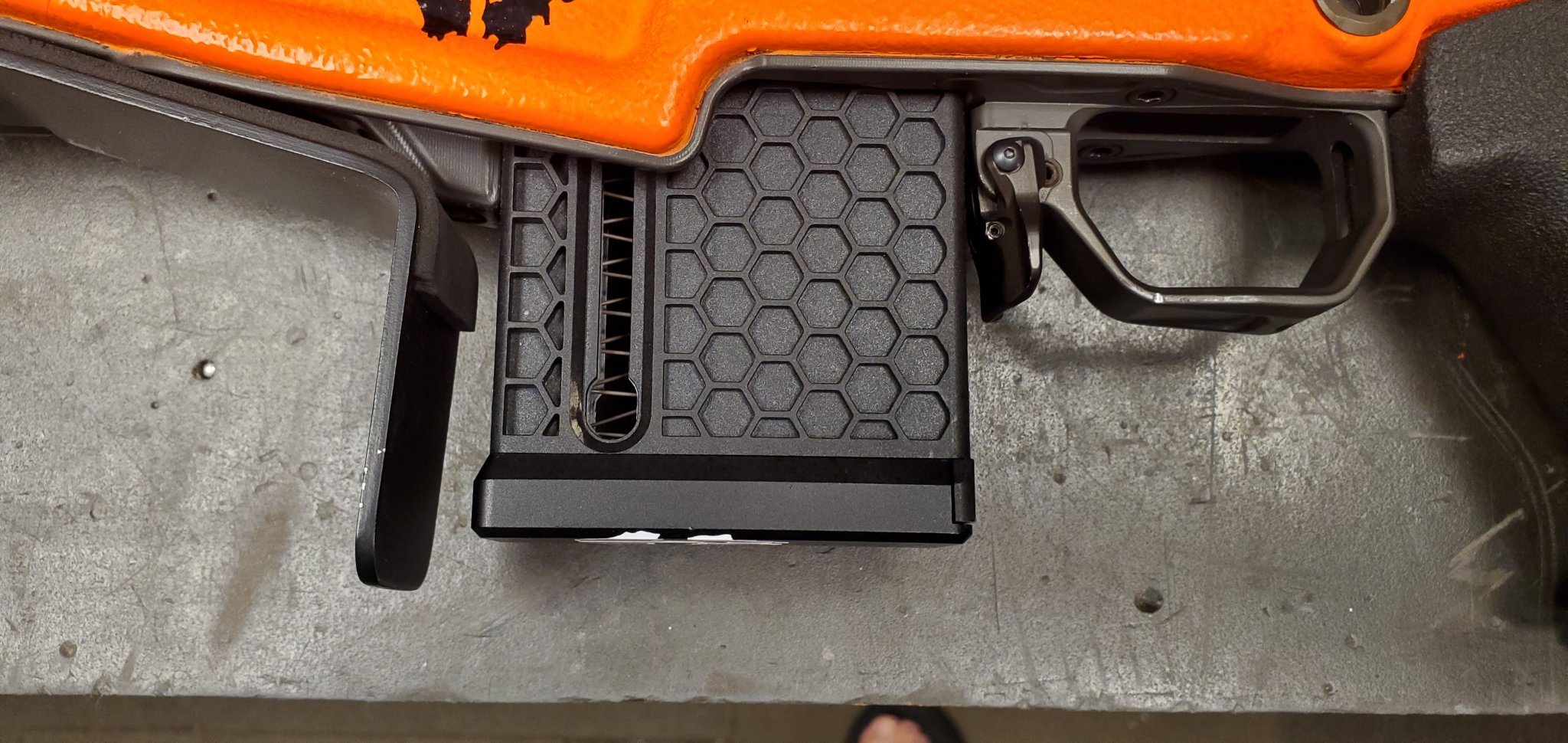

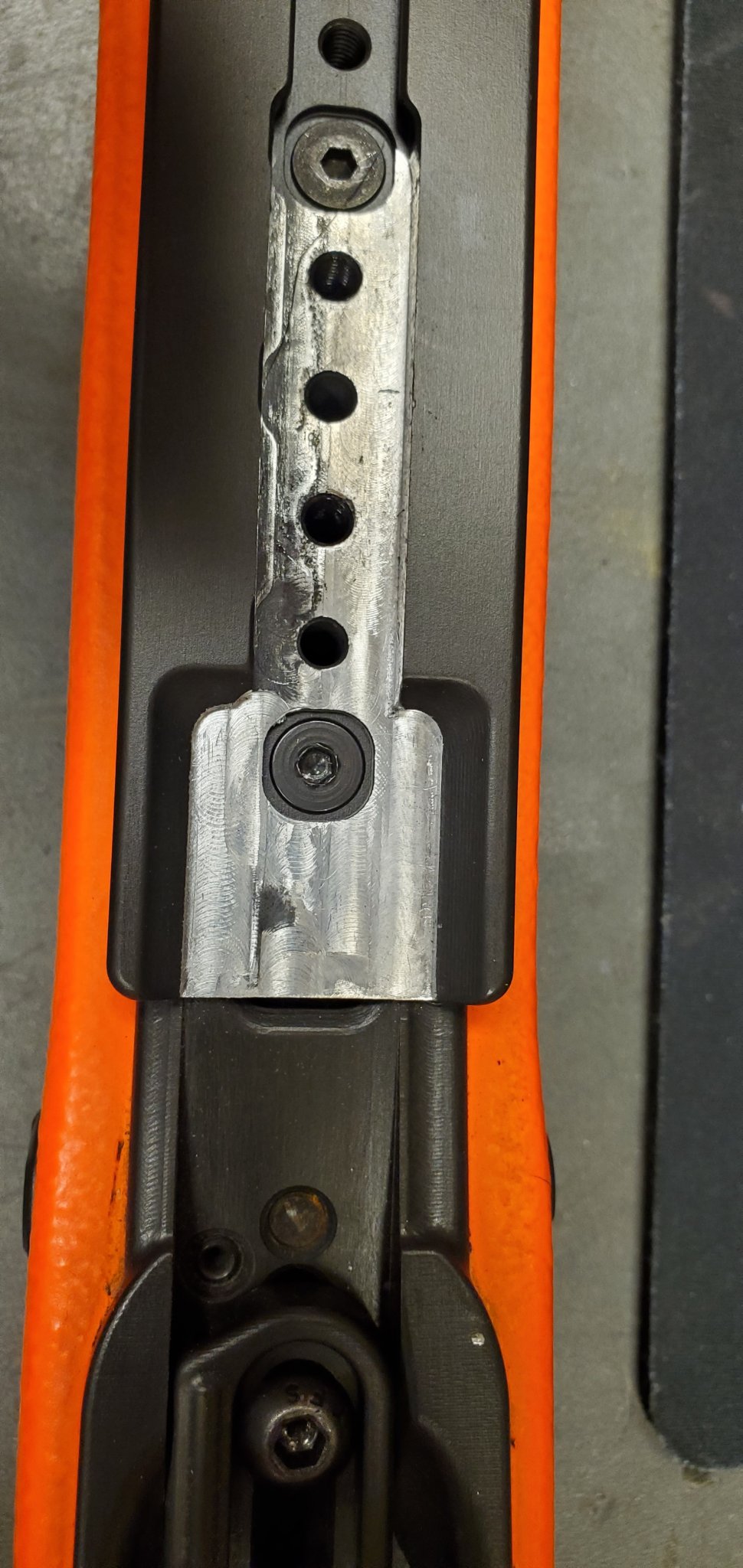

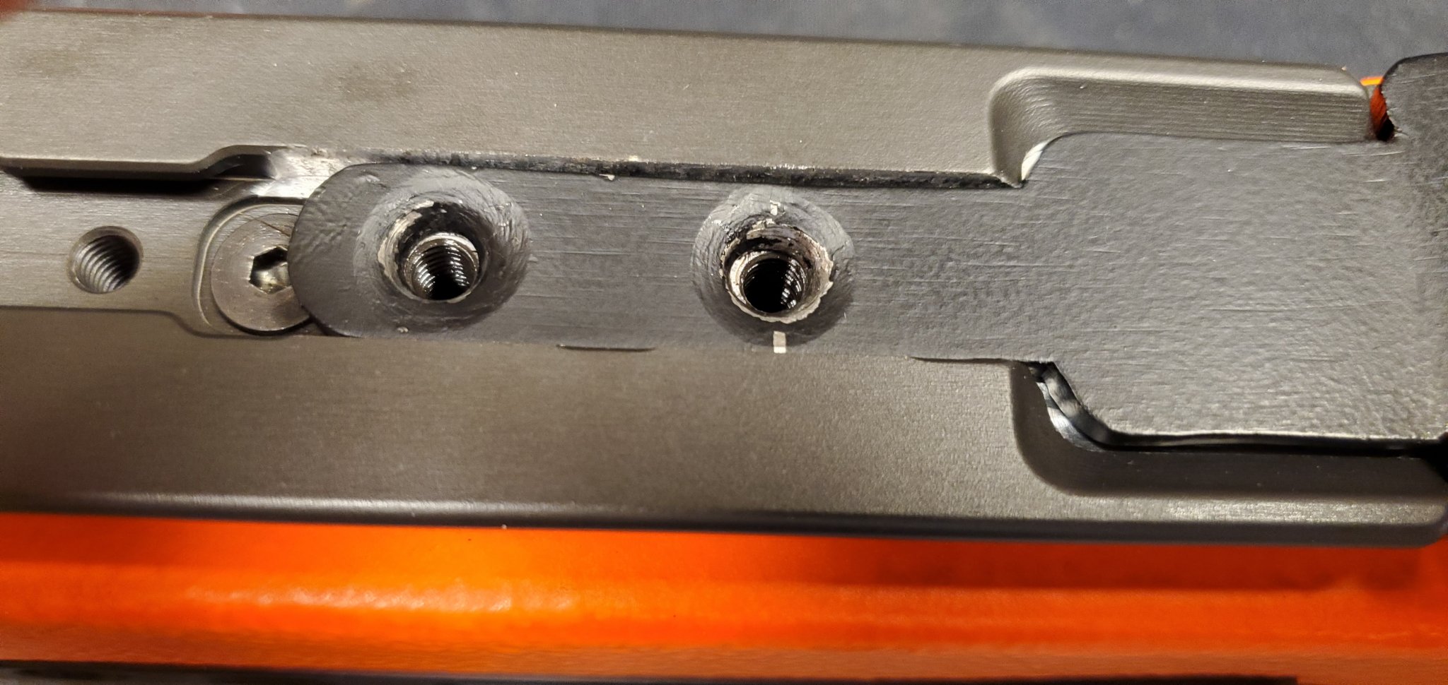

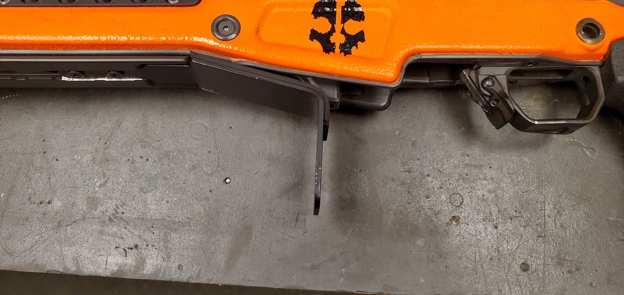

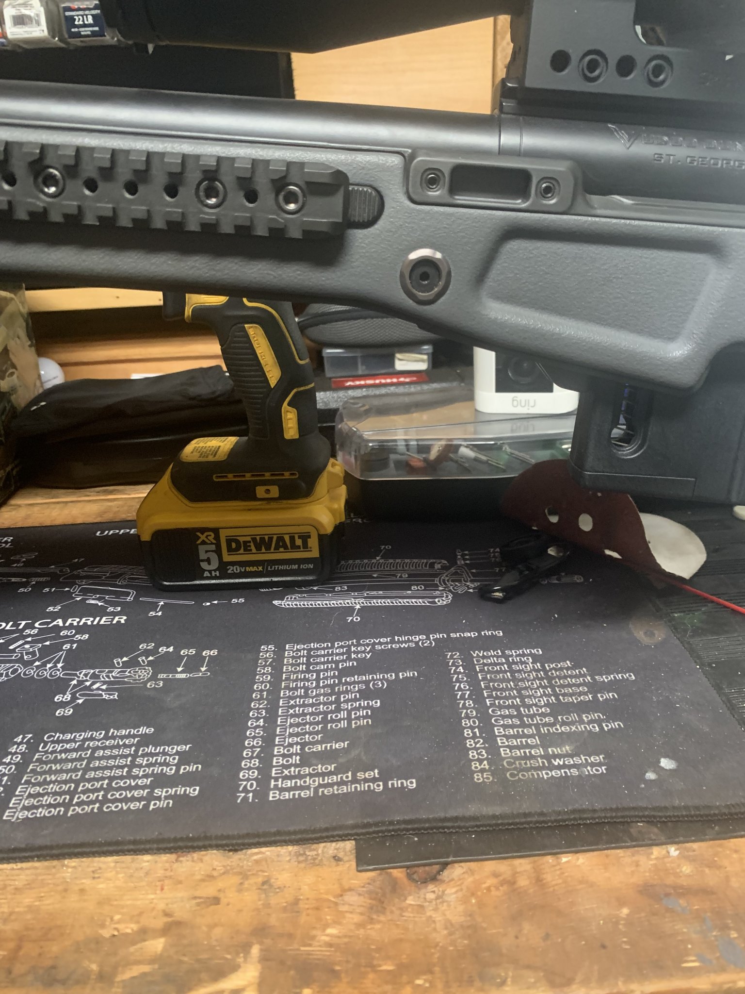

This is an OG JAE. I built my own mag block. Works with what ever action or mag I want to use. I also have full use of the arca rail.
View attachment 8364714View attachment 8364715View attachment 8364716View attachment 8364717View attachment 8364718View attachment 8364719

Seen anything similar to yours thats been mounted to an arca clamp?
Gray Ops seems like it doesn’t get all the way back to the mag.
Thanks either way! Yours looks great
