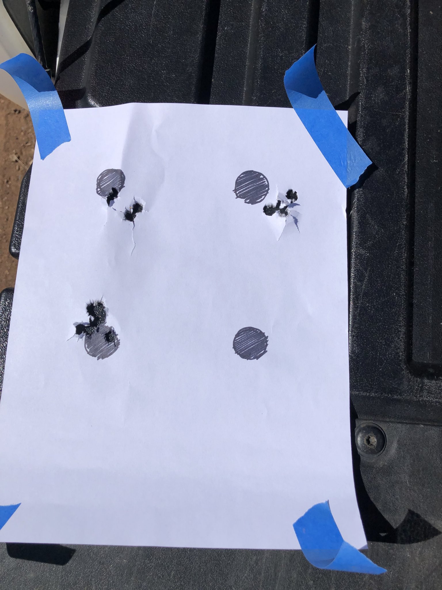

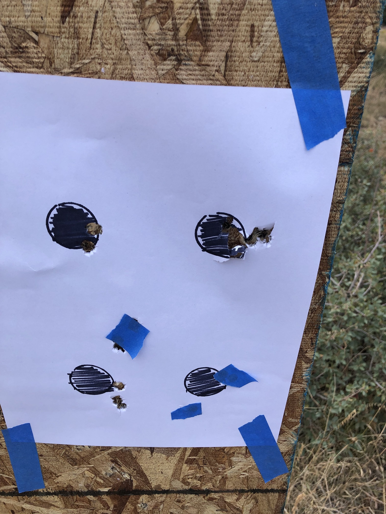

    Just a little update I tried it with some 175gr Federal and test loads 169smk win brass 2.82. The top right was the federal, top left and bottom are the varget. The best varget one was 42.5 which was two in the same hole and one low. So next I'm going to try different primers as these were winchesters. The dots are roughly an inch:

    I get bugholes with 175 SMK's and 43.8 and 44.2 grains of Varget in my TRG.
