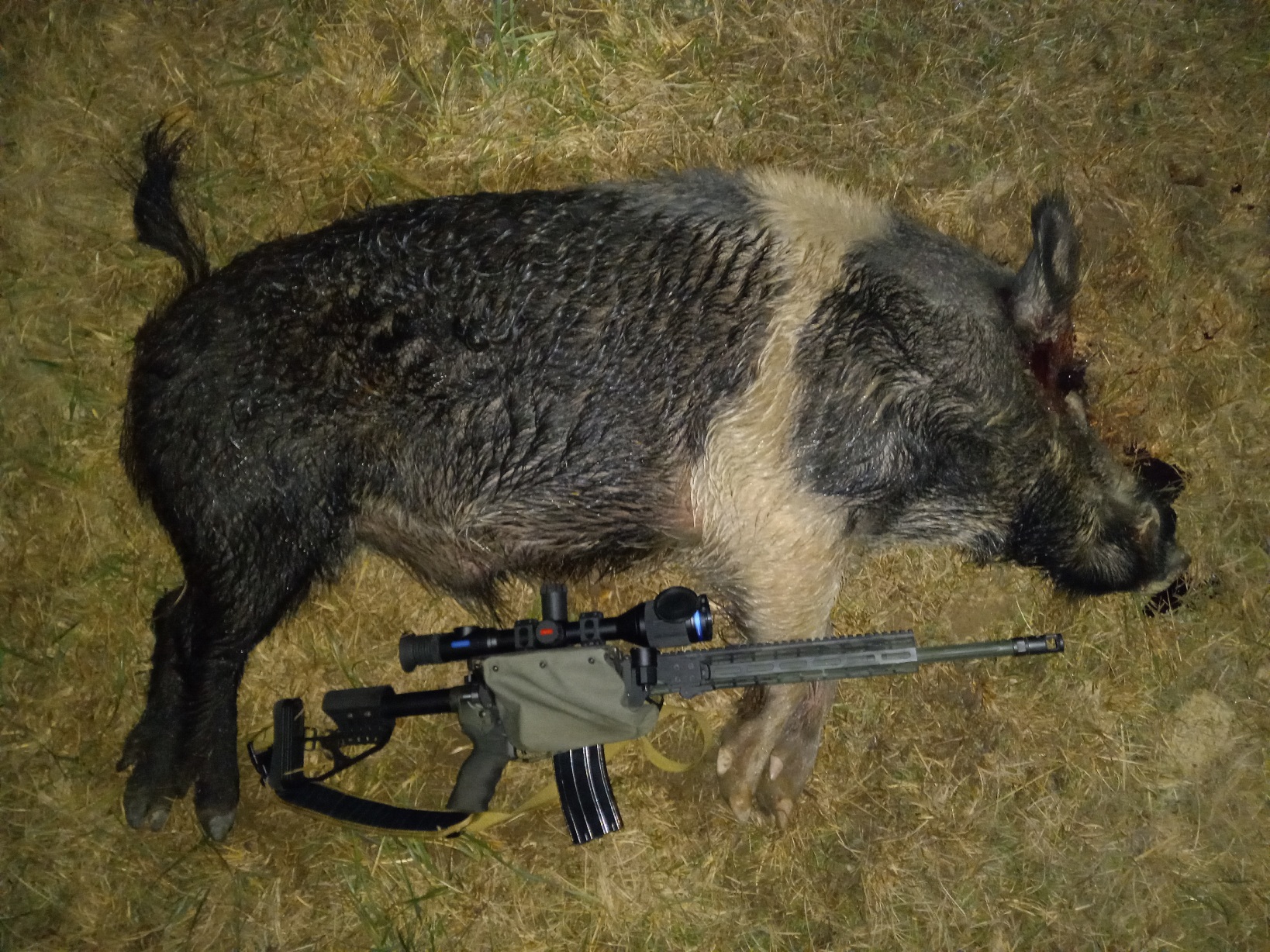

I run a XLR TR-2 stock on my 20" Grendel. It utilizes a carbine length buffer, spring and tube (it is not a 6 position tube however). Don't quote me, but IIRC my buffer is an H2. I have a non-adjustable gas block, and ejection is perfect...maybe I just got lucky.
It is the easiest-to-swing pig rifle in my inventory, and runs great. You may need to adjust buffer weights or gas settings, but your proposed combo will certainly serve you well once you get everything dialed in.
