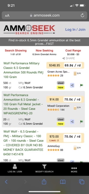

I've been using AmmoSeek as my ruler for ammo availability. 6.5G isn't cheap, but it's on there. I think there were only two options for sale for 6 ARC the last time I looked.

With the shutdown of russian imports, is wolf even available anymore?
How often do you search ammoseek?

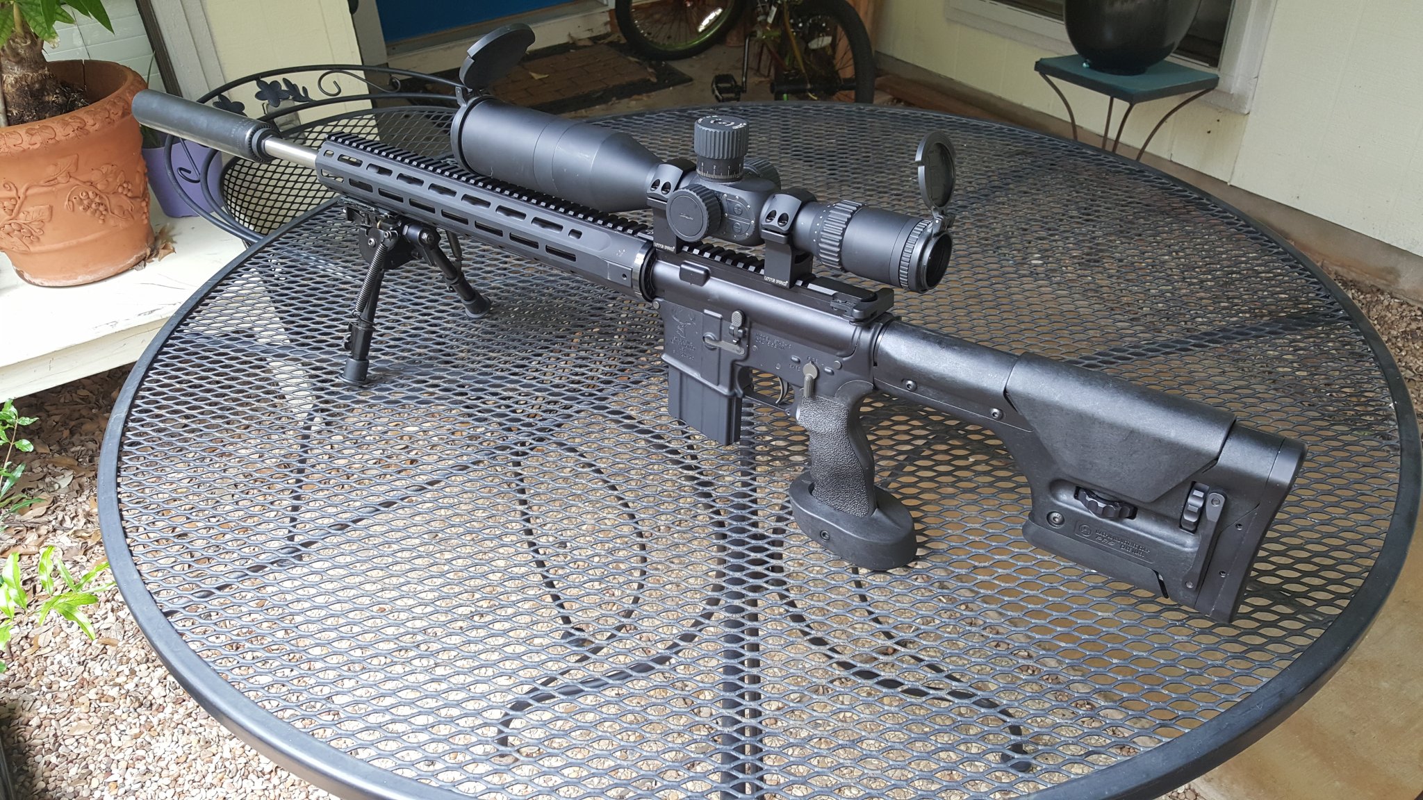

You wont regret a grendel. I've shot them for nearly 20 years and have had great luck with them.
Just get a good bbl and type2 bolt and good mags. I recommend Amend2 or Elander and stay away from ACS mags.
I currently run a 20' sheepdog gun works 5r match grad bbl with an H3 buffer and a magy PRS stock with a JP trigger and PSG1 grip with a YHM can and Wilson adj gas system and have had people giggle shooting sub-MOA in relatively rapid fire at 500 and 750 yards on steel. I've actually pulled off 2.6" in the wind at 500 yards with factory 123 grn hornys.
Here's my girl.

I dont have a lot of experience with the 6mm ARC, but I think if you look at ammo availability, and bullets for hunting, the Grendel wins.
For example, at 400 yards, the gren is only about 2" under the ARC and it's still supersonic at 1K from a good bbl. He's also looking at 18", and not 22-24 where the ARC will really shine.
The ammo availability and luck I've had with factory-loaded ammo of the gren is why I love it.
Here's my girl.
