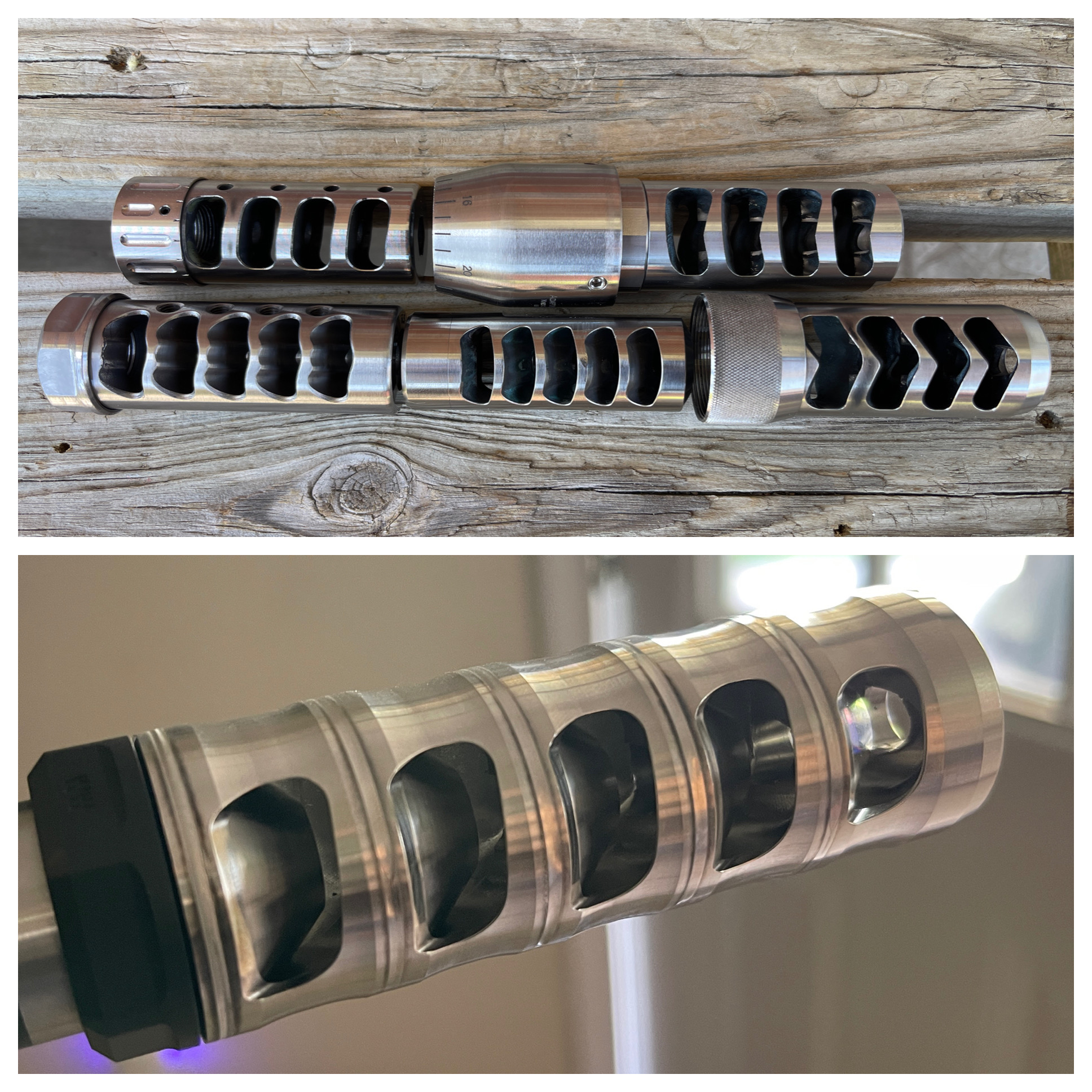

    Looks like APA has come out with their latest generation of brakes. Curious to see how they perform in comparison to the ACE and new Hawkins updraft brakes.

    Anyone got one of these yet? I went ahead and ordered one. Super curious the difference between it and the gen 3 in actuality. Also interested in the comparison with the ACE.

    Tested my Gen 4 Fat Bastard today with 6.5CM in a 14# rifle. I do not have experience with the previous gen but I do know what brake concussion feels like.
    I took off all the set screws to test and it did a good job with controlling muzzle rise and keeping the target in the FOV. Recovery is fast as expected.
    Now to concussion or lack thereof.. As the shooter I could still feel the thump but it was mild and tolerable. Standing off to the side about 7-8 feel away at 90 degrees and then in line with the angle of the ports the thump was noticeable but also mild to me. It’s going to vary person to person but I didn’t think it was obnoxious. I only wore ear muffs. I’ve been around much worse. Could I shoot this brake all day? Probably. Let me reiterate, yes I know people have different tolerances to concussion and noise.
    Well you can’t say I don’t have other brakes to compare it to. 🤣
    Ok, how does it compare to other brakes in terms of recoil reduction though?
    Of the ones I have, it’s not the best performing one. I know the Chad costs way more but I feel it does a better job all around. I mean it’s going to be hard to convince someone otherwise until they shoot it themselves or see numbers on a recoil sled with sensors. The Gen 4 does do a good job with muzzle rise but I feel it could be better impulse wise. This is all based on free recoiling with little shoulder input.

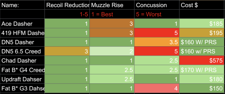

    I just got my G4 FB, mounted it up on my 23# 6.5 creed match rifle and I'm honestly impressed. I've shot the Gen 3 FB but concussion was horrible. This G4 isn't quite Ace or Hawkins Updraft good in terms of concussion but it's miles better than the MPA DN5 I was running on that rifle. Here's kinda my ratings. Note, alot of this is subjective and I haven't shot every one of the brakes on the same exact rifle.. A lot of these scored highly because of running them on dasher. For example ace wouldn't stack up that good in my opinion on creed but I dont presume many run an ace on a creed... Screenshot_20250331-192910.png
