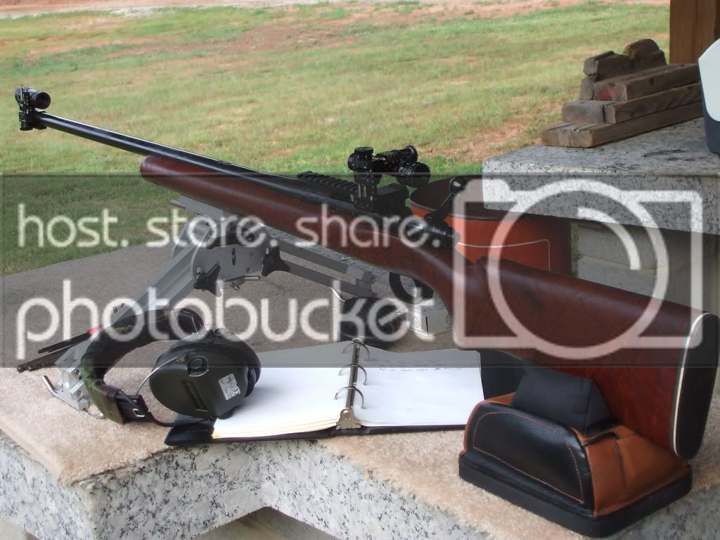

I enjoy shooting with aperture sights as much as I do scoped, so I was wondering if anyone has setup aperture sights on a Vudoo and how they accomplished it? Thinking about ordering a Vudoo if I can get aperture sights on it.
Something like a Warner rear with a pic adaptor with a Bee-Sting tube on the muzzle should be perfect.

Will a beesting work with a tapered barrel contour? Or will you need a straight contour barrel?
I already have a Centra sight with a redfield style mount but it requires an 11mm dovetail. Are 11mm dovetails available?
I have a Phoenix Precision rear sight for my Across the Course match rifle (Eliseo R5 build). Not sure if that company is still around, but it's a good sight. I have a Right Sight Front Sight, which I don't think is around anymore. You would need the muzzle end turned down to accommodate the clamp.

Or, instead of turning the end down, you can have a small adapter made to thread onto your barrel (if your barrel is already threaded). I have one of these adapters for my 5/8-24 threaded rifles so if I get the itch I can run my aperture sights. But these Warner/Phoenix/Right Sights units are all big bulky competition sights....if that matters to you.

I have thought about getting some aperture sights as well. I was planning on mounting the front sight on a screw on piece. Maybe a screw on piece followed by a piece that clamps onto that to take care of the rotational timing. I hope that makes sense to y'all. You could easily make it in such a way as to retain the ability to use your silencer. If MB needs some reason to design something,

Lot of options out there. Dovetail the barrel like an Anschutz, drill and tap, use a bloop tube that can fit straight or tapered barrel profiles.

Stallings precision makes the right sight. Good stuff
This guy is on SH. I like the rear Pic rail attachment, so all I would need to work out would be the front.
I would go with a 1/2-28 adapter because I would end up putting the sights on many different rifles.
He noted that his front is low and the rear is so high because he has them set for a 400 yard zero.
