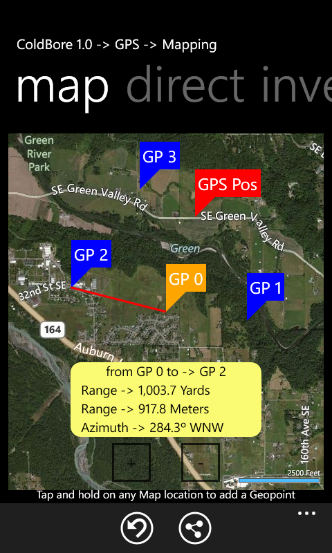

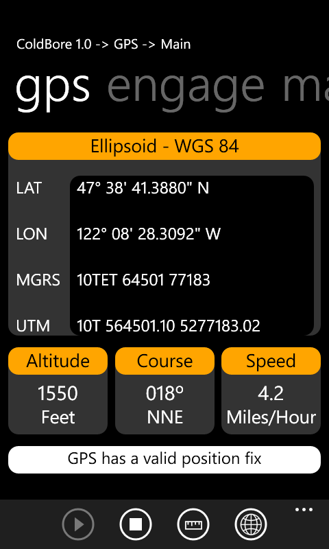

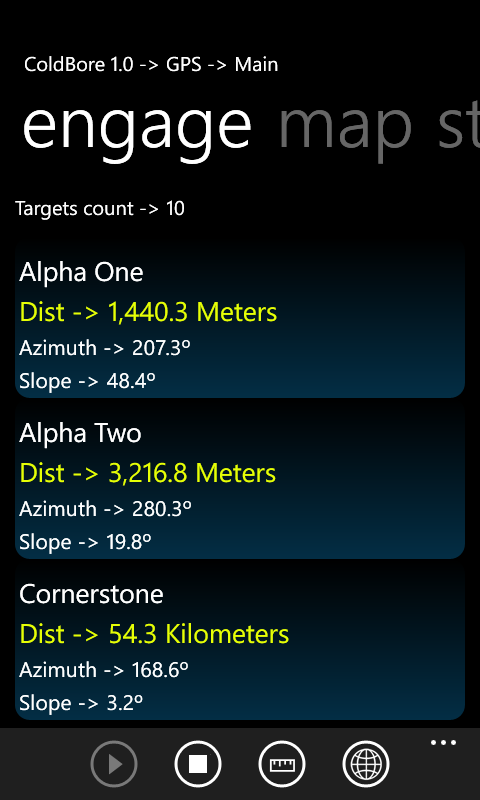

Coldbore has a GPS, Mapping and Targeting module, that among many other things let you measure distance to a target or clusters, it also features 72 ellipsoids to adjust to any map projection you can think of. A super cool and very powerful unmatched feature not found on any other package.
