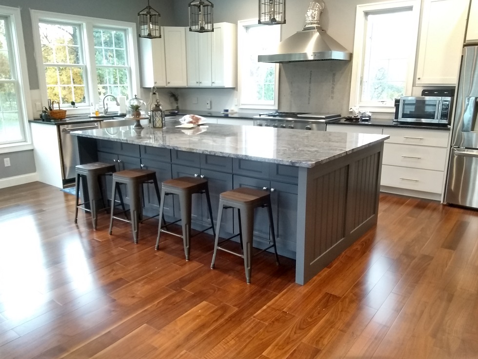

We tore the back off our ranch home and added a large room, the kitchen takes up about 200sf. The most used feature is the 2nd dishwasher (both are KitchenAids). I did a 48" cooktop with a griddle(DCS), two convection ovens under a very large island. 36" farm sink.
I haven't figured out placement of the microwave yet, so one sits on the counter.

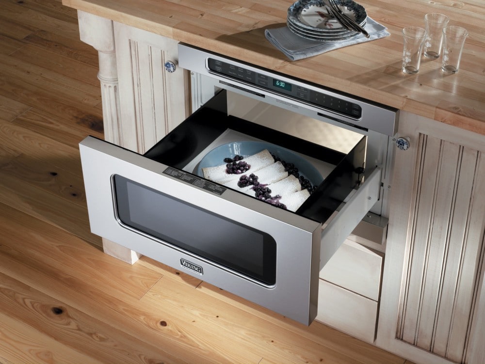

There's a drawer style microwave that takes up a drawer instead of the drawer. Gets it off the counter and not over the oven.
