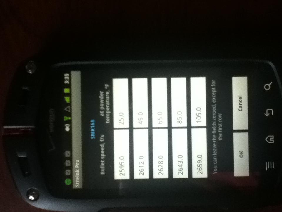

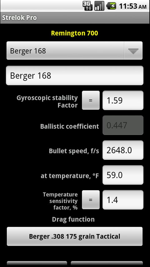

Could you please post an image? Asking because I cannot find where the input is, since the iPhone versions shows a simple linear entry. thanks!
The next screen should look like this...
I keyed in what are linear amounts but you can put in your own field results. From what I understand you need sets of two variables for nonlinear regression.
Nice pic, but unfortunately I cannot tell if the program is doing just linear or non-linear, even if the program allows for several pairs to be entered.
At this point, only the programmer can say for sure.
If you check the article's link, ColdBore 1.0 do both from the data series, and tha's the reason for cannot conclude what Strelok Pro is rally doing. But for the first image, and the iPhone shots, I tend to think it's just a linear regression unfortunately.
