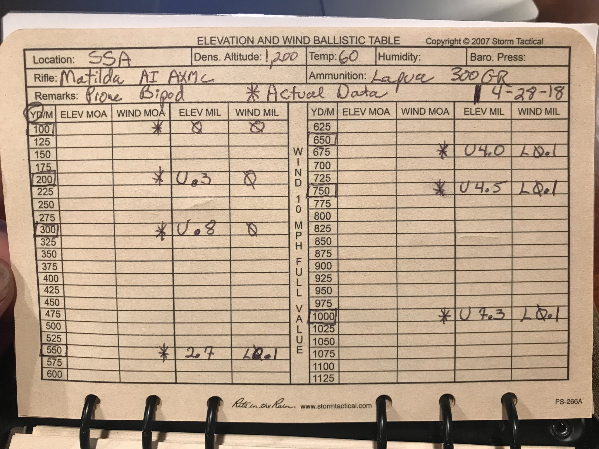

Hello all,
The last two weekends I’ve shot the AI .338 Lapua gun at distance, and the last two weekends the AB data has been incorrect. This is a new rifle, so I’ve collected and documented data.
I’ve read numerous threads on here about “truing” data, but I’m still unclear which is the right way to correct.
Muzzle Velocity- I know that I can do muzzle velocity changes, but I’ve shot and used the Magnetospeec chronograph to get inital Muzzle Velocity when I first got the gun, so unless the MV has radically changed or my Magnetospeed is incorrect, I should be right on. Recorded as 2,681 FPS.
Ammo - I’ve shot the same Lapua 300gr ammo since the start.
Suggestions? My data and the AB projections follow:
My data - AB calculated
1,000 yards - U 7.3 mils AB - 7.9 mils
750 yards - U 4.5 mils AB - 5.0 mils
550 yards - U 2.7 mils AB - 3.0 mils
300 yards - U 0.8 mils AB - 0.9 mils
200 yards - U 0.3 mils. AB - 0.3 mils

id start with truing the BC before doing large chnages to MV. the BC in AB is an average and the BC on the box is valid only at the given velocity they tested. if you are shooting faster, your BC is better and vice versa. tweak the BC in AB to match what you are actually shooting.
I would give the opposite advice from above. The reason is this...out to 500 yards, velocity is king in determining trajectory. As long as your assumed BC is in the immediate neighborhood of actual BC you are good to 500. Adjust velocity at 500 to match trajectory. Try to do this either very early in the morning or on a heavy overcast day or you will be introducing light variables into the equation that are difficult to account for.
Once that is done THEN shoot at the farther distances. Past 700 is where BC really starts to have a large enough effect to see a real difference.
If you were using something other than AB that gives you the option of inputting multiple BC's, you could create your own custom drag curve. I use Strelok Pro for that very reason. You can get the custom drag curves from AB. All that is, is them doing the BC banding for you, and it is still only thier best guess.
Set your velocity to 2780 fps and see how that looks.
Fwiw I just recently tried a few custom curves and the data worked really well out to 1000 elevation wise. +/- .1 mil at pretty much every distance.
Also to get 7.3 elevation at 1000 with 2680 fps / 1200 DA you would need like a .480 g7. I would tend to believe your velocity is off before I believe your bc is that high. At 2770-2780 fps my trued g7 is .390 for the 300 scenar in my 338 norma.

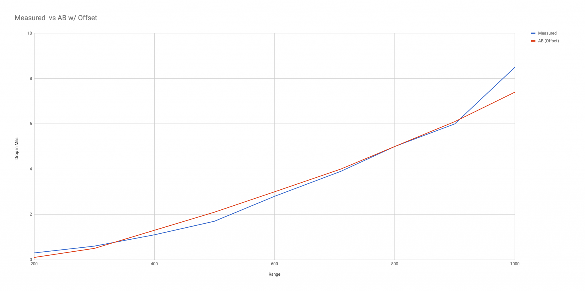

I finally ran the AB numbers against what @TacticalDillhole and I collected in Ft Morgan:
Warner Flatline .308 160gn
BC: .589 (G1)/.294 (G7) from Hornady Doppler
MV: 2852
DA: 6000
SP: 25.3
T: 67.6
H: 23
Distance Measured AB JBM Trasol Hornady
200 0.3 0.3 0.4 0.4 0.4
300 0.6 1.0 1.1 1.0 1.1 <- Huh?
400 1.1 1.7 1.8 1.7 1.8
500 1.7 2.5 2.6 2.5 2.6
600 2.8 3.4 3.5 3.4 3.5
710 3.9 4.4 4.4 4.3 4.5 <- actually 711
800 5.0 5.4 5.4 5.3 5.6
900 6.0 6.6 6.5 6.4 6.8
1000 8.5 7.8 7.7 7.6 8.2
Clearly, Hornady is closest. I haven’t been able to get the BC to true any of these. It’s possible we had the distances wrong, but we’d been shooting on that range for two days already, and I think @TacticalDillhole was using my range finder. He was also using my spotting scope with mil reticle, so he was giving me good corrections.
So did the time-traveling Chinese put a gravitational anomaly on @Lowlight ‘s range?
Other data: I had previously hit consistently at 1000 yards with 8.5 mils using the same load/rifle and very close DA.
Reactions: Bender
1- I’d be ultra concerned with how a bullet going your speed could produce a .6 mill drop at 300 regardless of the bullet’s BC
2- your numbers while lower than the solvers, are all over the place. Must be the gravitational thing..

1- I’d be ultra concerned with how a bullet going your speed could produce a .6 mill drop at 300 regardless of the bullet’s BCQUOTE]
Not really if the scope height is like 2.5", which is could be on that chassis. Also, a .390 g7 @ 2780 matches really well at all distances...
1.) I consistently see 0.8 at 300 on my local range, where the DA runs +/- 300 ft based on weather, so 0.6 at 6400 isn’t crazy.
2.) That’s why I mentioned the rangefinder.

This discussion knocked loose the memory that I usually zero to 175gn Lapua Scenar-Ls, and at the class I was zeroed to Prime 175s. I didn't write that down in the ballistic calculator sheet because it's not one of the fields. That explains 0.8 in the Bay Area, as well. When I went back in to AB and put a 1.4" vertical offset (from my record of the 175gn Scenar-Ls vs. the 160gn Flatlines), I got this, which makes more sense:
The only thing that seems goofy now is 8.5 for 1000 yards. Looking at my notes, I wrote "~8.5" on the sheet, so I'm guessing I did that later and from memory, as 7.5 would be more in line with AB.

Think that you may have nailed it!
That mv change makes the data match my acquired data curve very, very closely.
Thank you sir.
So, I’m going to postulate two things:
1) My Magnetospeed is inaccurate, despite using it in the past with my SIG SSG and getting data to match that rifle’s data. I did repeat it twice to confirm on the new AI gun.
2) After 185 rounds (since the ammo is the same factory Lapua .338 300 gr that I’ve used since the gun was new) then my rifle MV has increased from 2680 to 2780. Though this seems more likely, which seems more likely, is it possible?
Thoughts?

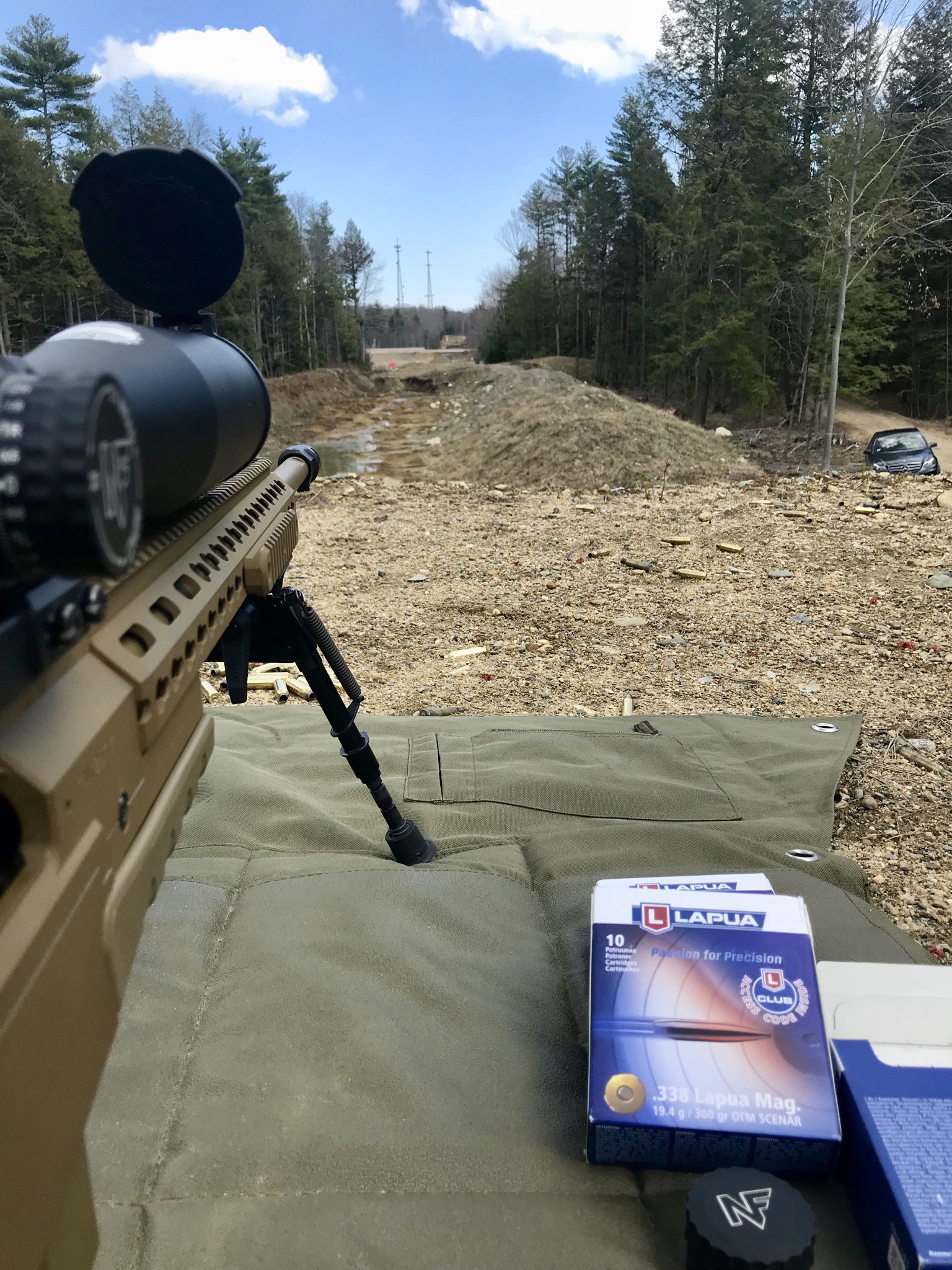

Now that you cleared the sky, can you post all the data used (MV, zero range, sight height, atmos, etc) and actual DOPE?
Assuming you mean me?
Sure.
Rifle Data:
AI AXMC .338 Lapua 28” barrel
NF ATACR 7-35 F1
Sphur Mount 1.5”
Height above bore - 3”
Zeroed at 100 yards
Ammo:
Lapua Scenar 300 gr
Chrono:
Magnetospeed V3
Avg MV - 2671
Atmosphere:
1.2 KDA
Shooting position:
Prone from bipod

So was the temp you chrono’d at The same as when you were shooting? What were the environmetals when you were shooting?

Where/how does using the MV Calc table fit in to this truing discussion? Is using this function also a 'truing' exercise? Does anyone really use this feature?
And, if I understand it correctly, you're supposed to populate the table with muzzle velocities taken at about 30° apart. Since months can go by during this data collection time...if the barrel does 'speed up,' how does that effect the truing?
i use it and it helps estimate drops at different temps where you havent collected data. the more temps/velocities you populate with it determines your average change in velocity per degree. it helps when you have data at say 90, 65, 40 and 30 when shooting at 55 for the first time. itll get you close if you dont have a chrono available, say if you are hunting. they say have at least 30 degrees betwen the high end and low end. of course that not possible all the time all at once, it could take two seasons to get there depending on where you live.
MV: 2852
DA: 6000
SP: 25.3
T: 67.6
H: 23
I know, I'm late to the party:cool: but while perusing around the forum I found this post, curiosity led to me check the data and the BCs
So, you say Warner but your data is from Hornady? If I run your data with what is published by Warner I get this at 1000
JBM 8.1 and Trasol 8.3 (in reality I used CB but I guess the results should be the same)
So it looks like your BC source is not quite right which clearly explains the difference between your observed dope and the programs. What made me to check was the distance, in my experience not having a good or close match at 1000 is usually not happening unless the inputs are not right.
