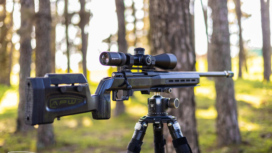

The Carbon X is a carbon fiber stock 100% designed and made in South Africa. Like any of our projects, APW products and equipment are based on the needs of shooters like you.
Why the X you ask? The Carbon X was designed from the ground up to be a hybrid system that can flourish in multiple disciplines. Whether you are taking your 6.5PRC hunting or attending a competition, the Carbon X will exceed your expectations
First, we assess why something should be made, then we figure out how best to make it. Simple enough, right? In theory, yes, but in application, it takes a mastery in a host of critical disciplines: design & engineering, material selection, the fabrication process, and testing. We'd say that the results are worth it, and if you've ever used any of our products, you probably agree.
The Carbon X comes with an Arca/Picatinny rail included.

It appears that is the case but there is no mention of a mini chassis, weight, length or any technical info on their site.
It weighs about 2.8 lbs. The bottom metal is integrated in the stock, the inlets are available in Rem700 SA RH & LH, as well as Tikka T3x SA RH. It is designed to accept AICS magazines.
It uses spacers for the LOP (13.25" to 14" LOP), and a quick adjustable cheek rest. Comes with ARCA/Picatinny rail included. And there is a weight kit (internal, external and butt weights) that can be purchased separately.
Hope that helps, let us know if you have any more questions!

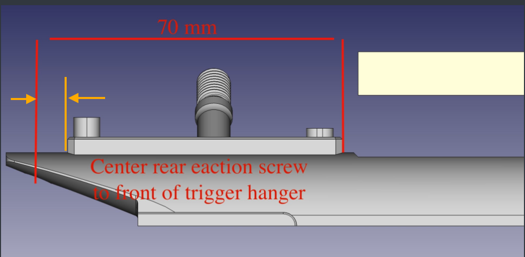

- Does the inlet have room for the ARC CDG trigger hanger? It extends forward a little more and needs some extra milling on some 700 inletted stocks/chassis.

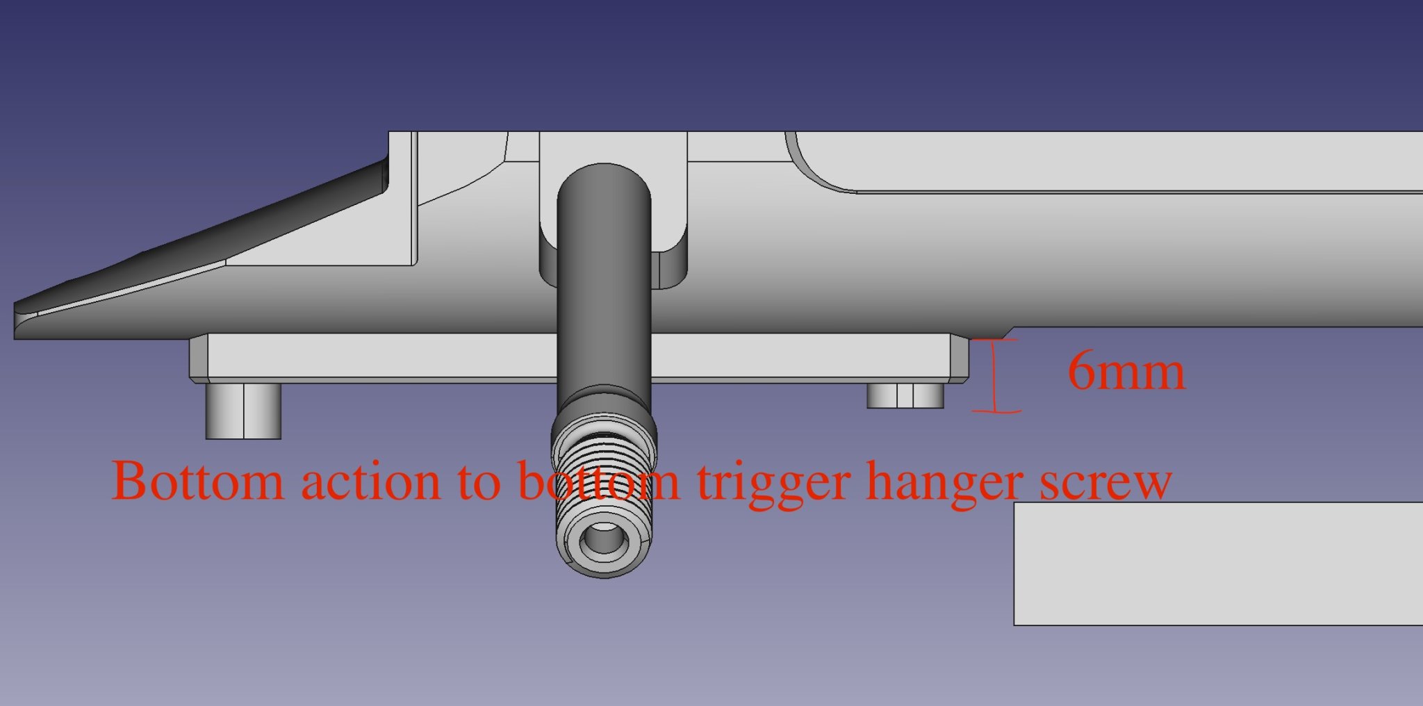

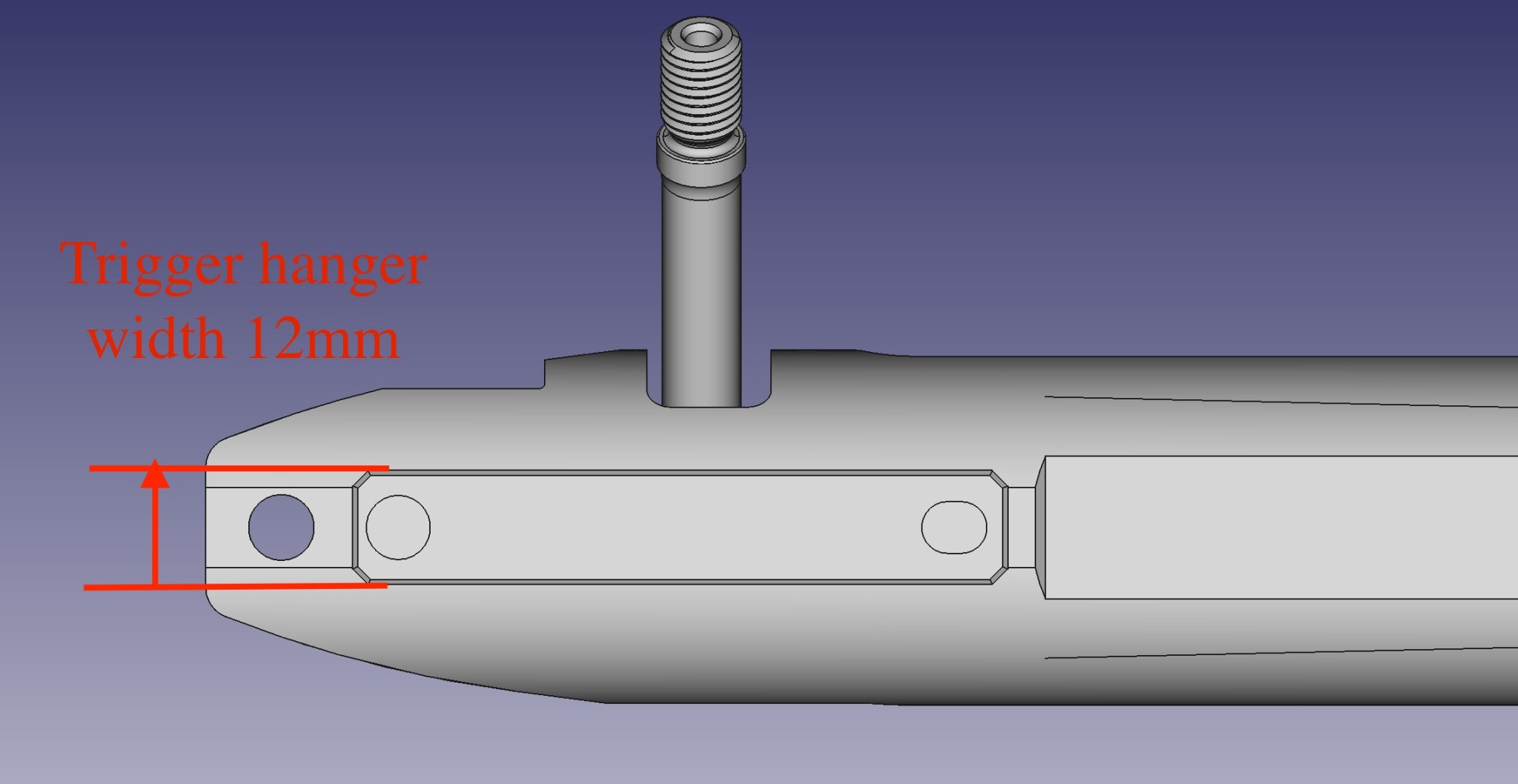

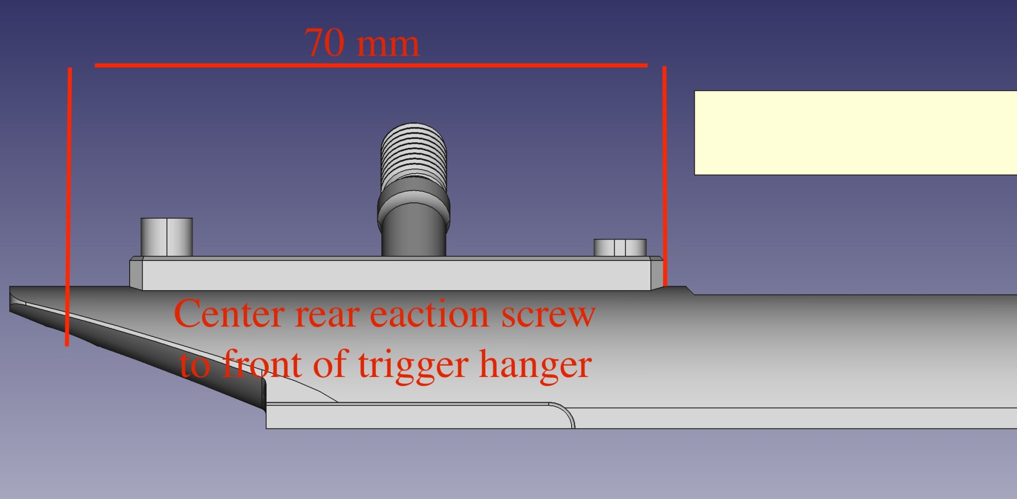

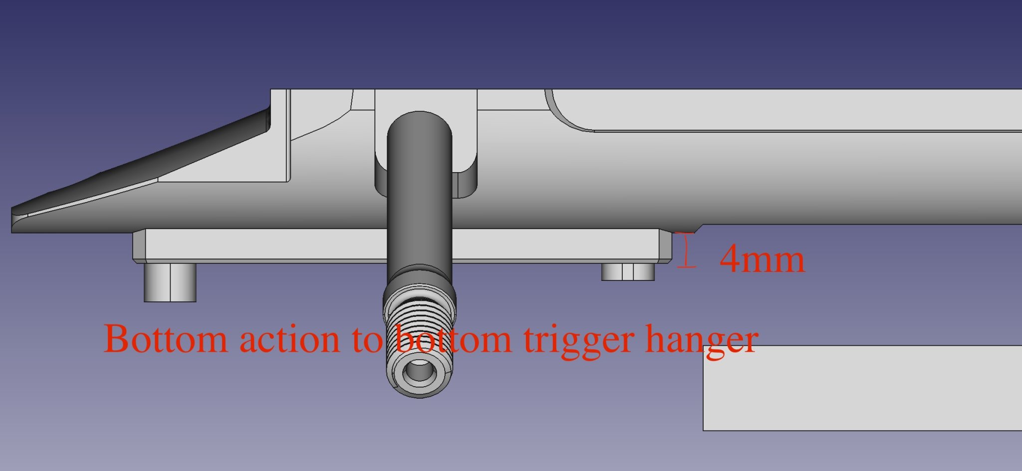

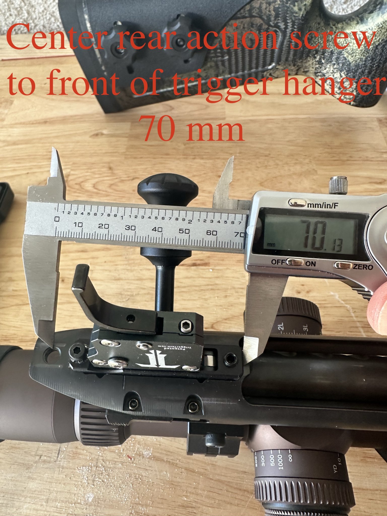

Thank you for the information Sherif, here are the measurements of the CDG action.
Is the magazine latch height adjustable or do you have different mag latches for AICS vs AW?
I hope you don't mind I am posting these questions here instead of a PM. I figured this info might help some others as well.

Unfortunately not at this time. I am on the road and have no access to my rifle. I will be back in a day or 5. From memory the total lenght of the trigger hanger is 60mm so 10 mm would be the measurement you are looking for. I went trough all this prior to milling my KRG W3 stock so this I had these pictures on file.
Ok, as per the provided dimensions it should fit, there shouldn't be any interference. However, I would need the last dimension to make sure no interference between the hanger and the stock aluminum insert. Once you are able to provide that measurement please email it to us at [email protected]

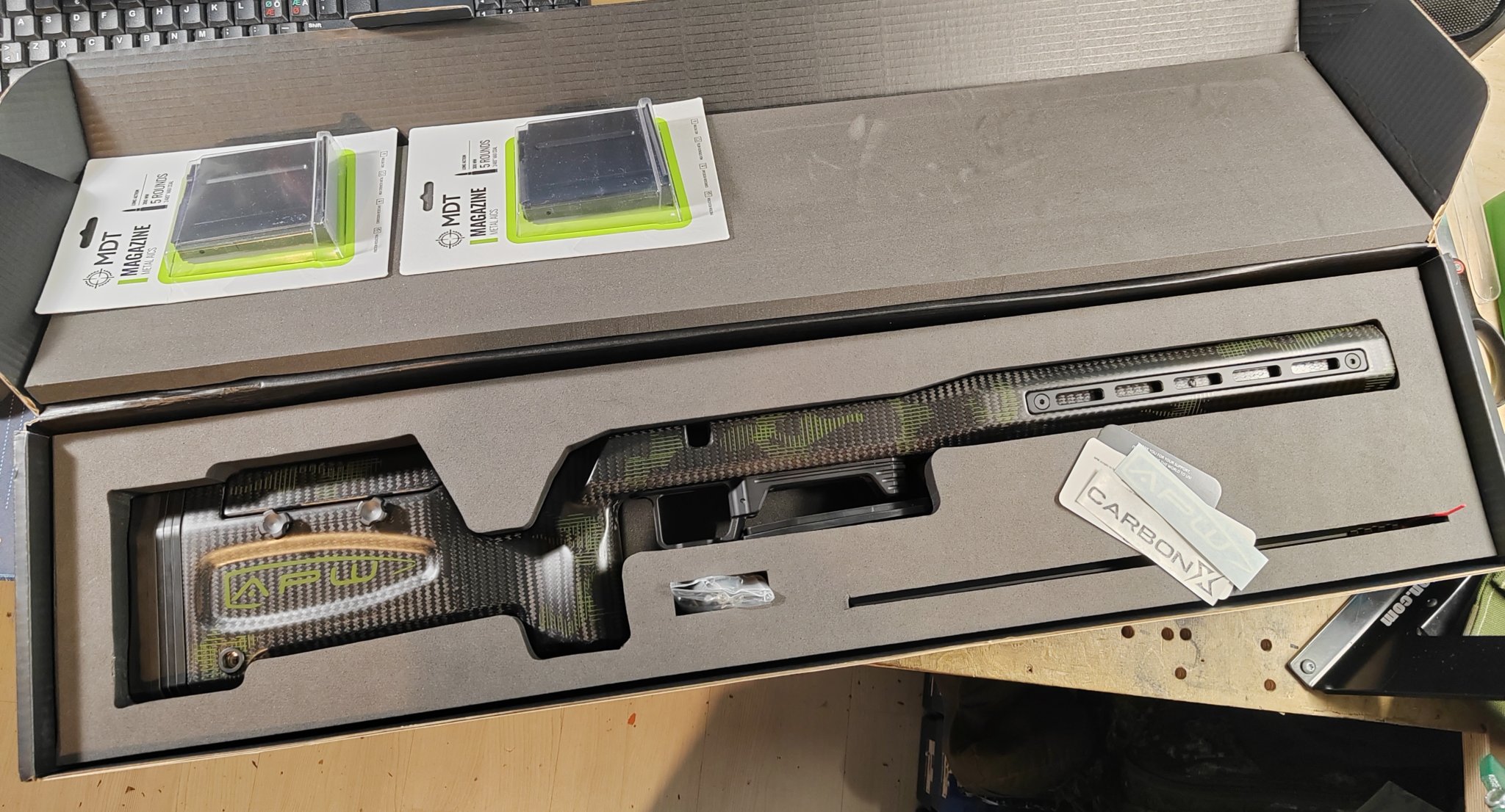

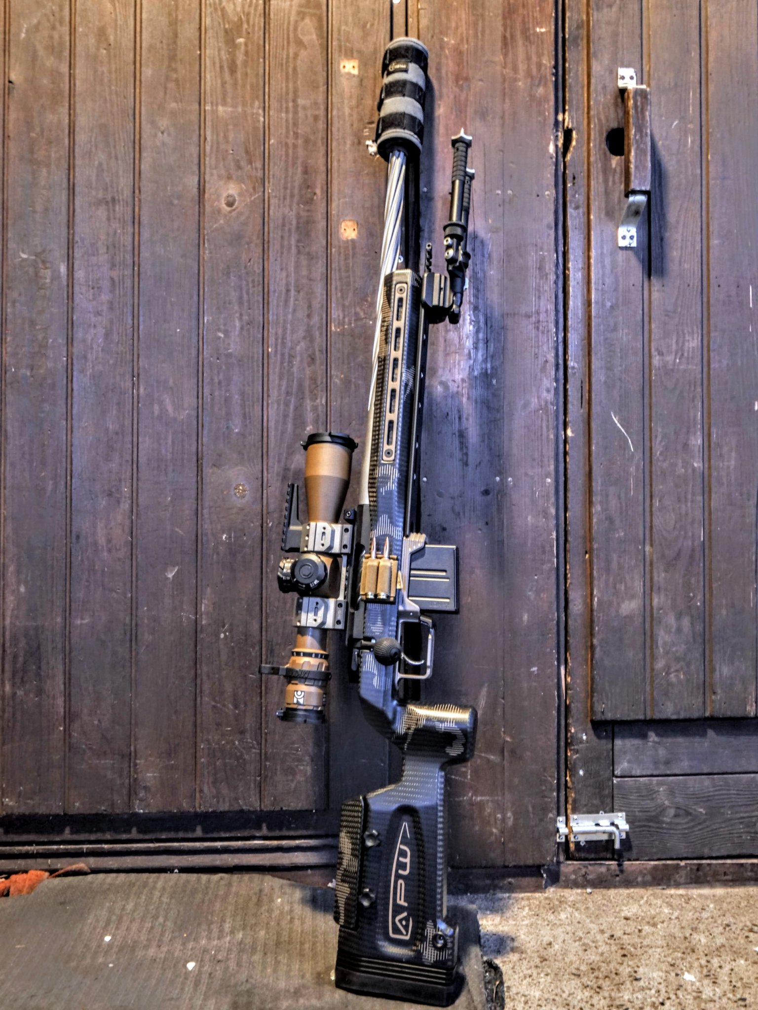

Oh my god, first of all, happy new year guys, and second, i received a package today.
Carbon X by APW!
This is for my customer, Tikka T3 LA stock, and man, i am stoked of this quality, it is so cool.
Mine is coming, it has been stuck in Dubai air port, they were quessing, which oil sheik that stock was going, but then they
read the label, to FINLAND :D
So this time my customer will be the first man in Finland, who will have Carbon X stock in hi´s rifle, but i wan the
one who did put hi´s hands to it :)
Trust me when i say this, this is like 10/10, super quality and the look is and feel is phenomenal.

Any way you gents might know what bottom metal is on that stock? And where I could find one for myself? Thanks for the help.
You do not need a bottom metal, it has a minichassis, that kind of is the alloy v-block and bottom metal on the same block.
Just screw your action to the Carbon X, add AICS magazine if you have a SA rifle and enjoy. LA i have sold MDT steel magazines.
