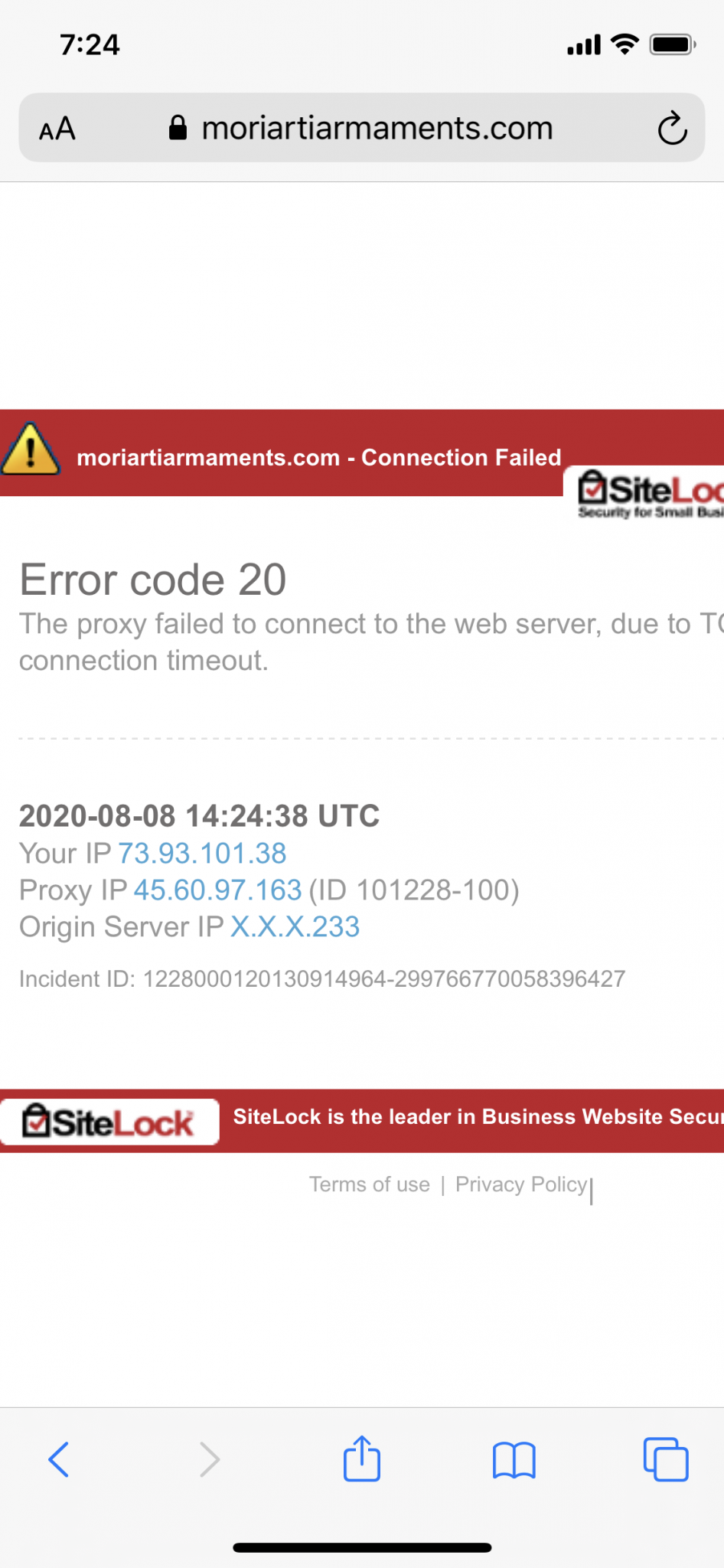

Why does Moriarti’s website look like this?
Always match your upper and lower when it comes to the large frame stuff.
