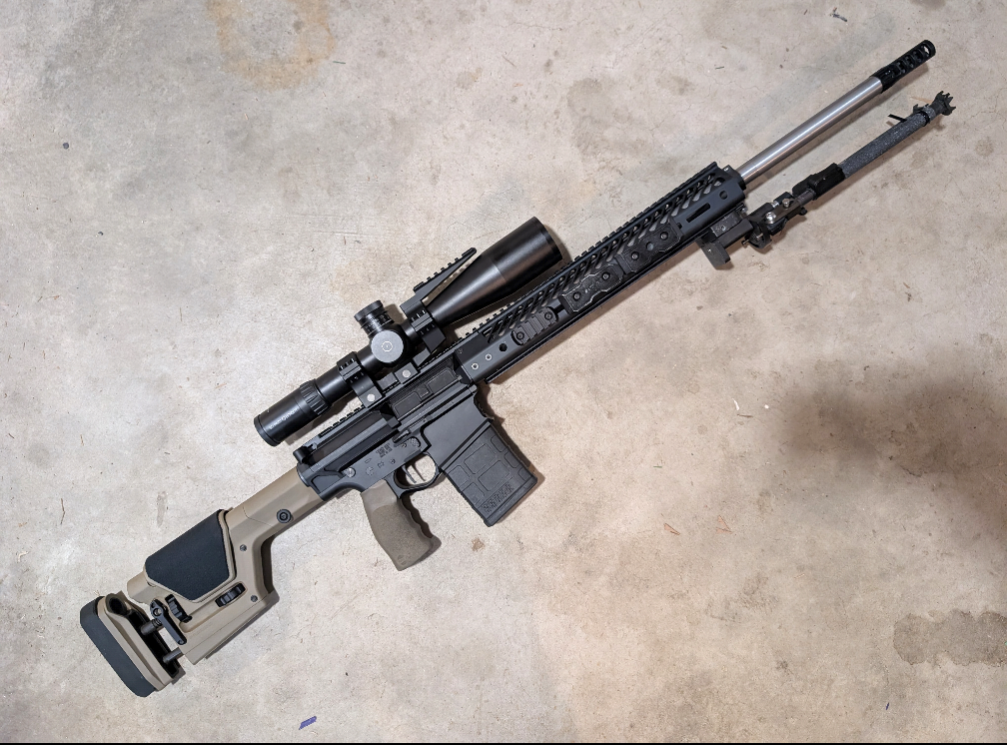

My bare SP-10 with as heavy a 24" 936 journal barrel as I could get weighed 12lb 14oz. That was without scope/ mount, brake, bipod. 7x35 ATACR in Hawkins Heavy Tactical weighs 3lbs 5 oz. CkyePod weighs 1.5lbs. 1.2" Hawkins Updraft weighs 6-7 oz ?
This weighs 20lbs 2oz. It's got 4 x XLR MLOK weights that weigh 6oz each. Sawtooth ARCA rail. Hawkins .900 Updraft. S&B PMII, Hawkins AR Heavy Tactical 34mm mount.

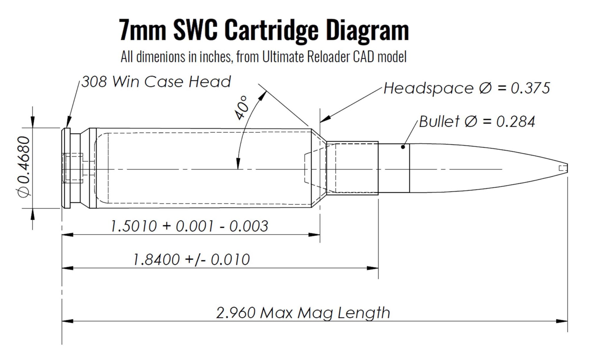

Good point re: the bc of those 7mm pills. With that in mind Another interesting option to consider would be 7 SWC.
i have Larue mags which i think max at like 2.875". What kind of COALs are people talking for the SWC?
I don’t have personal experience with it but here’s the diagram (note its optimized for 180-195gr bullets). Not sure if eagle eye does wildcats or not though…
Looks like you can use a 308 mag without the binder plate.
I think the issue with the 7SWCs is going to be recoil. I just did a 25GT. I shot a 6 Dasher barrel suppressed against a braked 25GT barrel on the same rifle. In the same range session. Just swapped barrels.The recoil difference was significant. I'm fairly certain the difference in recoil is coming from bullet weight, not powder charge. 37.5gr H4350 135gr Hybrid vs 34gr H4350 105gr Hyb.
I just ended up buying 4.5lbs of AI weights to tame that 25GT. A 190gr with 38 to 40gr of powder? It's going to recoil like 308, or worse. And then whatever you have to do to get it to feed, if it'll fit in a AR mag.

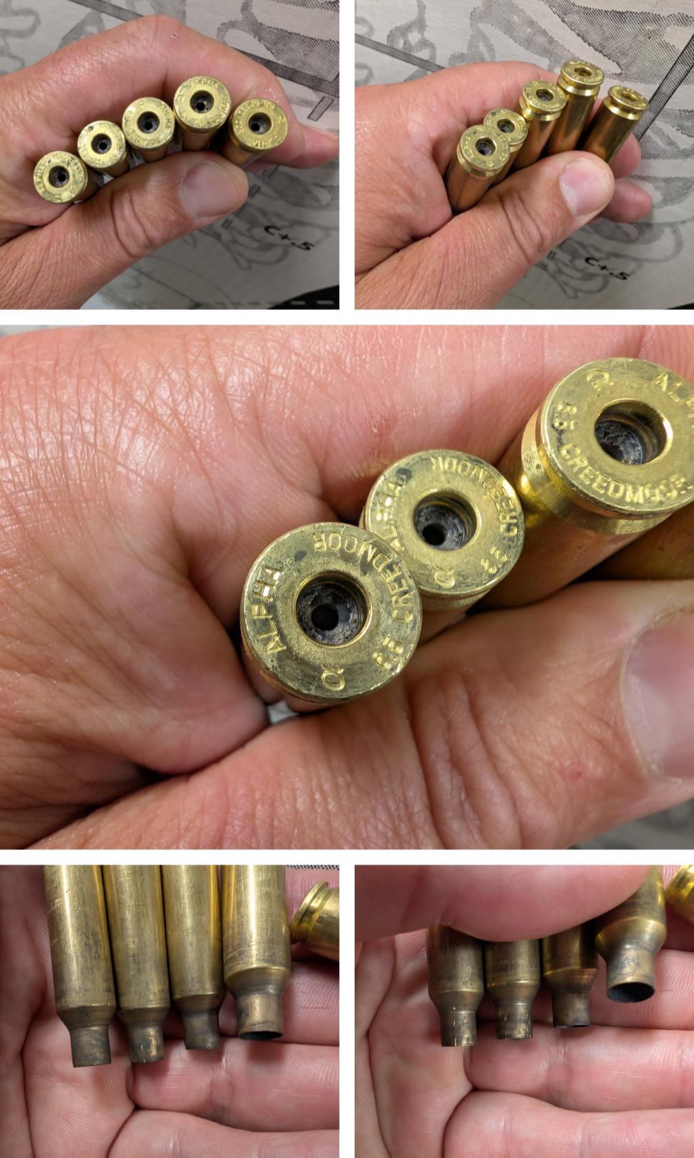

This is what my gun does to the brass. 39.5gr H4350, 140 Hyb 20 thou off the lands. 2690fps at 100rds through the barrel.
