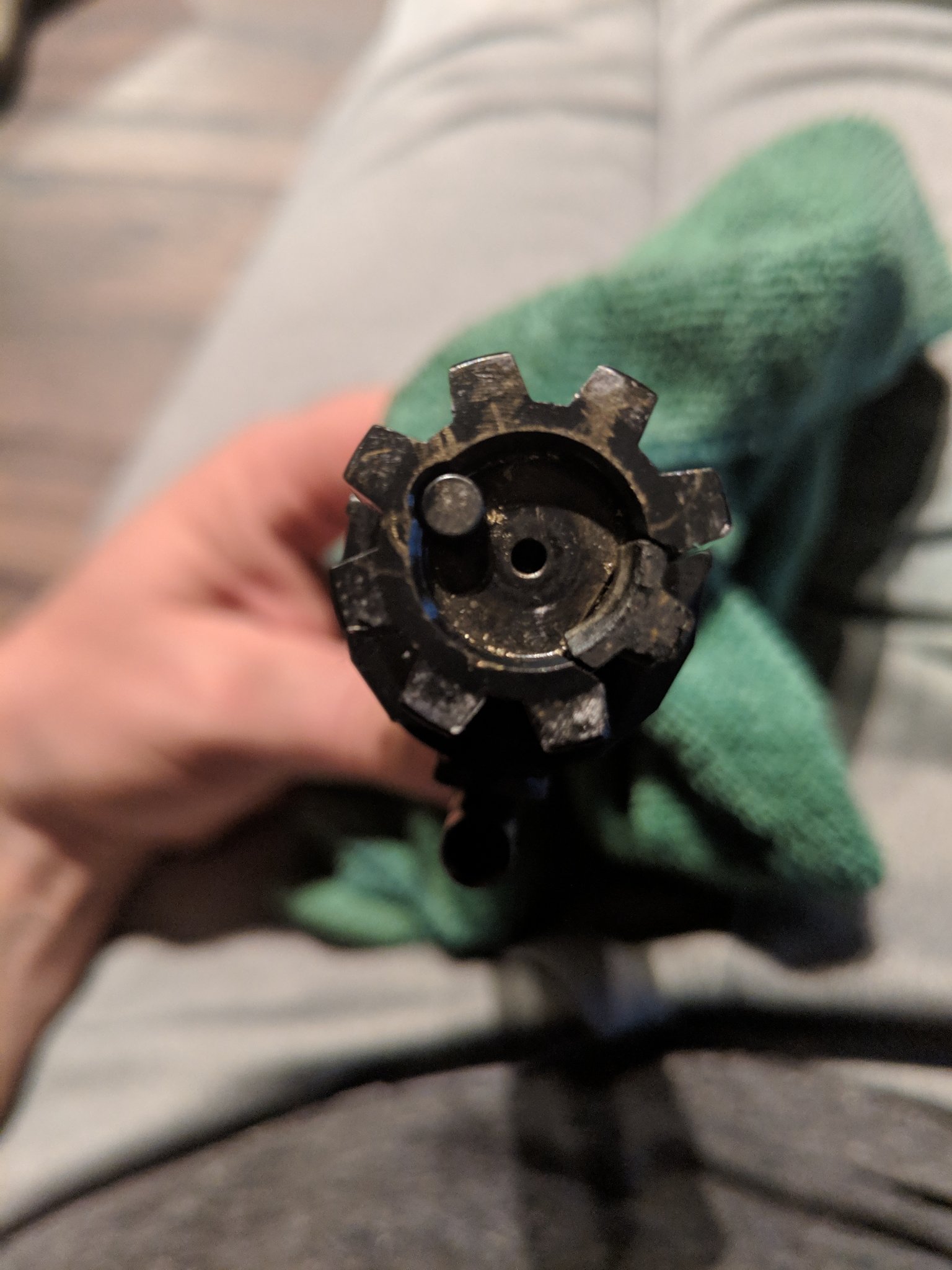

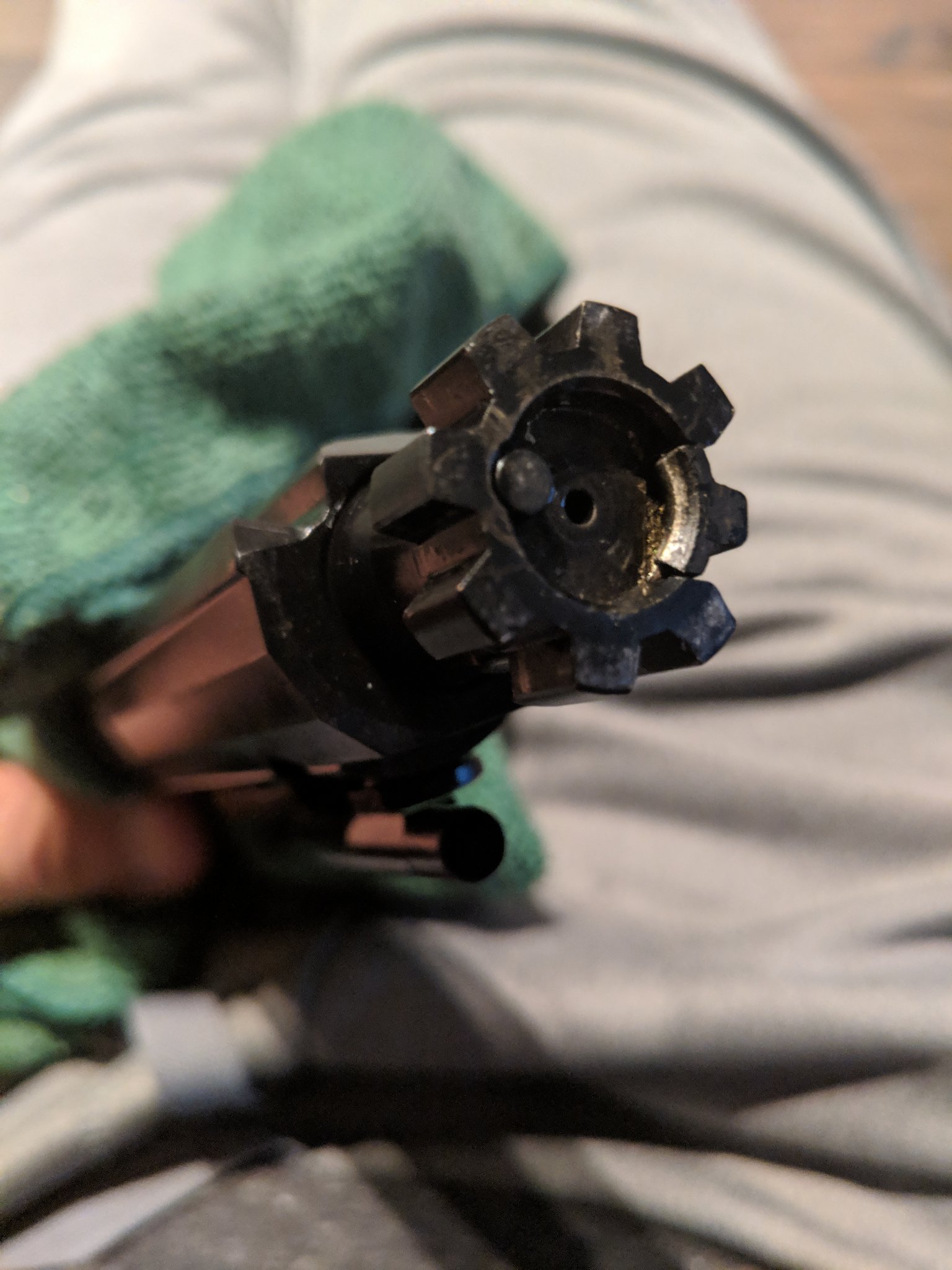

I have added a couple of photos. So I took the pic before cleaning or anything on purpose in case it gives any clues to you guys. Those yellow lines that look like brass are just marks not actual brass.
Is the ejector supposed to be inward that much? I feel like the one side looks like it's much deeper into the bolt face circle then the other side?

Sounds like you meant extractor, not ejector? Both look OK in the pics, but that doesn't mean they operate smoothly. The extractor could stand a bit of polishing on the forward face to avoid shaving brass when it's forced to jump over a case rim during the chambering process. Sometimes an overly stiff extractor spring will contribute to that as well.

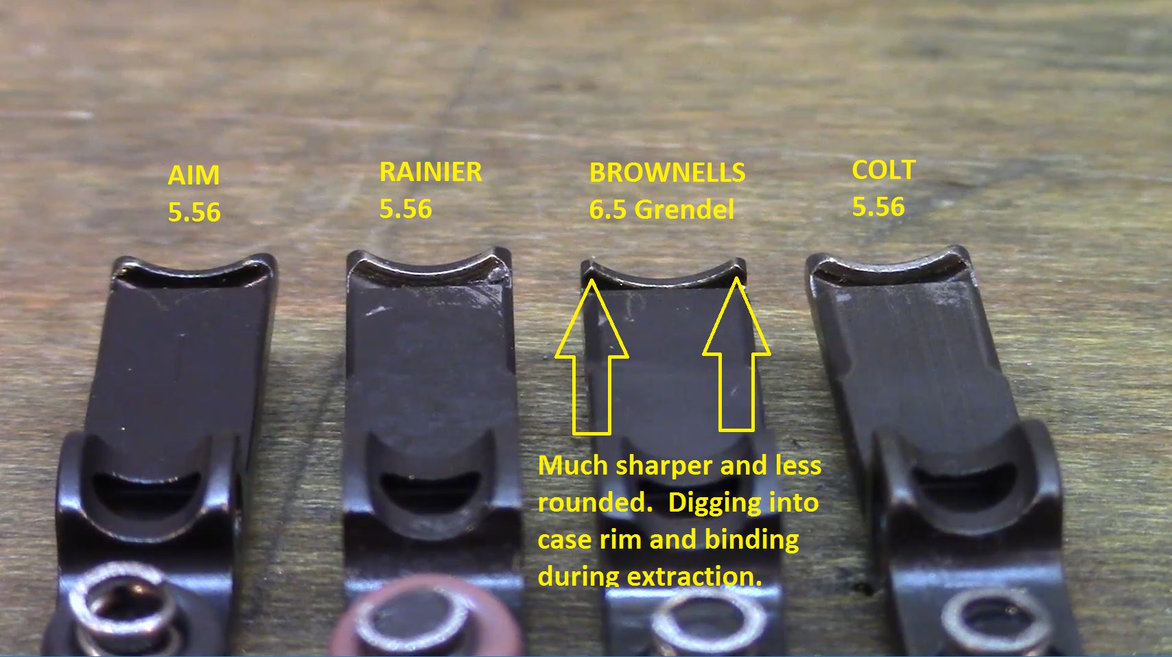

Those ends on the extractor are awfully sharp... and don't look rounded at all.
If the edges of the extractor are too sharp... the case won't "roll" out... it will bind at those sharp ends.
And that could be enough of a "bind" ...
Check your brass rims.. see if they have any excessive marks on them.
