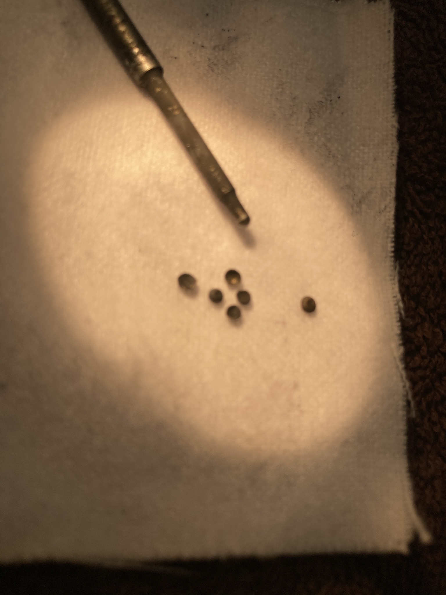

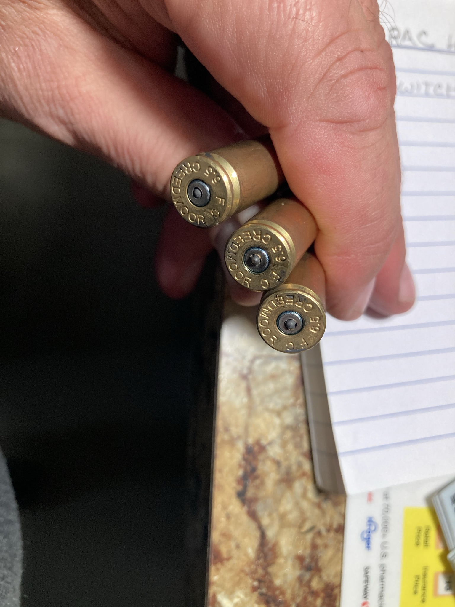

I am testing ammo in a new Aero Precision AR-10 in 6.5 Creedmoor. Accidently bought a box of FC 139gr Federal with small primers. All other large primer ammo (Federal, Remington and Hornady) I have shot so far functions great. The FC small primer is giving me high psi indications in the recoil and blow by. Also bulges or pops primer strike. See photos attached.
Anyone else having this kind of issue? Firing pin is smooth and correct length. Not sure what is happening.

And it isn't often I see the primers anvil protruding from the pierced primer hole.

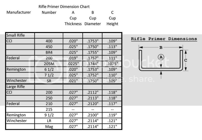

This chart has been around for as long as I can remember... so I really don't know if primer cup thicknesses have changed at all.
But it could be the thinner Fed SR Match primer cup is contributing to your issue ( along with the recoil issue )
