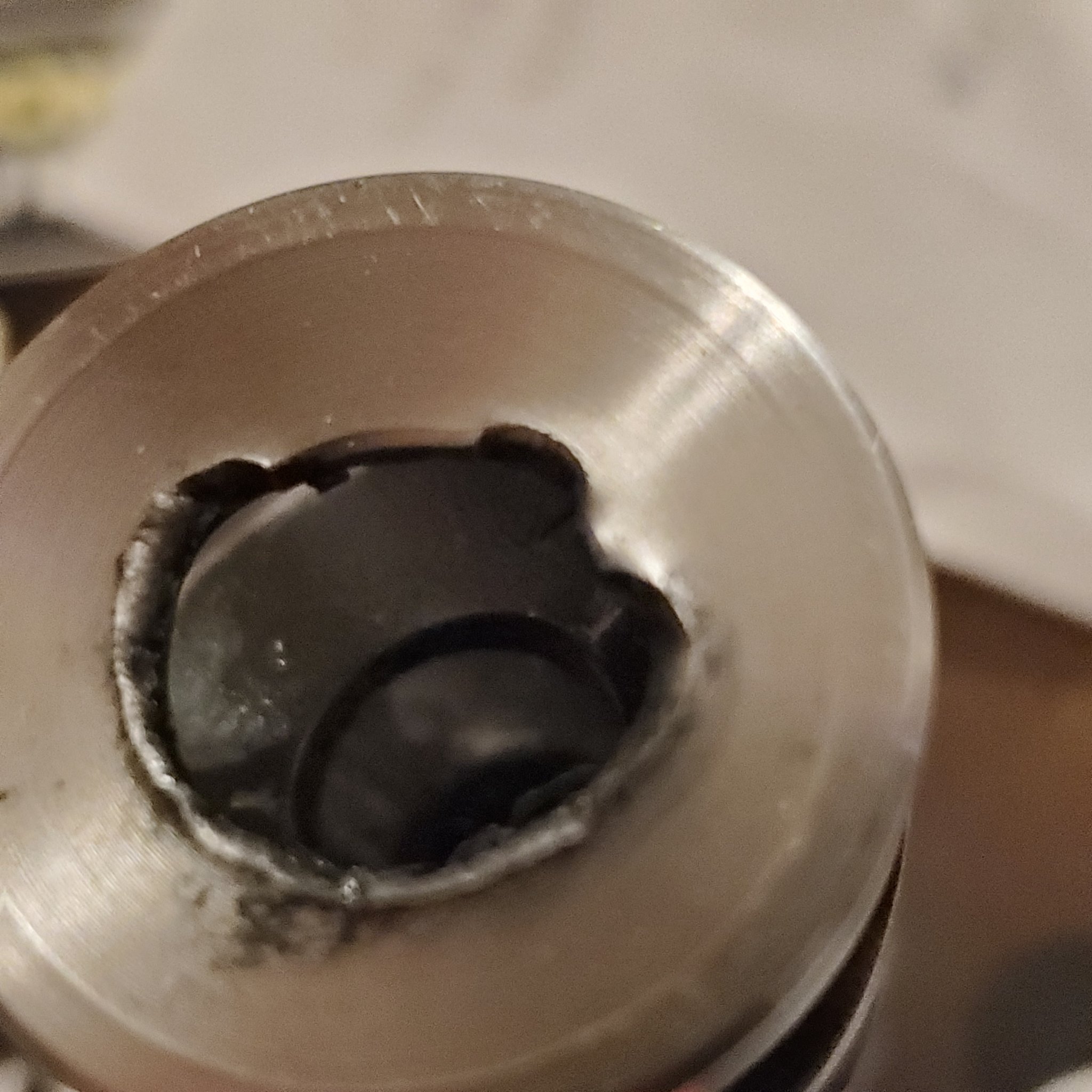

It was the first super fired in the barrel and blew up inside the muzzle brake and destroyed the brake and the magneto speed. ..an expensive lesson. The cartridge is of little use except for LR shooting of subs with high BC 300 gr bullets on steel...it has too much capacity for subsonic and too little capacity for supers. I asked Faxon for an 8 twist...they can only do 3 twist as
per licensing agreement. The 3 twist is a sales gimmick and mathematically adds almost nothing to the energy of the bullet in rotational velocity. Shot to shot variation adds or subtracts more energy than any 3 twist. The 3 twist is actually a negative. And the brass if made from other calibers 308, 30-06, 25-06, 6.5 Creedmoor must be neck turned unto the shoulder to preform well in the AR 10. I did get a coupon from Faxon and got the fast twist 450 bushmaster which produces more close range energy in a lighter AR 15...and will handle 502 gr bullets for subs, for a lot more sub energy on target, at close hunting ranges. My 8.6 Blackout is an expensive plinker...285 eldm will not make 50 yds at 1400 fps, the best cheap plinker is the 200 gr Speer it actually got to 1600 fps and stayed together...lead bullets must be kept in the subsonic area. They will blow up as soon as they leave the confines of the barrel... dangerous to anyone on either side of the muzzle. Beware, and be careful...

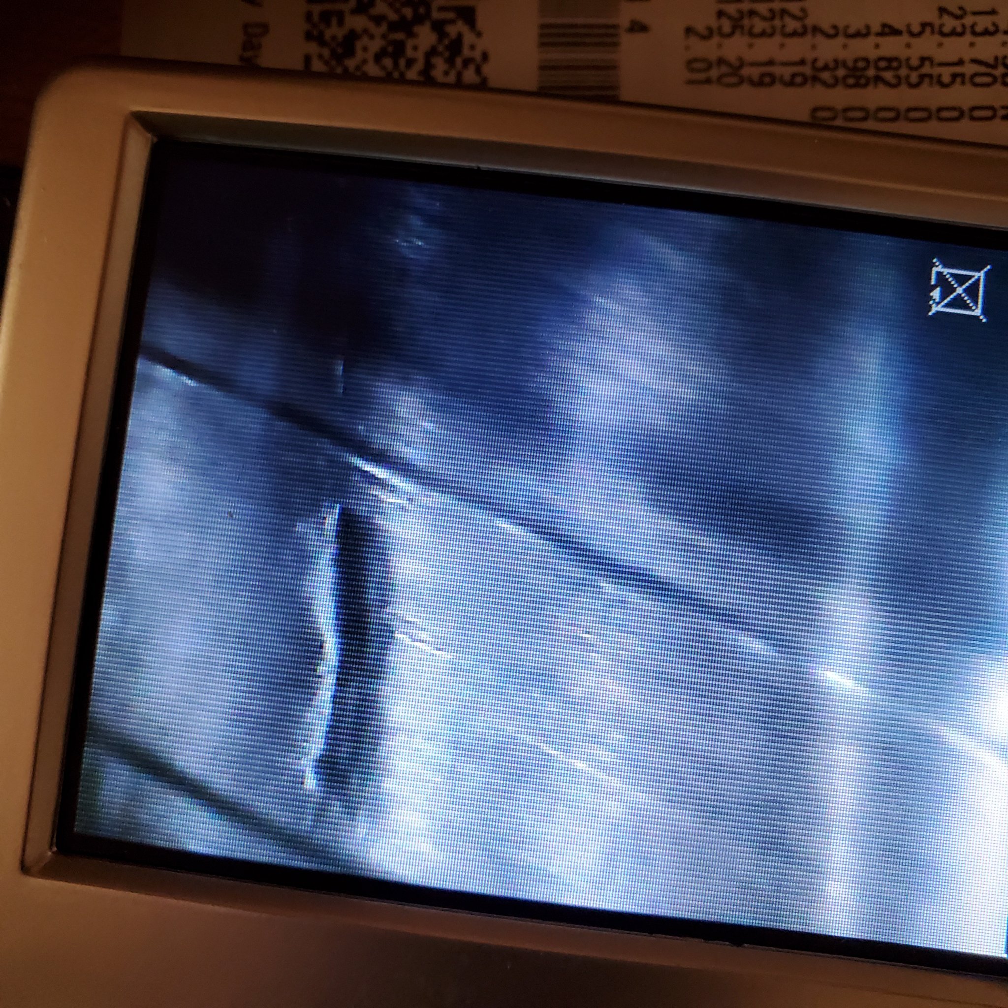

I bought a Faxon 16" 8.6 Blackout...absolutely the worst barrel rifling I've ever seen in a new barrel..but they were the only game in town at the time. The 3 twist was hard to see through, a bunch of fuzz appeared. Ran a patch through and metal pieces and slivers and brown rust like stuff came out. The rifling button on the 3 twist did not have enough clearance, enough lube, pumped in. Galling and tearing metal as it went, especially at the start.
I built a fuxture and lapped the barrel with silicon carbide lapping compound, then polished with Iosso paste. But chunks of metal were torn from the bore & pits at the start for quite a few inches, in the borescope...but the last few inches were okay...so it might shoot.

This the inside of the new 3 twist Faxon barrel ...after it was hand lapped, and polished, to get some of the machine marks, galling, and tearing out of the 3 twist rifling. Pits and tears and inclusions still remain. This is one of the worst going all the way across. But its fairly accurate with 300 gr subs...only.

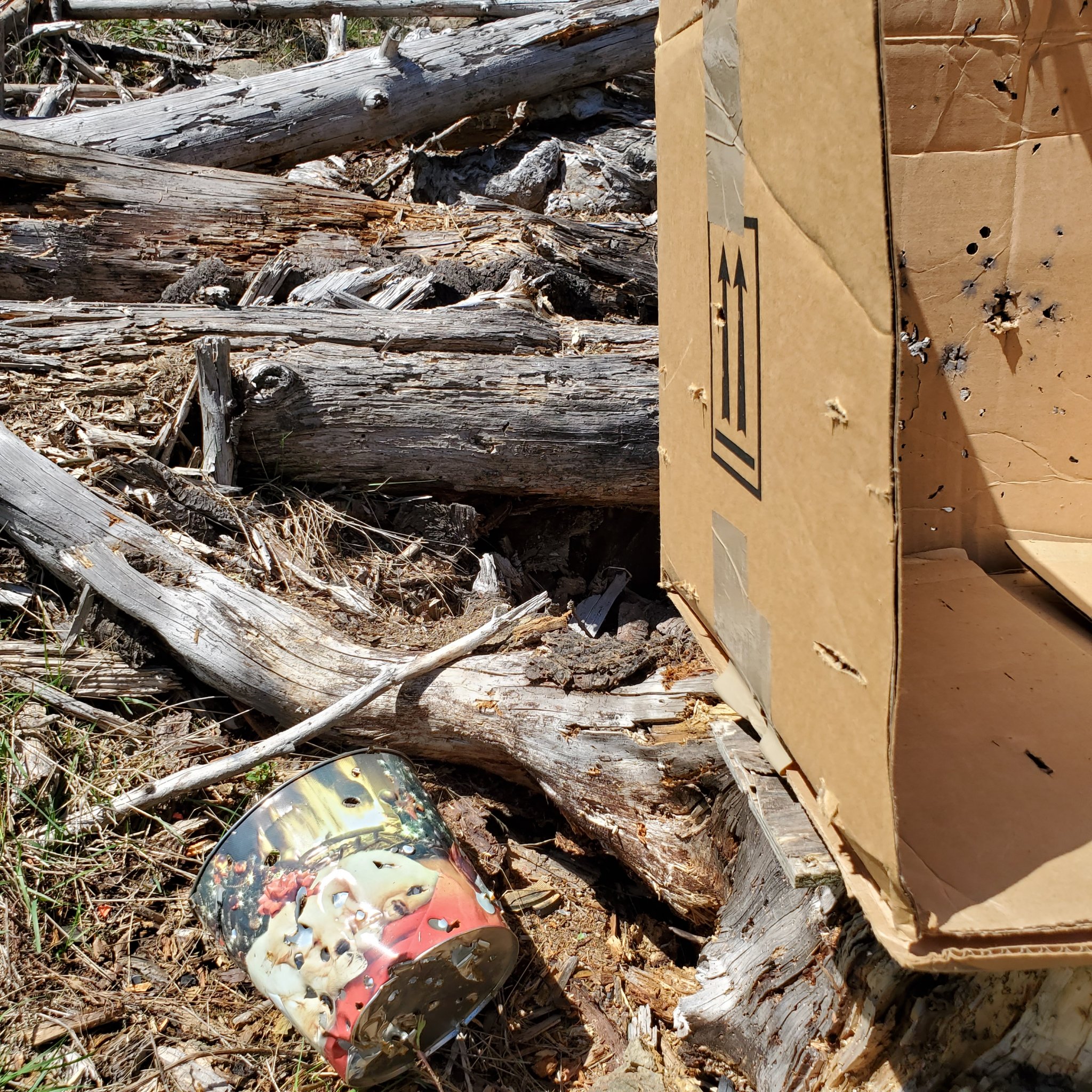

This is how violent lead bullets are this was a lower charge if the Faxon recommended...the barrel was 2 feet from the large open cardboard box. The bullet instantly fragmented like an uncontrolled shotgun with a huge pattern, bullet fragments covering the top, bottom, and both sides, as pieces of lead and jacket strafe the outside as well. The muzzle device was removed as I'd learned from the first super sonic shot fired.
It might be a great house gun with super sonic lead bullets as it would hit an intruder in the toes and forehead with one shot and both walls of the hall. It does not pattern well however as I fired them at close 10 feet targets on the ground...and the lead dust that ya smell is probably not good for your health. Stand up wind. I quit that endevor. It's a specialized sub sonic plinker with the 300 match bullets and kinda fun to shoot with those, but I feel guilty for wasting 300 gr Bergers on it. So I had to see what the 3 twist hype, was all about ...I did, and will never build another 8.6 blackout. Right after I use up the 1250 300gr match bullets...the only bullets that makes it worthwhile to me.

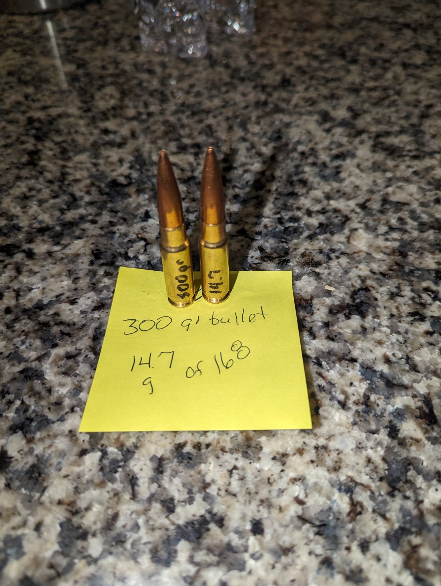

The recoil is mild, and the best loads for my 16," were 300 gr Sierra MK 15.8 gr AA1680 accurate but higher S/D than imr 4198 loads. Berger 15.8 gr of imr 4198, the Berger load has low S/D subsonic plus best accuracy for any long range endeavors...both have high BC. This is a fun shooting combo and runs perfectly when the gas port is drilled opened and utilize the adjustable gas block. I do not plan to shoot anything but targets with mine...so it will do well for that in subsonic mode.. I use 338 mag to kill with, usually inside 100 yds, high impact velocity big diameter, heavy bullets, kill very well, .huge wound channels all the way through, with football sized exit wounds...nothing but skin holding the off shoulder to the body.

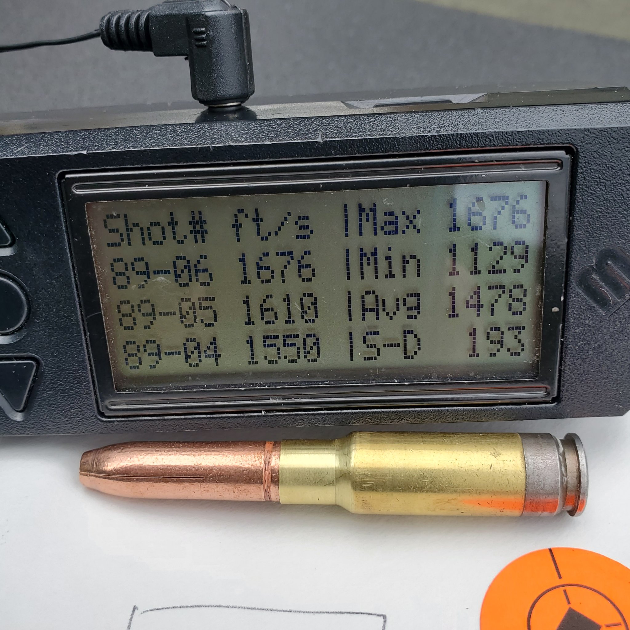

I just weighed the buffer it 3.8 oz...I use the same buffer and spring in 308, 6.5 Creedmoor, 8.6 blackout, 358 win,...
I see the delima, velocity opens the bullet to enlarge its crosssection, plus blasting bone, blood and tissue at greater speed, causing trauma and massive wounding, and a larger permanent cavity.
Using only factory ammo on a less popular caliber always limits your choices.
I do not know how well the Barns bullets preform at 8.6 velocities...or what range limitations the lower velocity may have...Hornady has printed limits on muzxle velocity vs expansion like 2500 fps min , for all hunting copper and lead except the 338 Marlin 200 gr goes down to 1800 min muzzle velocity.
So ya probably need more ammo or reload to get it tuned and lock back the bolt. I don't remember the size I drilled out the gas port probably .086 or .093" I believe it was .093"
So it runs supers and subs. So I went to check the 8.6 upper and it does not have an adjustable gas block! One of the few! Most are SA adjustable. So it's a Faxon gas block with a drilled out gas port...I was gonna count the clicks to close...but I remember being skeptical of this caliber and was going to make it work with the least expense...my barrel was horrible, the worst barrel I ever seen, galling and torn rifling, with pits...had to lap it with silicon carbide lapping compound and polish it ...so I could see some rifling...it was bad at the chamber and better toward the muzzle.
So with the 3.8 oz buffer and a .093" If I remember correctly gas port it will run.
What's nice about the 6.5 Creedmoor is their is factory ammo, with the 120 gr copper Barns it may be the way to go with respect to recoil management and killing power...the 338 federal or 7mm-08 barrel is available from Wilson combat....338 200 gr copper bullets at high velocity...but more recoil... 7mm-08 and 308 probably fairly close in recoil...
The 6.5, Creed is popular and available...
But don't give up on the 8.6 Blackout without a few tweaks.
Picture: My barrel is accurate with the big 300 gr Berger, the 225 gr copper is accurate enough for hunting...but the speed was like 1900 something... it needs more experimentation. It could be a real hog smaker at 50 yds...the potential is there, but I'd like a little more velocity...good luck hope it works out. Should be all ya need, open up the gas port, and 3.8 oz buffer.

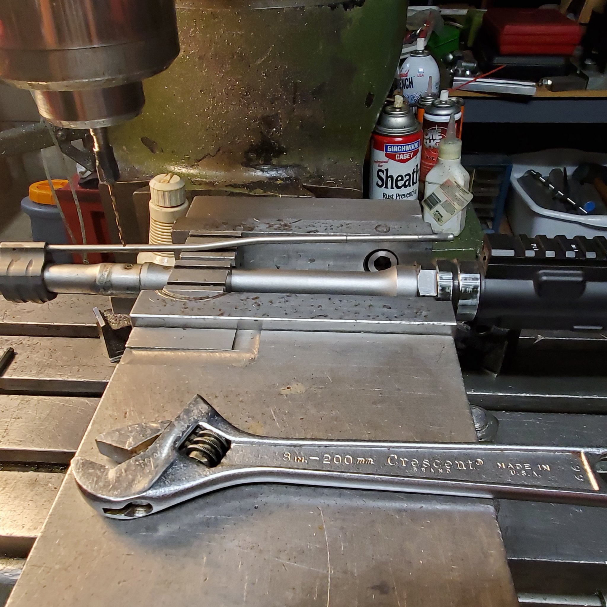

This is drilling out the gas port set up in a Bridgeport mill, just loosen and slide gas block out of the way. Set up level with the reciever flat top. I use an edge finder but you can use the previous drill diameter to center up the hole in the barrel ...drill out tbe next number size larger.
Use cutting oil, you can set a stop and or put a light in the bore so ya don't hit the rifling on the other side of the bore...buy you can feel it break through....clean & polish the interior of the bore at the new gas port location...a drill press will work, take your time, use quality drills.& cutting oil...this is more professional and precise...what do ya expect from a retired machinist...if it's done, it's precise...there are alot of ways to skin a cat...this is just one setup...I probably use 10 different way to do it...including specially milled vise jaws ..depends on barrel length and gas block location. Set up is like 5 minutes.

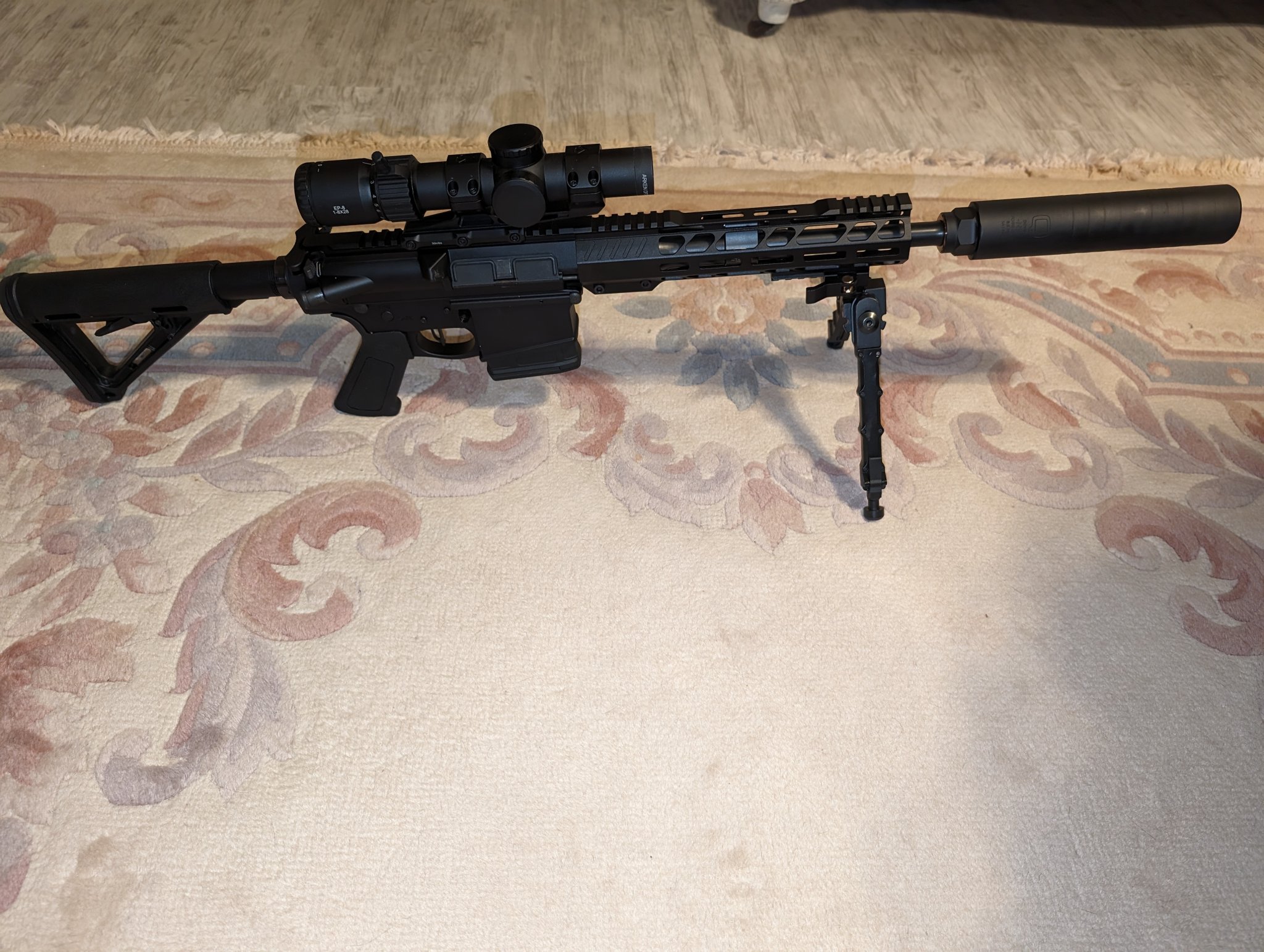

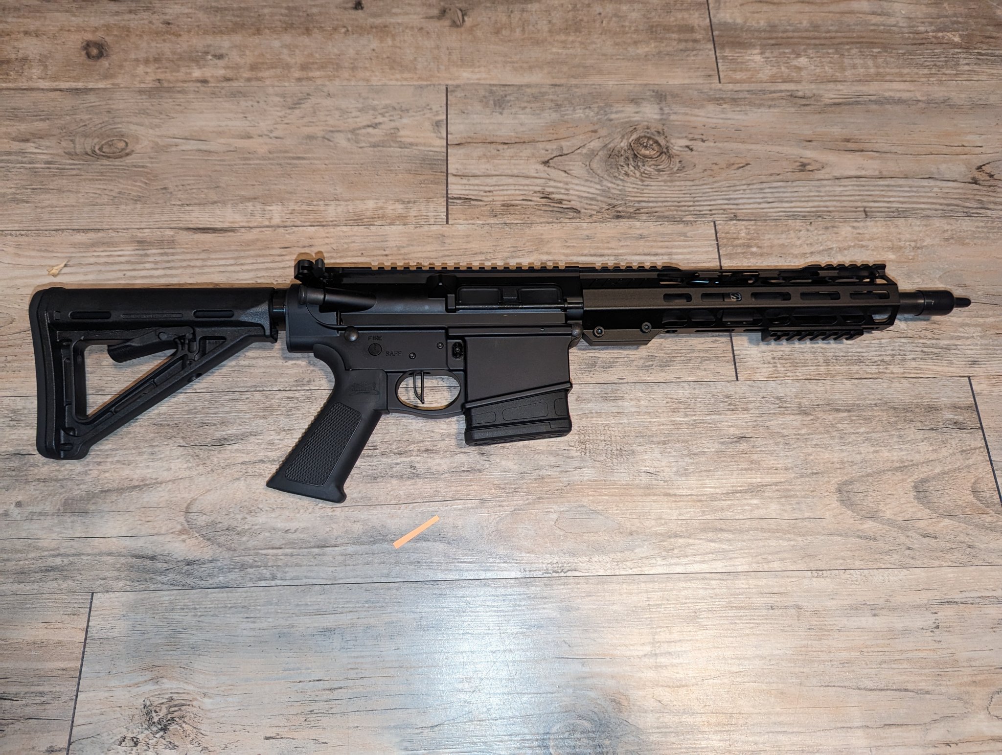

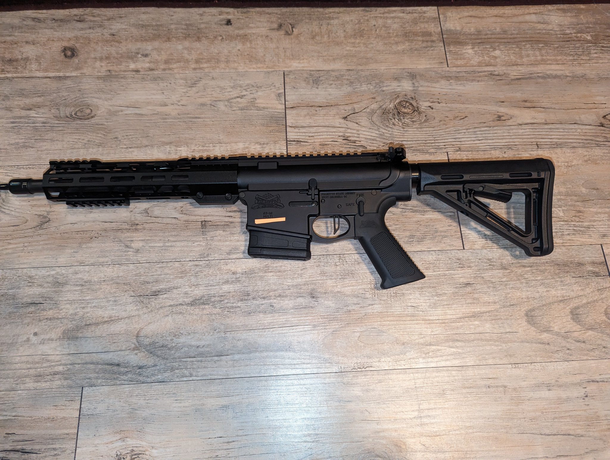

Got my tax stamp. Here is a picture of my build so far.
I have an Arken EP-8 and mount on order.
Gorilla cases 300 gr bullets
Finished my build. Q Porq Chop suppressor with cherry bomb muzzle break. 881 plus scope, mount, and suppressor.View attachment 8393873

A couple followups for you, based on your findings:
1) If you HAD to go with 1:3, what bullet/load would you settle on?
2) Have your 8.6 projects been builds, or complete rifle purchases? I'd be interested in ideas on a good starting point for a bolt gun receiver if you have any.
My best 3 twist Faxon AR load was 300 gr Berger 15.8 gr IMR 4198. No copper bullets were close to accurate.
I decided not to give up on the 8.6, because my barrel was crap, and felt the cartridge had potential.
So I had a Rem 700 action, that wasn't used, I trued it, ordered a McGowen 338 6.5 twist, ordered a PT&G 8.6 Blackout reamer, and an aluminum chassis, MDT mag, and a muzzle brake.
Also went to hybrid cases for extra protection when working up loads, so most any reasonable powder can be accessed and tried, because the 6.5 twist allows any bullet to run at max velocity, not limited to subs.
So I have tons of load data for a 6.5 twist, which is not all that helpful to 3 twist users...which I ran against my 3 twist with 160 gr copper Barnes...the 3 twist will never reach the velocities of the 6.5 twist, as brass starts to deform 3 grains down from the 6.5 twist with no brass case deformation from pressure, as tested on my two barrels.

I picked up an 8.6 barrel made by Ballistic Advantage, which has 5/8 x 24 threading. Playing the long game with this build as this is a "new" cartridge. I wouldn't doubt the further above posted criticisms are/were warranted at the time.
What seems important to know about 8.6 Blackout in mid-2024 is...
It remains a niche cartridge with its main usefulness being <300m big/dangerous game hunting and the fact that it'll run in SAs/AR10 platforms.
The 1:3 twist only works with bonded or solid copper bullets, and based on ballistics gel tests the rotational velocity is not a sales gimmick.
The industry is moving towards acceptance, hence barrels/complete uppers being made by more companies (QA still needed however).
Gorilla, Fort Scott, Aitken Arms, and Western are manufacturing ammo, with factory new brass.
There doesn't seem to be much point in getting into this cartridge without a silencer and a short barrel, so pony up for the ATF.
Rifle runs great. I only plan on using it for subs. I got some 300 gr SMK seconds from Midway. Cosing me . 50 a round. Still doing a little load development but I'm close to being done. Suppressed and subsonic is very quiet. I'm going to use 350 makers for hog hunting.
45-90, with as much ax as you have ground on the Faxon barrel thing, I'm amazed you have any more ax left...
To the OP, when you eventually decide to go a different route on the rail, White Oak makes a 2" inner diameter rail that is perfect for nesting a 338 can - I've run a few large bore AR builds that way, my TBAC 338 fit just fine.
They are hella fun to shoot and almost Hollywood quiet with subs and a good can. I didn't get the chance to punch a hog's ticket last year with mine, but that is a priority this year, for sure.
