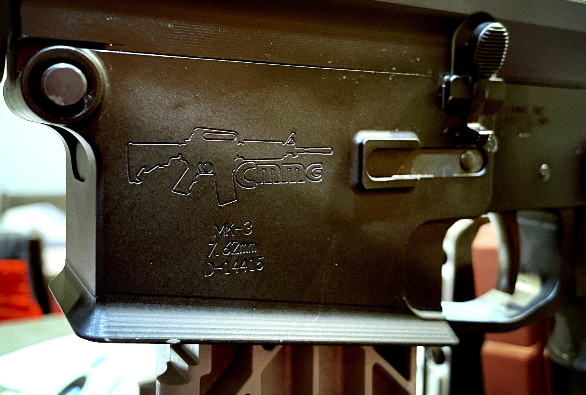

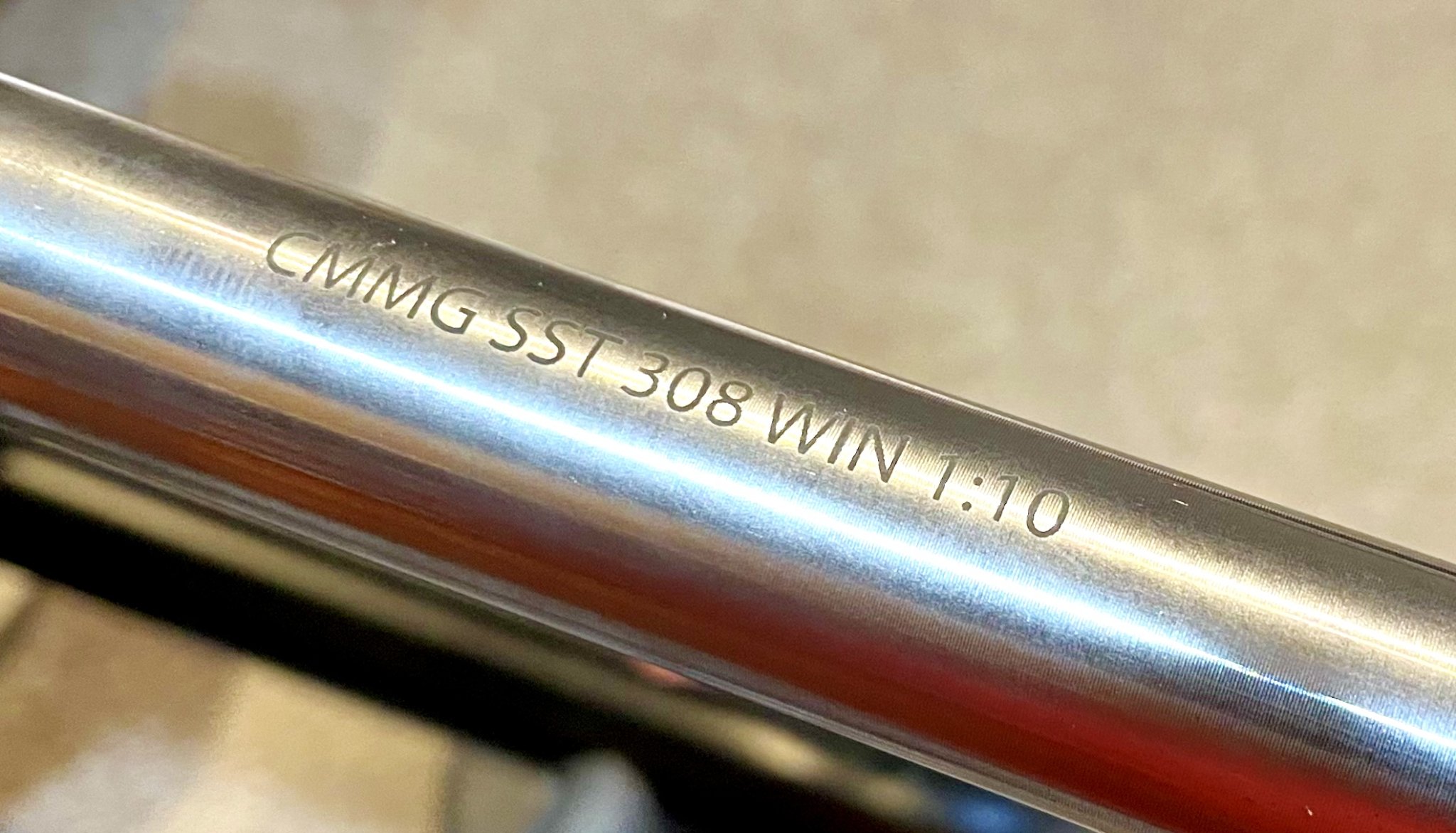

What specific brand barrel do you have ? And the make and model of the firearm would help.
Reactions: Makinchips208
No idea. Rifle was a gift. Need to disassemble it to figure out. Might as well change out the trigger for a CMC or Timney.

CMMG makes some great stuff... but I wouldn't consider it a match quality , ready to go, out of the box precision Large Frame AR.
CMMG makes a solid foundation to build on , if you so desire.
IMHO, it is in the "I need it to run reliably, and have reasonable combat precision level, at a fair price" group
Many Large Frame AR's manufactured are in that same group...and that is Ok with me ... then I can adjust, via parts, to the level / group I desire.
A better barrel would probably help ( and is a bargain in the current market, considering the cost of ammo ) with your odds of shooting to your desired level of accuracy.
Even a better barrel will increase your odds of better groups, but that doesn't mean it will like a certain ammo.
