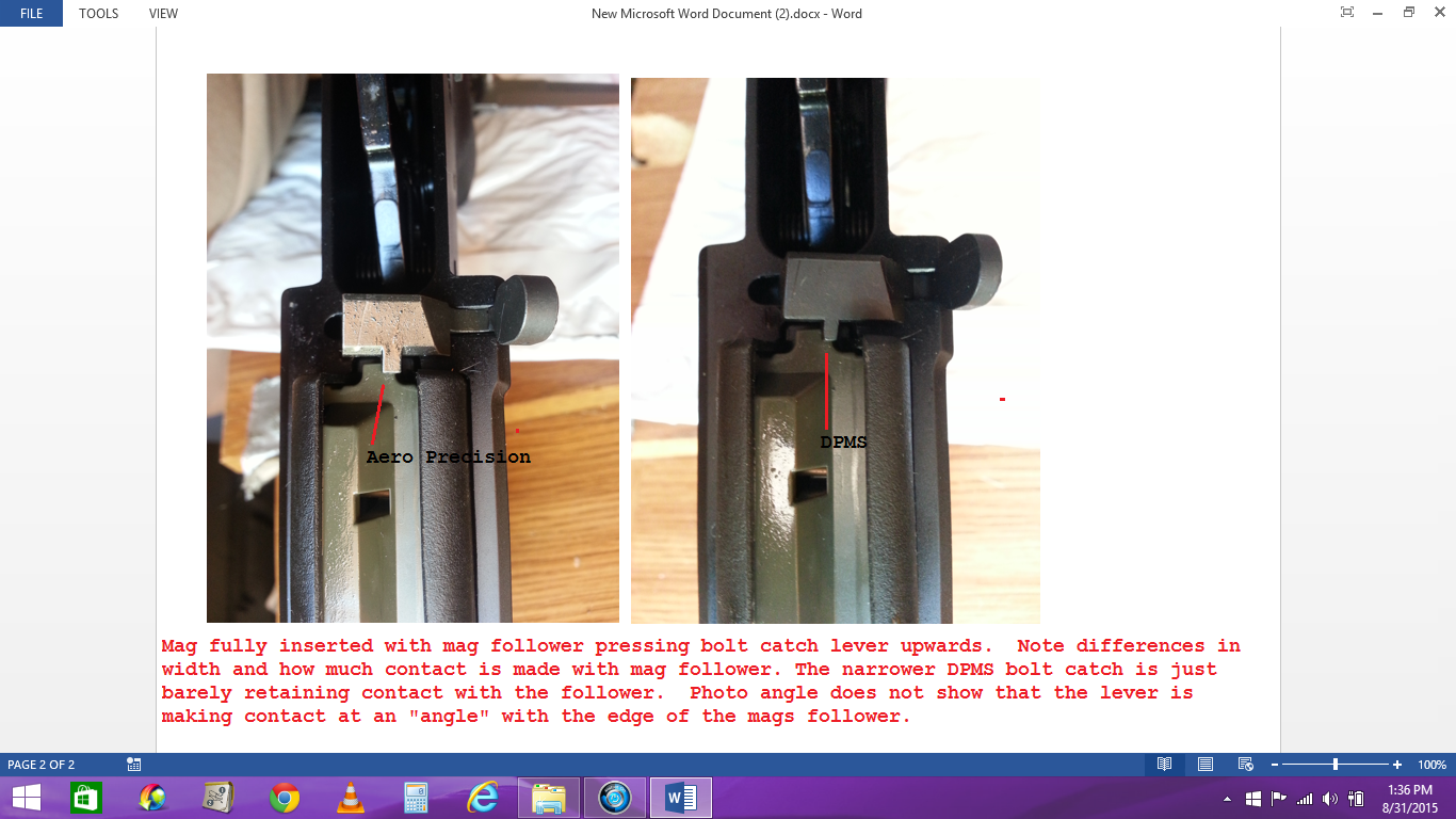

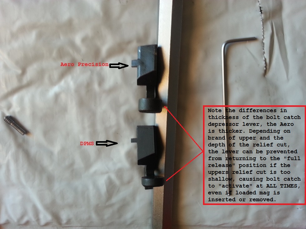

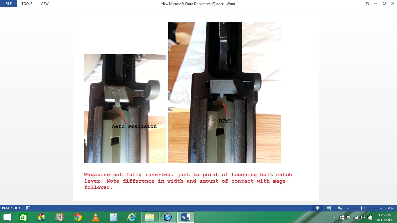

    ....if your not using the Aero AR10 bolt catch, that could also be the problem. I found that various "DPMS" pattern AR10 bolt catches have a very thin finger to catch the back of the magazine follower and can actually slip off the edge. Check out the attached pics and notes on each, might provide some useful info in resolving your issue.
    I actually replaced the bolt catch with an AERO which was the exact same that was installed. Now I have an extra LOL
