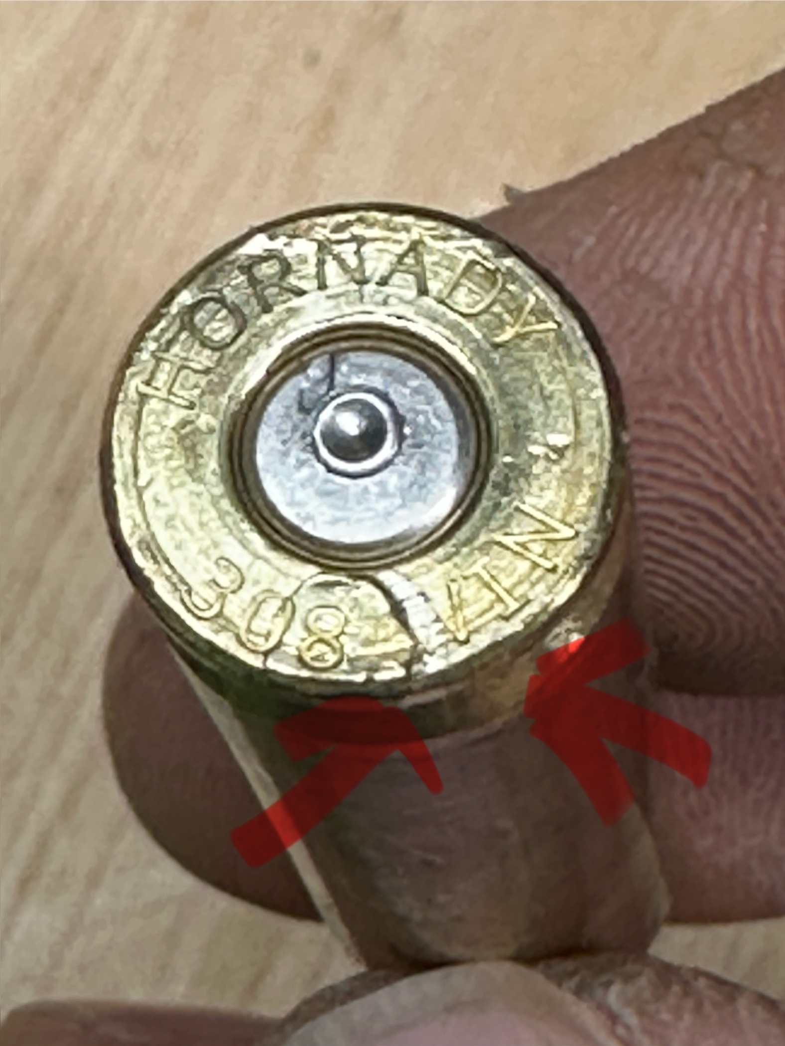

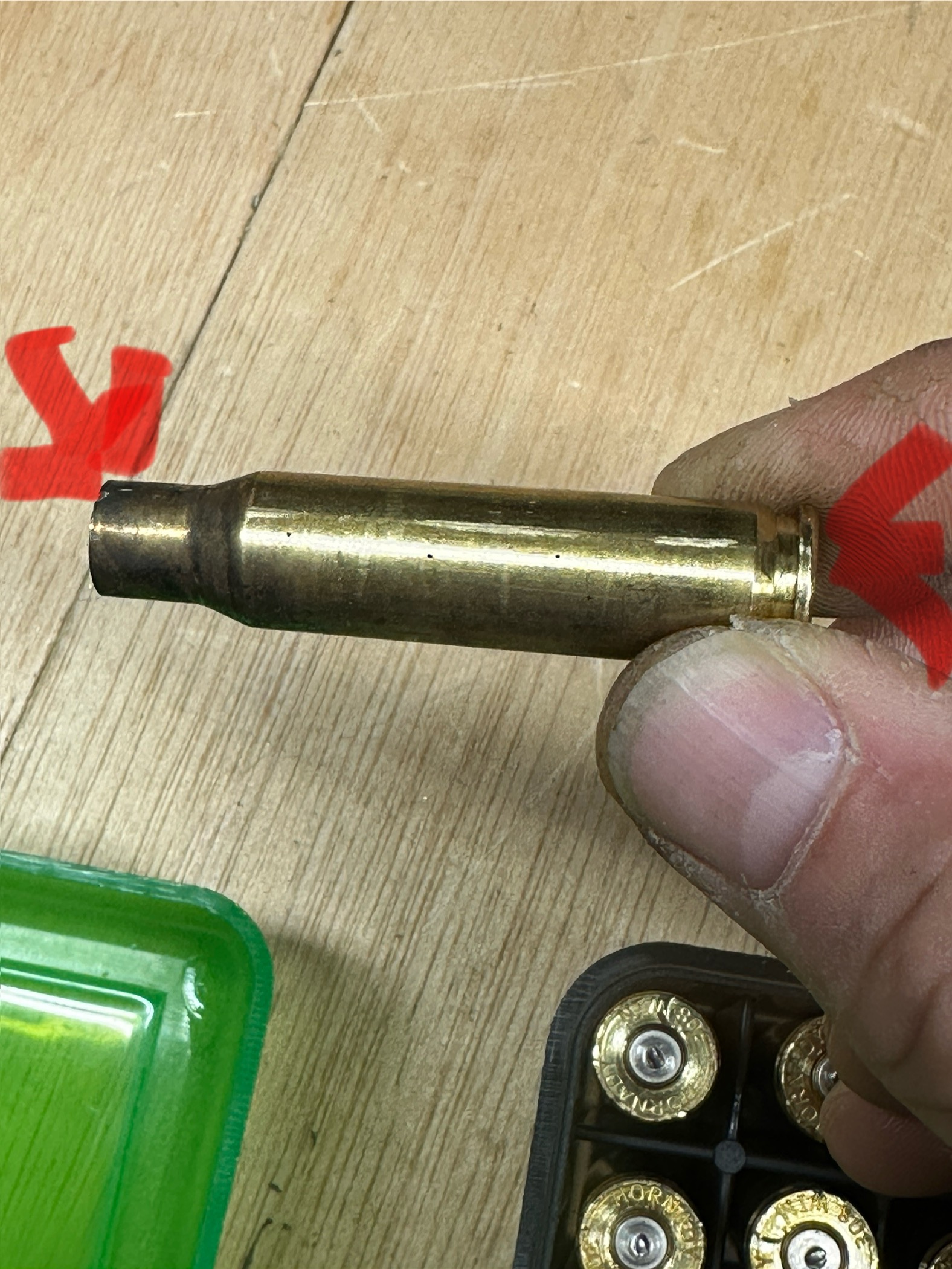

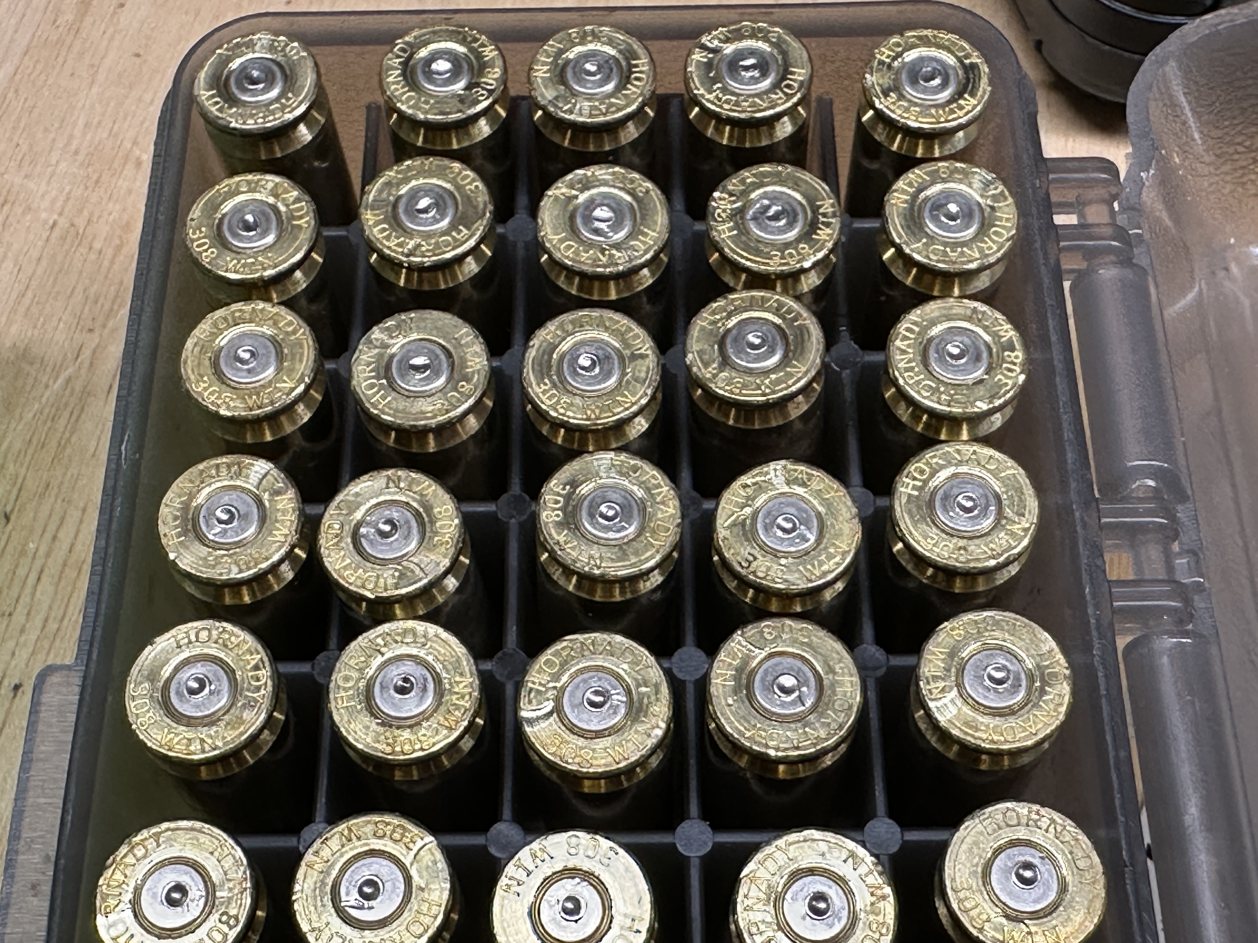

I am using new Hornady brass and after firing it once, there are lots of scratches and marks on the brass from neck to the rim. There are lines running along side of brass for the entire length of the brass. Rim and bolt face side of brass both have significant marks. My gun is gassed properly, I am using adjustable gas block and the brass is ejected at 3.30-4 o'clock. I have attached pics of the brass, can someone tell me if this is normal for brass used in 308 AR-10 and if not, what I need to do to reduce marks on the brass?

Is this happening to the next round in the magazine as the bolt strips the cartridge above, to the round being chambered as it feeds, or to the empty case as it ejects?
Have you tried a different magazine brand?
How does the feed ramp and chamber look? Polished? Sharp edges?
Tell us about the build and share pictures.
With the case lip nick and the linear gouge more or less clocking the same - I would speculate that there’s something off with the way / angle cases are being fed, and that there’s some interference from the barrel extension as it’s being slid in (sharp lugs?).

You have to determine if the scratch is happening on chambering or ejection to rule out mag issues or it's being caused by a lug.
It could be a mag related issue on the length wise scuffs. Get a black sharpie and color the brass and put one round in the mag. Load it and eject it manually. Do it from an open bolt to simulate a regular bolt closure. Eject manually and see if you can identify anything.
Repeat with two or three rounds or more and see if that's it.
What it could be is the magazine spring is still really stiff and it's putting excess upward pressure especially with a full mag. If that's the case then load up the mags to full capacity and put them on the shelf for a week or two. Its probably just the rounds rubbing up against each other in the mag.
As for the load, it looks way too spicy.
Too much powder in those rounds, Hoss!
Look at the cratering in the primer. Lighten up the load and dial in your gas.
Look for a load that duplicates the LC Match 7.62. Runs great in semi’s like AR-10’s and SCAR’s.
But you are not beating up your brass nearly as bad as you are beating up your rifle!

Have a Sig 716. All the factory loaded ammunition from Hornady look like that. It's soft garbage for an AR10. Cratered primers, and ejector swipes. Any other factory load from any other brand it's nowhere near as bad.

You have excessive pressure signs as well on the case head and cratering primers.

I put it together myself. Also, according to one post on another forum:
safe loads can have cratering. But it IS a sign that you are getting close to a place where you need to pay attention.
Cratering can be caused by:
1 - Weak firing pin spring.
2 - Thin or weak cup (CCI 400, Federal 200, and Rem # 6-1/2)
3 - Over sized firing pin hole in the bolt
4 - High pressure.
I am using CCI # 400 primers
AR-10 gas guns just hate brass. I average 3 reloads per piece of Lapua brass. Get used to it or reduce your charge weight. The size of firing pin can also contribute to your primers looking like that.

Its unlikely you have a weak firing spring as the trigger is actually the firing pin spring unless you made a major change to whatever hammer spring came with your trigger. For reference I use a Hi Speed National Match trigger with the match spring set, which is extremely light, with no issues.
All large rifle primers are pretty much .027" thick. The only real difference from manufacturer to manufacturer is the cup height. I use CCI 200s as my AR-10 primer, with many of my loads over book max.
This leaves 2 remaining issues which are likely the issue.
Oversized firing pin hole is a big problem. I use a Toolcraft bolt and while not marketed as a high pressure bolt, it's worked well. I do have some mild cratering, but nowhere the extent you're seeing. If I was really worried, I would probably swap it for a JP.
High pressure in combination with a large firing pin hole is really very likely the issue here. Add in Hornady brass which is a bit softer in the head, it creates more issues. I will say your brass is really beat up. Unless that brass has seen a lot of firings, it should not be in that bad of shape. You are seeing a lot swipes and marks, which tells me you're over pressure. Swapping to Lake City brass will potentially cost you a bit of accuracy, but I have LC brass that has seen 5+ firings that looks pristine in comparison to your Hornady, and I do run some spicy loads.
In conclusion? If you want to run heavy loads, buy a high pressure bolt but also reduce your charge. You never did say what your loading is, but from appearances you're hotter than you should be.

Also look at the brass flow into the ejector bore. There's some rounds there that are heavily imprinted with the round ejector hole. To me, that's a more sure sign of high pressure than the cratered primers.
Other posters have identified it but i'll chime in since I do a ton of precision gas gun work and PRS gas gun loading.
First, you have an old school oversized firing pin hole and firing pin. This isnt a problem in and of itself but it is going to mark most primers in loads above ~55-58k psi chamber pressure.
Second, you are using Hornady brass, which tends to be soft and easily flows into extractor grooves and get blasted into ejectors at higher pressures.
Third, you are running those rounds hot hot hot. the ring around the brass is from the case being driven into the bolt face HARD from pressure.
If you are going to do precision loading in a gas gun you really should be using tough brass like FC and utilize a high pressure bolt. Tuning with weights is generally required for the best results, you can buy tungsten and swap them into your buffer until you get the speed right. Most gassers really need a LOT of mass in a large frame to operate at tolerable speeds and to make brass last. You can also match this with a stiffer spring to slow down the cyclic rate, which will stop the extractor from yanking the rims.
Dont forget to size your brass with a RCBS small base die to bump those heads for smooth chambering and ejection. One thing that's common with gas guns is the head grows after a few firings and will no longer chamber freely and under unlocking will stick. Clickers in a bolt are bad, clicking at the case head in a gasser is a sure way to tear brass heads and rims off.
If you use a small base sizer die to bump heads, use tough brass, and tune your gun, there is no reason to not be able to get 10+ firings out of your brass. I shoot a JP LRI20 with FC brass and the brass still looks immaculate with the same set of 200 on its 15th+ firing. Alpha brass works too and has a tougher case head if you want to upgrade.

It looks to me like the lugs in the extension are probably sharp. A lot of cheaper barrels will not have the sharp machined corners of the lugs and feed ramp cuts softened. And yeah, you are also running high pressure and likely don't have the gas system sorted.

The long longitudinal scratches are probably from your magazine feed lips.
Your primers have a raised rim around the firing pin indent but your primer cups still have a radius and are not flattened, while the case head has flowed slightly into the ejector hole.

I don't see any major problems yet. Use a small base sizing die and change out to military Lake City, Winchester, or PMC cases and see if you get the same markings.
Reloaded brass doesn't necessarily get softer after firing and reloading ... it typically work hardens over time, but it may become thinner in certain parts and we're not seeing those issues so far in this thread. I don't think the issue is "soft" casings, but rather more a Pressure issue. Check chamber dimensions, resizing dimensions, loading pressures, etc..... likely some combination of them all.
Small base dies may be occasionally necessary, but usually only when you are seeing the web of the case grow to a point that is out of spec. I run a lot of Hornady brass through a standard resizing die multiple times without issues through my 308 and all of the other various calibers I shoot through the AR platforms... for me it's only an every now and then issue.
I would start solving this in a few steps ....
  • Back to factory ammo and see the results .... if that exhibits the same over pressure and case head issues, I would review my chamber dimensions (or have a gunsmith do it).
  • If factory ammo worked fine I would look more into the resizing of your fired cases (I wouldn't randomly reload range pick-ups - brass fired in your own chamber will become a better fit).
  • If your chamber is a little oversized (whether from reamer or poor procedure/set up or whatever) your brass may not need to be sized down or neck pushed back as far as you may think.... only the chamber and brass will tell you if you have the right fit/tolerances. Aggressive sizing can cause just as many issues as undersizing, just different symptoms. Bottom line is adjust your resizing to fit your chamber.
  • Double check your seating lengths as well
  • Without a doubt, I would back down on the pressures until everything is resolved.
  • If you're running an adjustable gas system, I'd adjust it as low as possible while making sure it still functions 100%. I don't think your pressure issues are related to your gas system
