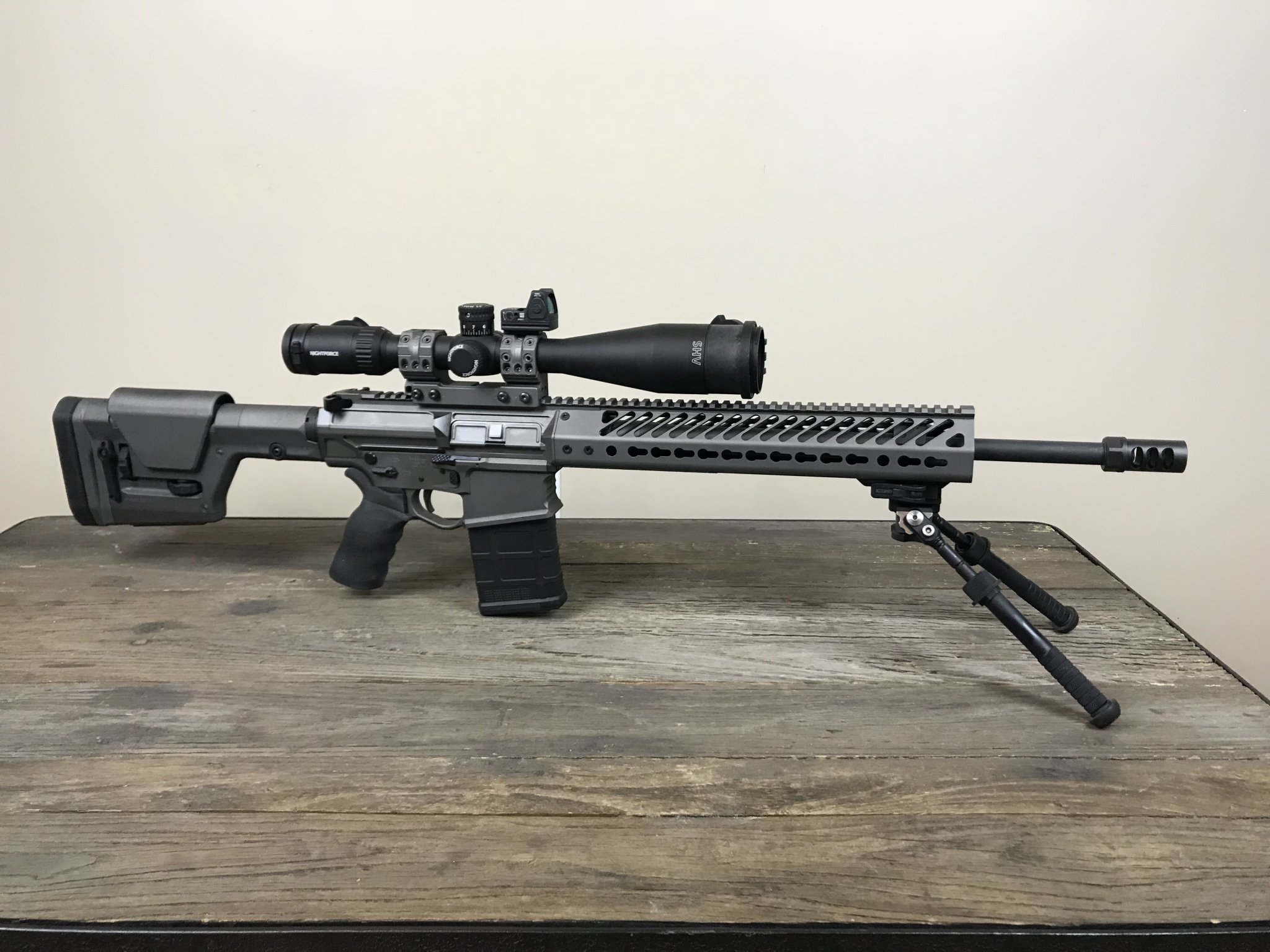

Here’s mine on a large frame AR (Seekins SP10)....with the PRS stock, eye relief is fine, I’m 6’3 with longer arms as well
