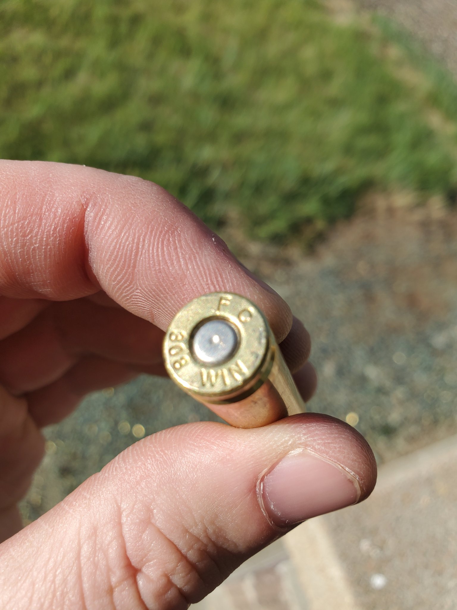

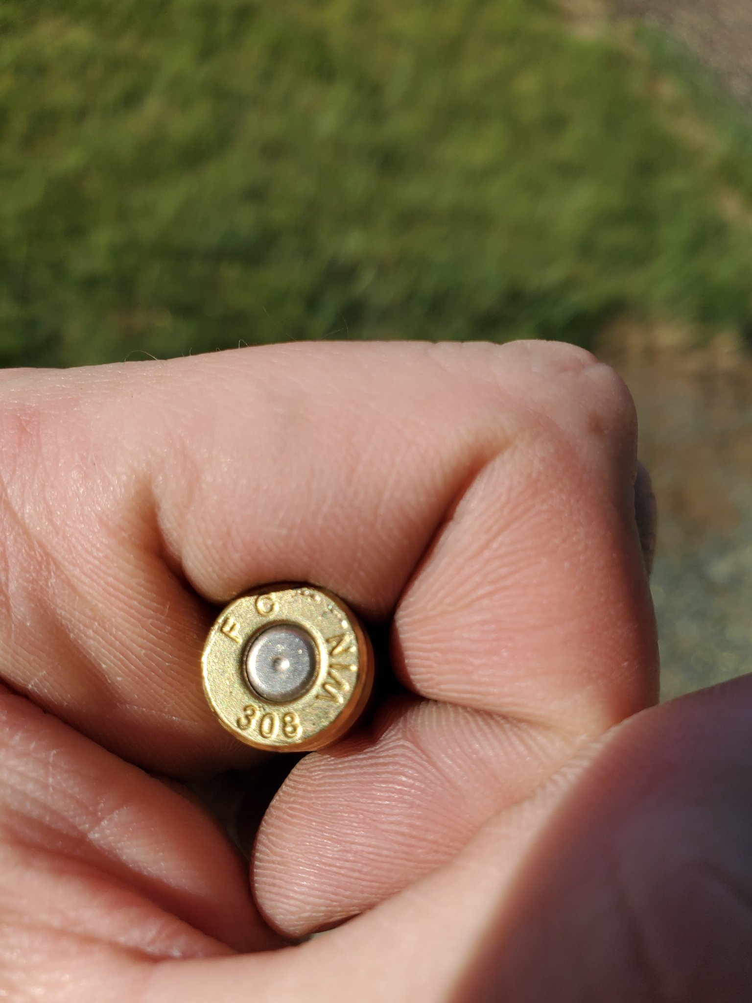

I put a Aero upper and Ballistic advantage barrel together and am getting light primer strikes here and there. Put the heavy spring in the Larue 2 stage, still happens. Most rounds fire but every range trip out of 3 had a few light strikes. New CCI 200s with varget, no issues in other guns.
I have resized brass fired from the chamber and was not able to bump the shoulder with the die touching the shell holder. I also noticed a little bit of soot on the shoulders of some of the rounds. If I rechamber a round that failed to fire, they always fire on the second try. Headspace probably? Its an Aero M5 bcg. Ballistic advantage 18" hbar 308. I need a new bolt or a new barrel if thats the case right?

The primer looks the same as if I had just chambered the round and ejected it.
Keep in mind 90% of the rounds fire and function fine.
