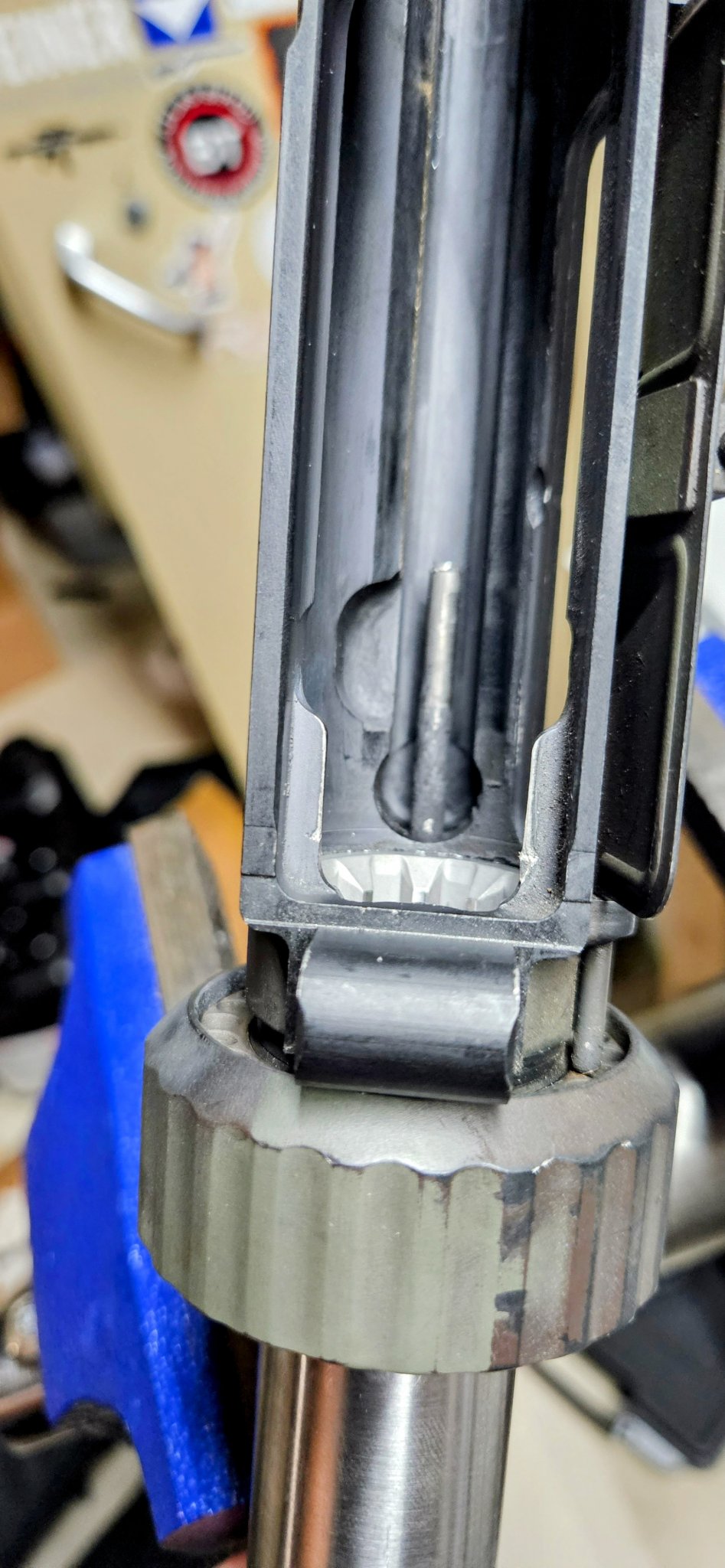

I am working on an Armalite SASS with the finger-adjustable gas block. It's a rifle-length tube in Armalite's standard. The barrel was changed out with an 18" Proof Research, on the LR-308 standard. Since the LR-308 standard gas system is a little shorter (by about .365"), the gas tube protrudes further into the upper receiver, just past the cam pin recess.
The BCG closes like normal, and the gas tube is NOT touching the gas key or pushing the BCG back at all. Certainly if it was, the gas block/tube would have to be changed. But since it's not, is this setup good to go?
Hard to tell for sure with your pic, but the condition of that gas tube does not look good (not talking about the crud). I am surprised that it didn't bottom out in the key. Even if it fits, the increase in tube to key engagement time may cause issues. Are you using the old ArmaLite bolt or did you change it to the DPMS spec, like your new barrel? Either way, I hope it's been headspaced.

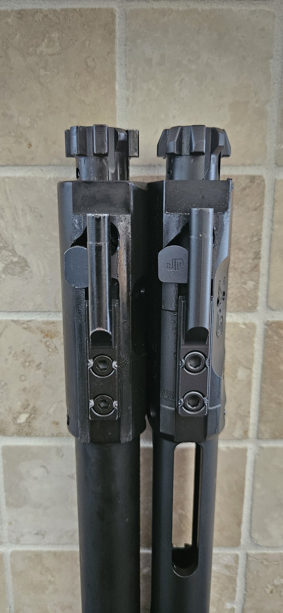

It's too far for me too. The AR-10 BCG's gas key is set a bit further back than the LR-308. The photo below shows the Armalite on the left, and a Sharps on the right. The Sharps binds on the gas tube; the Armalite does not. The Armalite probably would work but I would be inviting other problems.
