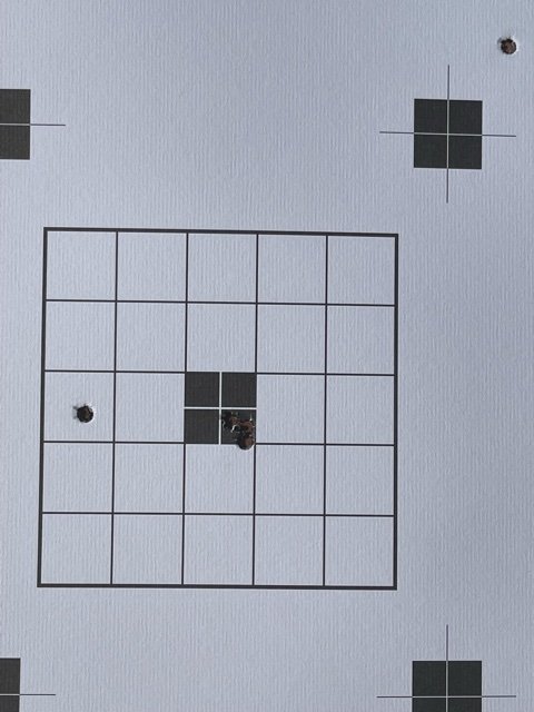

Today's results: The first two shots are for zeroing the scope and the next three:
(Indian Hill Shooting Club: 100 yards using Caldwell Lead Sled on Bench)

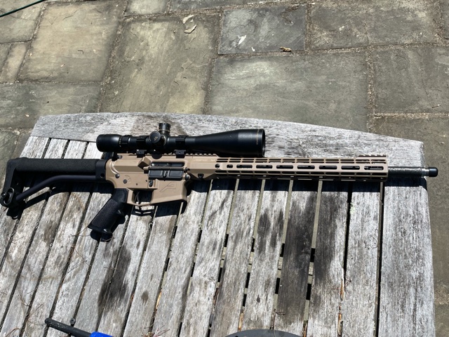

My build:
1) Proof Research PR15 6mm ARC 7.5 twist 18"+1
2) JP Rifles 6.5 Grendel Bolt & BCG
3) JP Rifles SCS
4) JP Rifles low profile adjustable gas block
5) Aero Precision M4E1 upper, lower, trigger and lightweight handguard

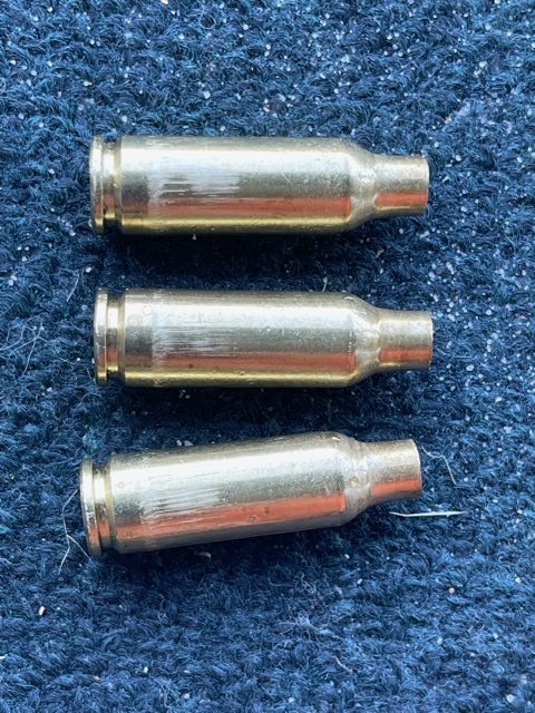

When first fired, the casing jammed badly in the chamber and had to be pounded out with the Strike charging handle. Here are the casings:

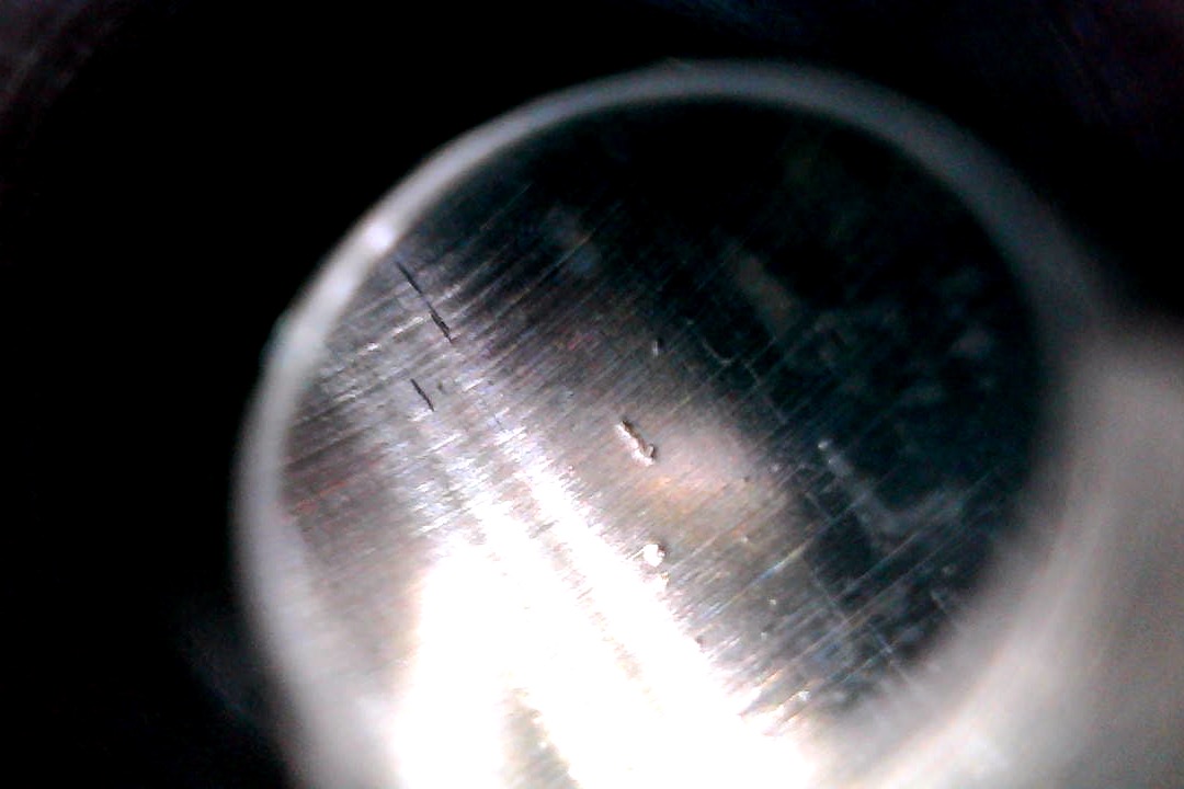

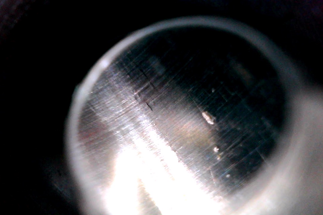

Through the Teslong bore scope there are some burrs in the chamber:

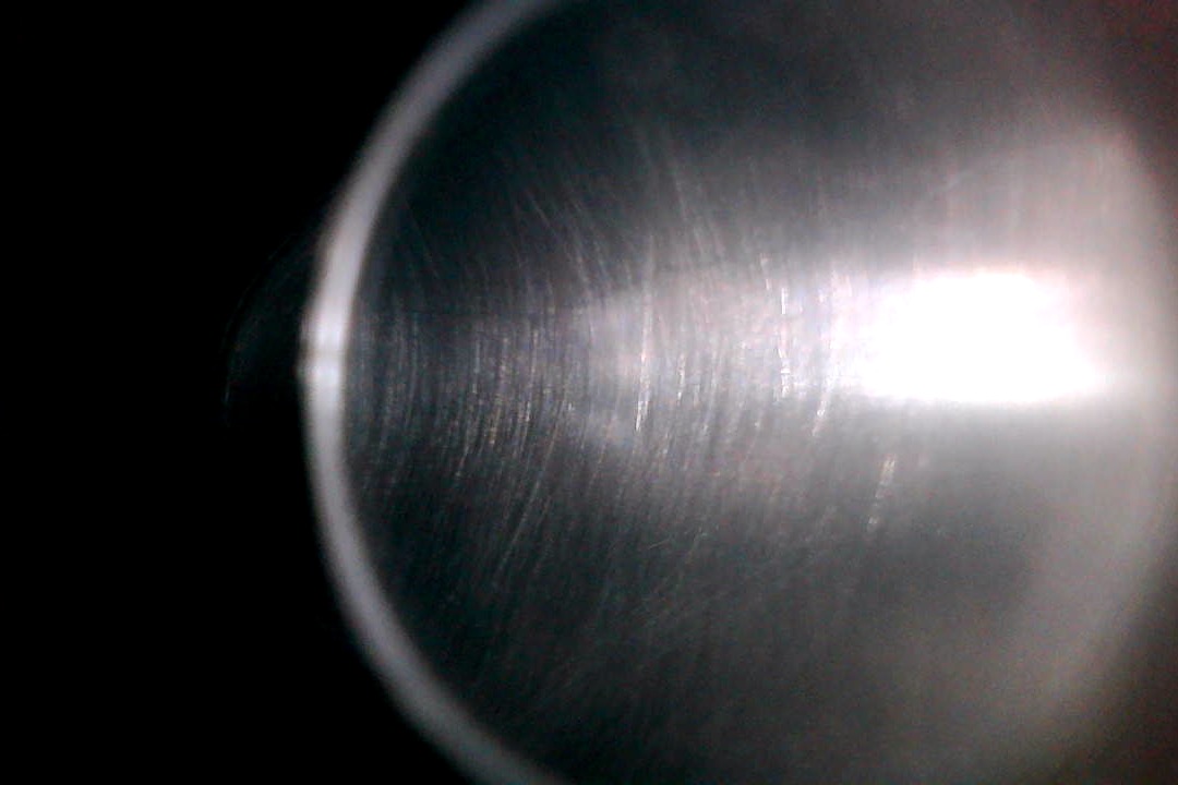

I cut a slit in the end of a dowel, inserted and wrapped 600 grit sandpaper, and polished **the heck** out of this. It took me several tries i.e. polish then shoot and really I had to polish more than I expected. I was worried that I polished too much but today it worked and the accuracy is terrific!

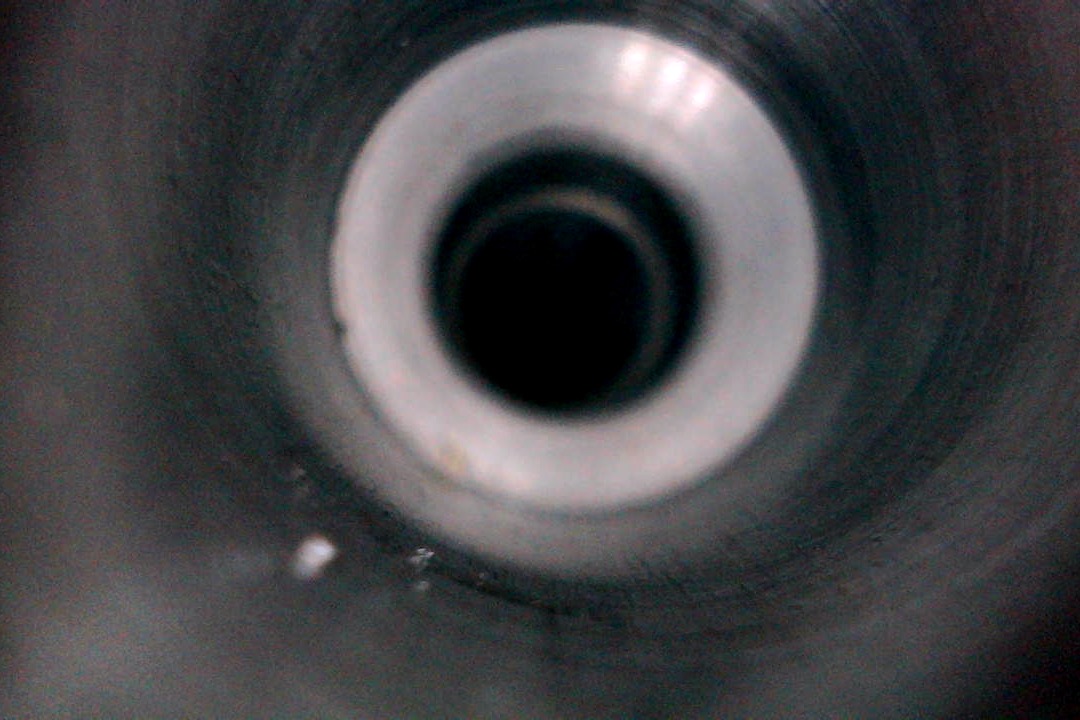

I also used a Dremel to polish the interface between the feed ramps on the barrel and the upper. The AR-Stoner/ARC magazine is working great.

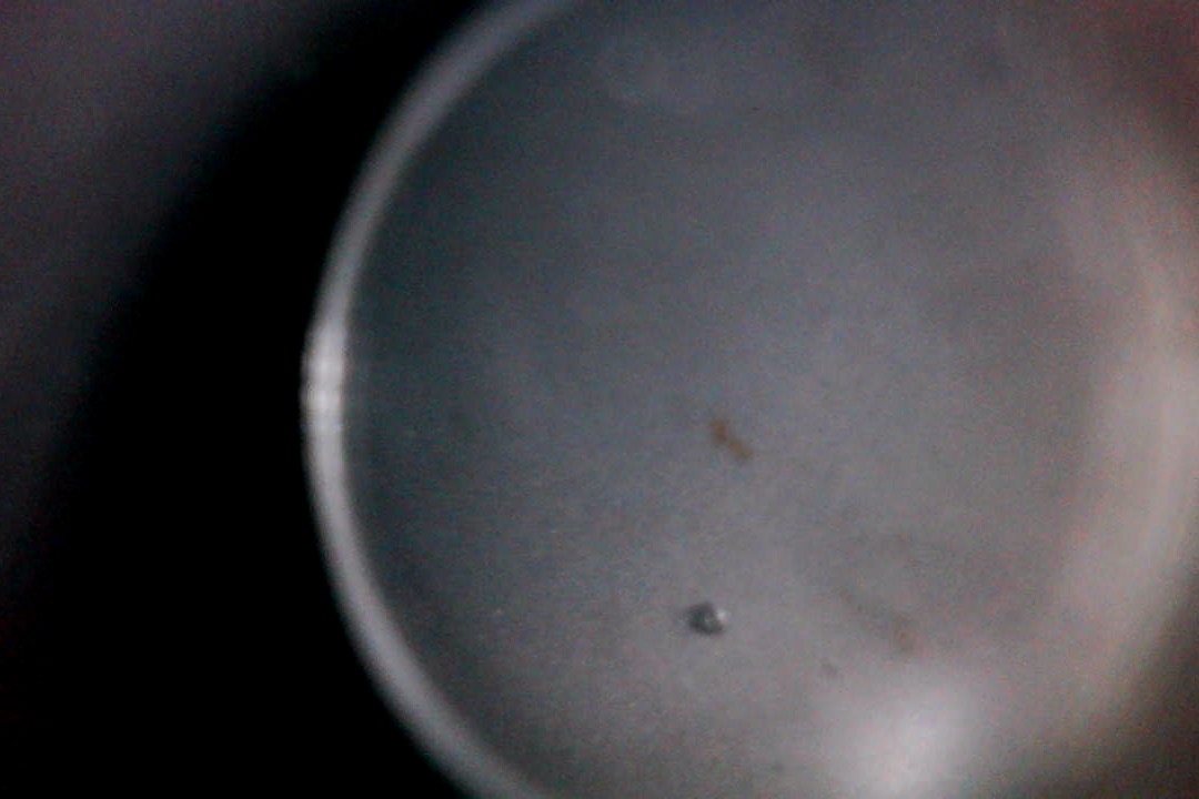

I don't this issue is unique to Proof Research. Here is a brand new Aero Precision barrel (16" M4E1):
There were a few more jaggies but the photos turned out out of focus...
and then after polishing with 600 grit sandpaper:

Now that I have borescope I’ll do a better inspection before I put together.
Are you sure that’s a good idea?
Not all of the pressure from a round is exerted directly into the bolt face. Some of it is held by friction between the case and chamber walls. Polish a chamber too much and you might see an increase in force pushing on the bolt. Considering 6ARC is already tip toeing on the edge of bolt strength and you may be affecting fatigue life of your bolt.
I don’t know what the surface finish call out on a chamber is so 600 grit may be just fine, but something to double check.
ETA: I think you’re ok with 600 grit. You’d have to polish to very fine for significant impact.
Good considerations. If you look at the casings you see that the markings were along the lower or proximal 1/2 of the casing. I concentrated my polishing there. The round mostly grips toward the neck. The 600 grit isn’t mirror smooth (see the photo) and I’m guessing that’s why it’s considered a good compromise. I did use the JP EnhancedBolt 6.5 grendel but if pressure is seen as an issue perhaps they will make a HP version for 6mm ARC.
