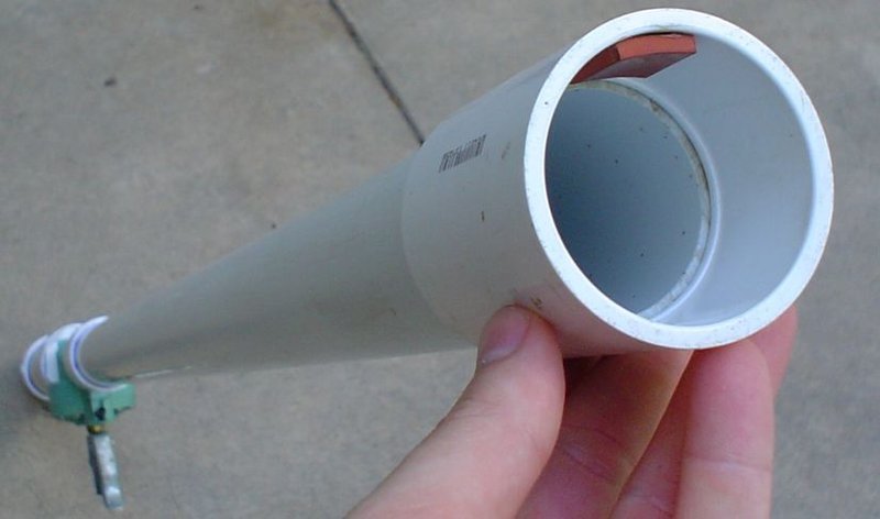

So my question would be how do you add a little bit of rifling to a golfball launcher?
If not rifling, could you add backspin- aka Airsoft Hop Up?
Start with a long tube and give it a slight bend like in airsoft?
Or could one polish the bottom edge to reduce friction... as the golf ball moved down the tube, it would pick up back spin from friction?
The speed, I think, is based upon the charge and the PSI from the barrel. I do not think the length of the golf ball holder makes a difference as gas is venting to the gas port....
lots of playing could be done... to make it more.. entertaining
https://en.wikipedia.org/wiki/Hop-up_(airsoft)#/media/File:Hop-up_animation.gif
In airsoft guns, this is usually implemented as a projection (called a bucking) into the path of the projectile, on the top of the barrel. The bucking momentarily hinders the top side of the projectile, imparting a backspin that can exceed 120,000 revolutions per minute. This is usually adjustable so that the effect can be tuned to suit the weight or speed of the projectile and each player's preference.
could one bore a hole or square into the top of the launcher and insert a rubber or sandpaper flap a few thousandths to make a bucking? or an adjustable bucking?
https://upload.wikimedia.org/wikipedia/commons/0/0c/Hop-up_animation.gif
