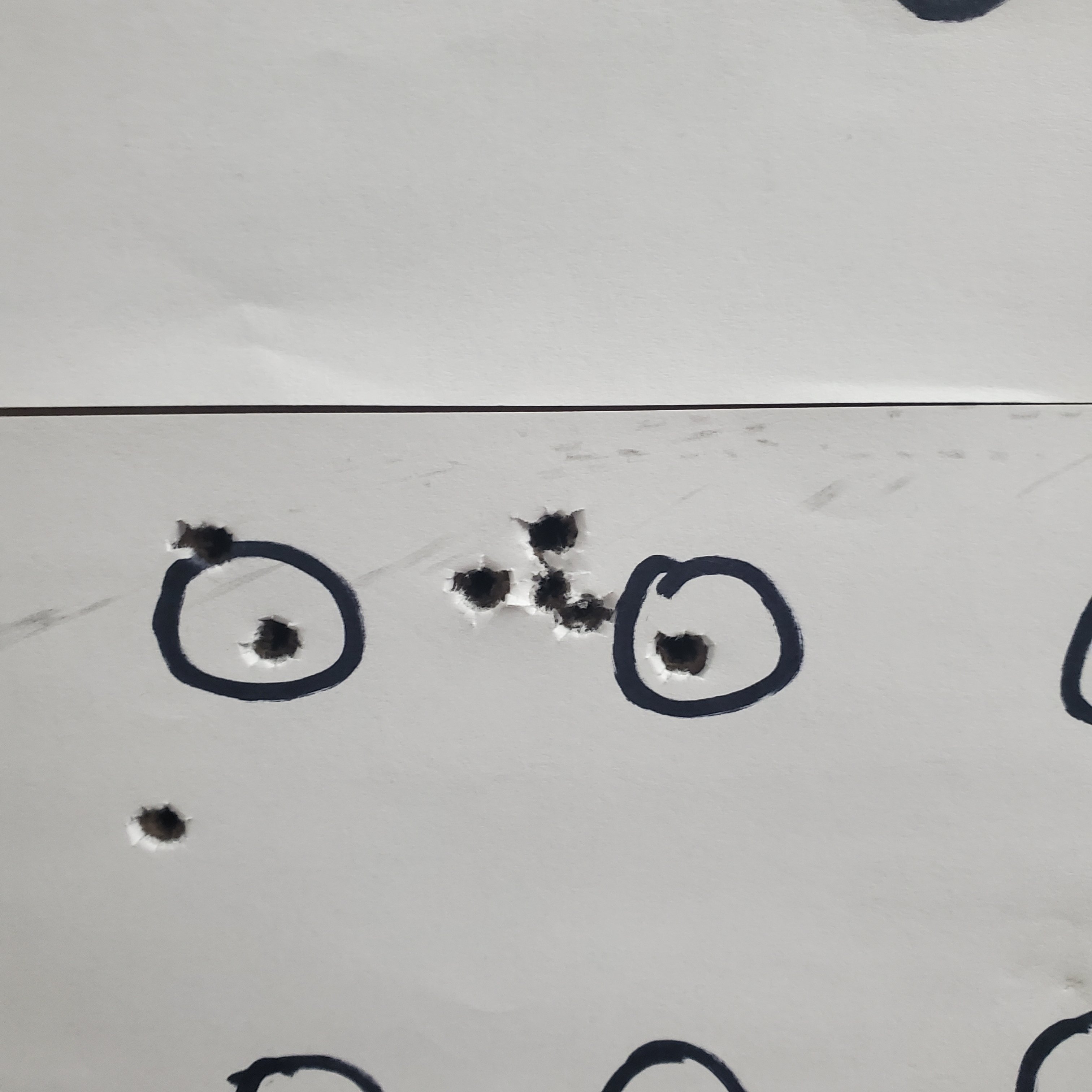

My Criterion not sure if it's core or hybrid contour. It's chrome lined .750 contour, it heavey. Shoots decent ammo into 1 moa.
It's hybrid contour after reading above.
Shot the four then adjusted the zero where I wanted it. There are actually 5 shot at the circle on the left also but that was kneeling once I had a zero.
