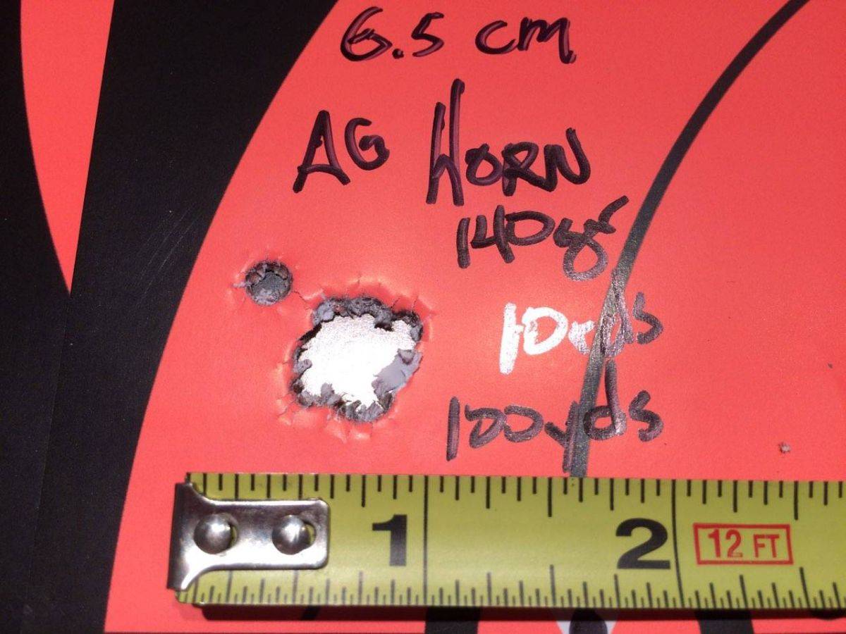

My best group to date from my 6.5CM 22" Criterion barreled PSA upper and lower. Shows the barrel can out shoot me. ( The flyer is my fault 100% ) 10rds Hornady 140gr AG , 100yds , scoped, benched .. etc.
Assm. tricks listed above used.
Yes, Cherry picked... I am proud of the group.
