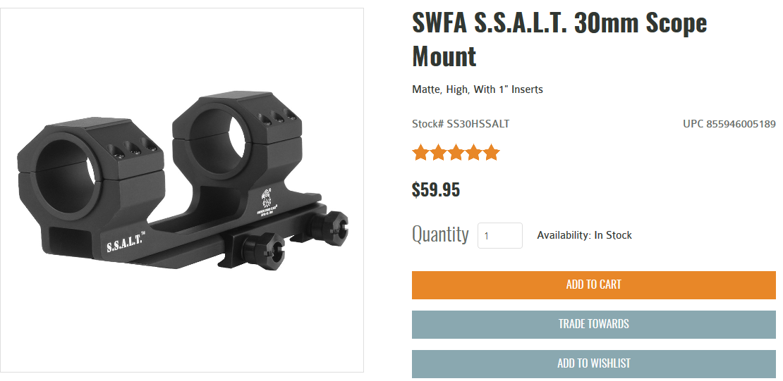

OP if your on a serious budget & don't need the quick release feature. I wouldn't hesitate going with the SWFA for $60 bucks. Pretty stout & not bad looking either.
I have one sitting here that will be going on a .224 in the next week or 2.
