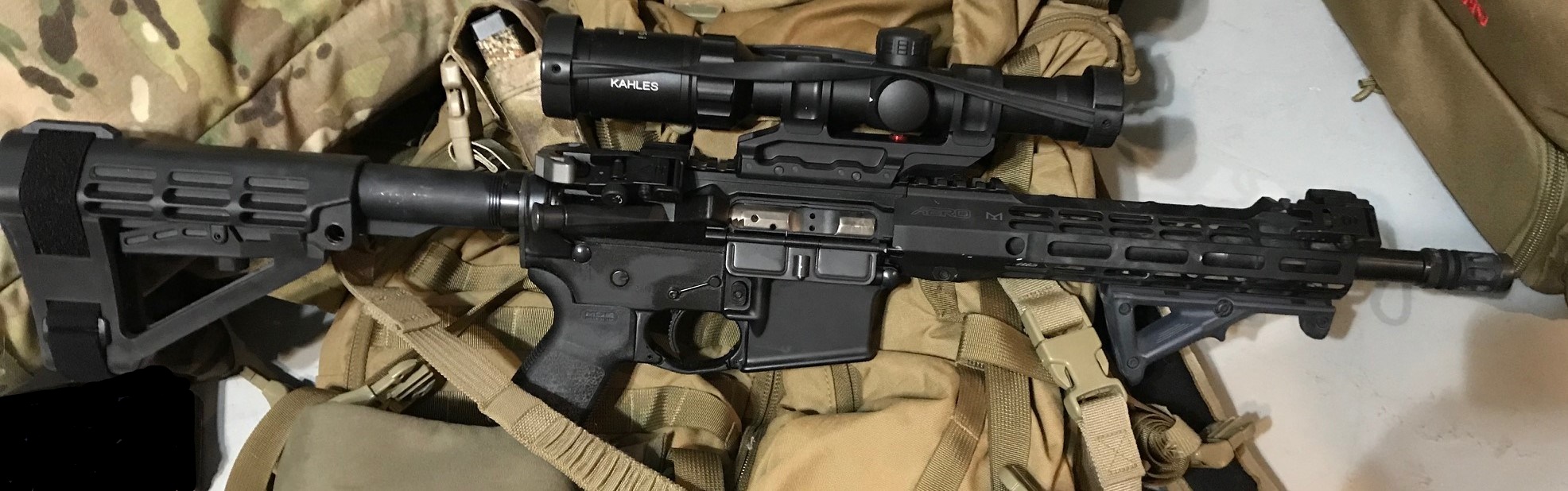

I picked up a Saint Edge a while back. I haven't shot it a lot, but it has functioned flawlessly and fun as heck shoot. I slapped a Steiner 1-4 on top, handy little setup.
Build it.

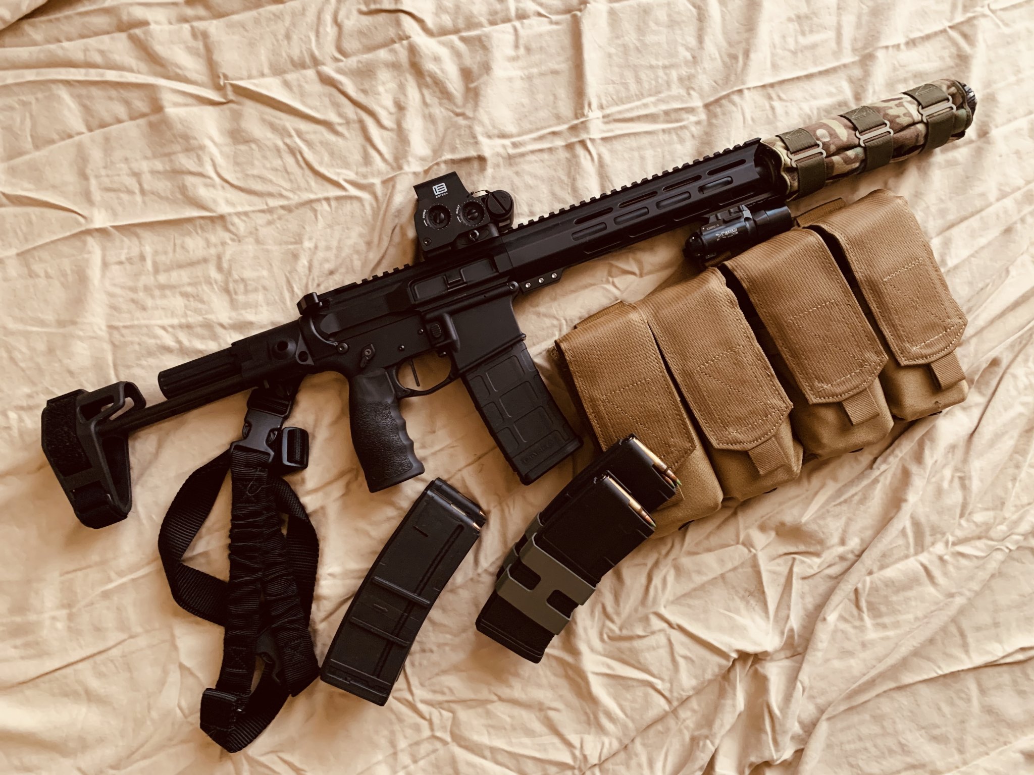

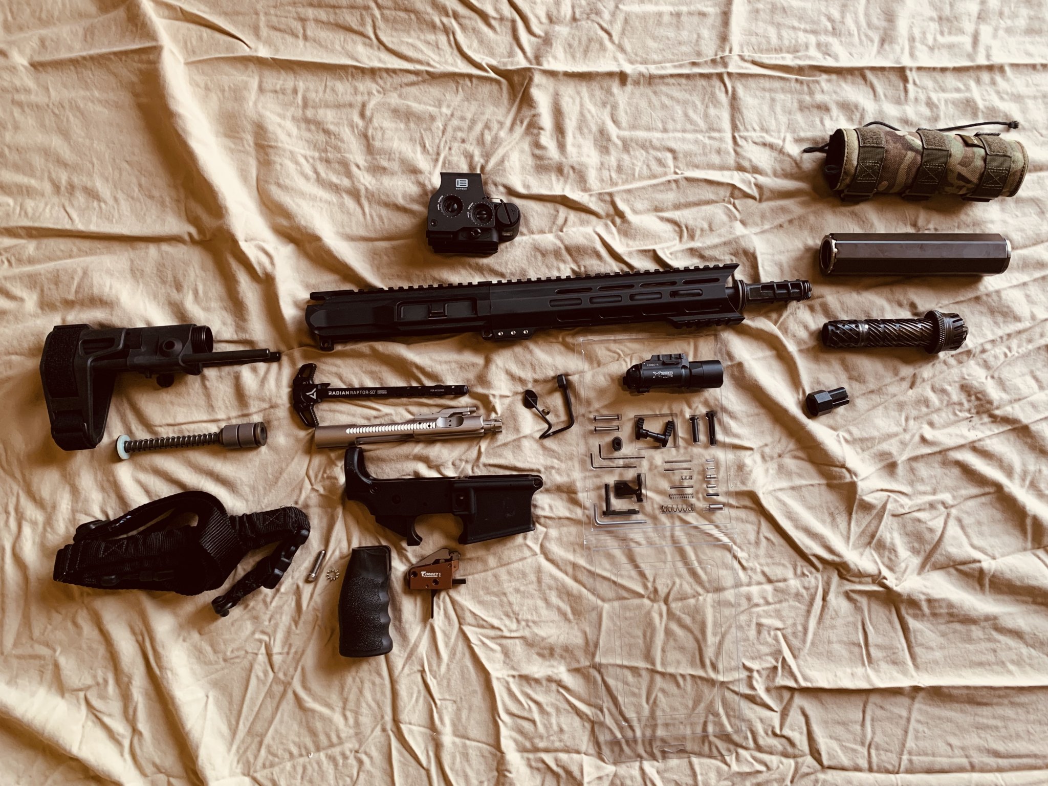

The upper was built by a local gunsmith; 10.5" barrel 1:7 twist 5.56 chamber. the upper is a billet without the forward assist. I think it's a Midwest handguard with a C-cut in the end.
Anderson Lower
OSS IFM6 suppressor
Cole-Tac Baby Python suppressor wrop
Nickle Boron coated BCG
Radian Raptor SD charging handle
Maxim PDW arm brace with JP heavy silent capture spring buffer
ARMS builder pack w/o trigger
Timeny Daniel Horner trigger
ERGO vertical pistol grip
EOTECH XPS 3-0 sight
Blackhawk singlepoint sling
Sure-Fire 1000 lumen weapon light

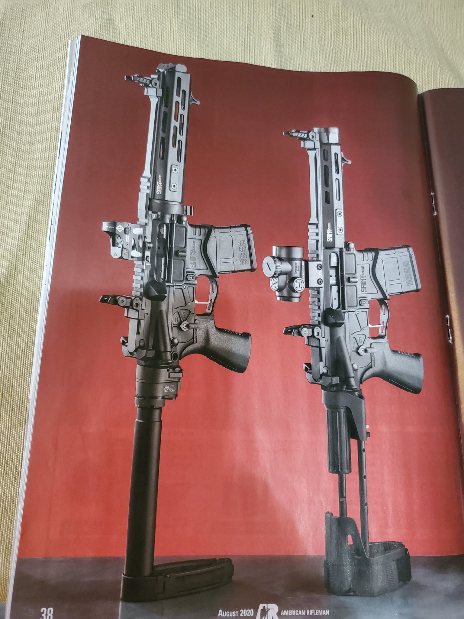

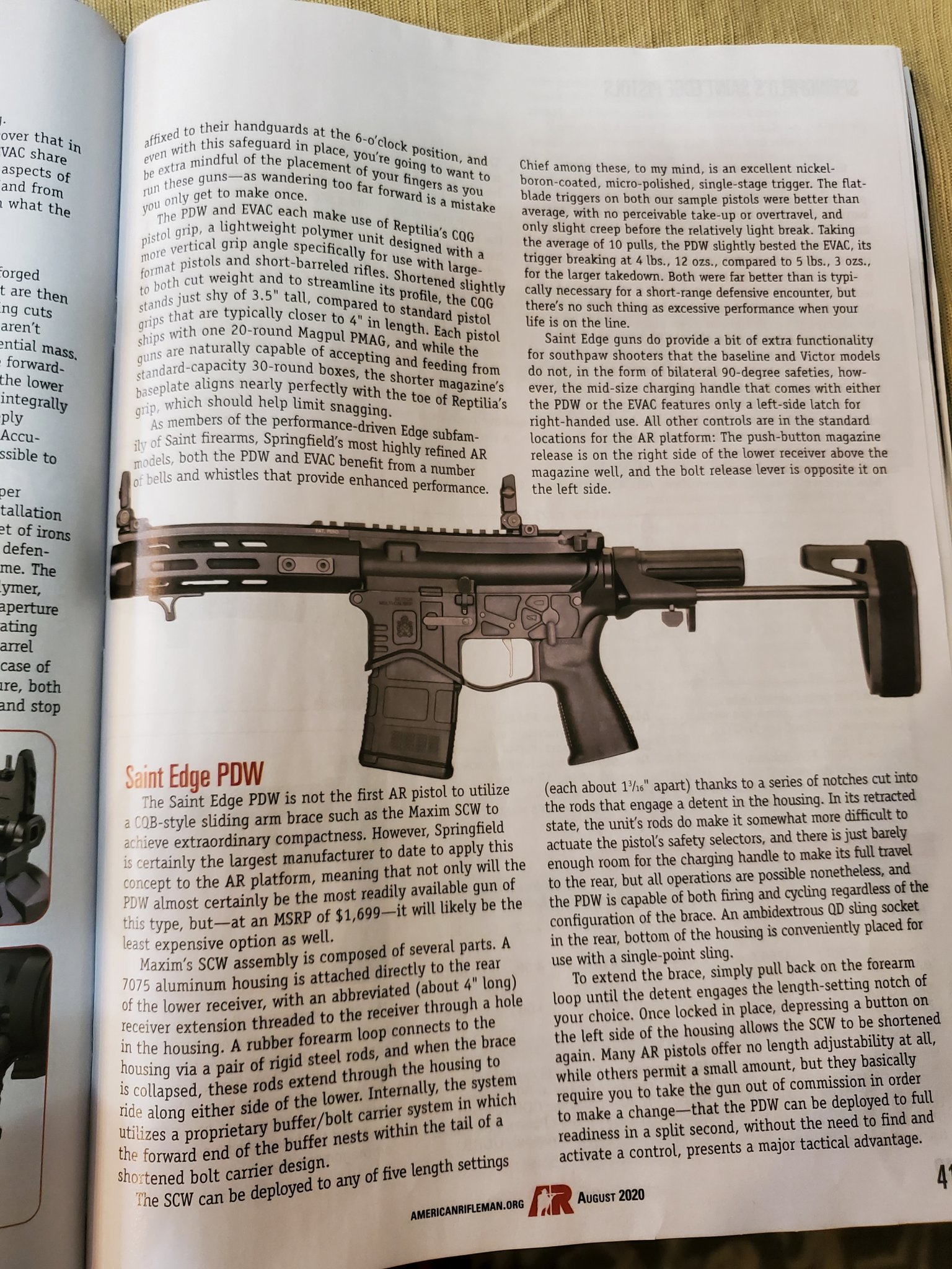

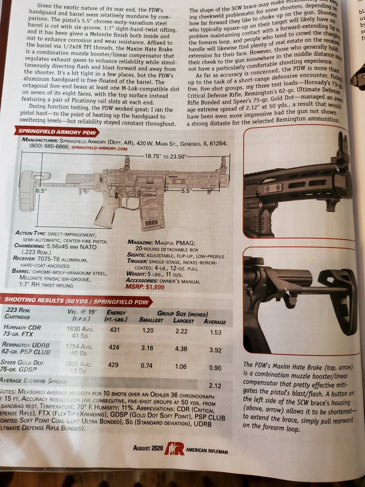

Someone brought me the issue of American Rifleman which had just came in mail this past Wednesday.
It featured 2 new Springfield pistols:
1.the PDW (Pdw brace and lots of other goodies)
2. The Evac (main points are: law folder AND Dolos quick detach barrel nut)
I'll attach a few pics

5.56 in a 5.5” barrel? No thanks.
OFG
I have a 4.5” .22 lr upper that i shoot in a pistol configuration and love it. So much so that I ordered a 4” 9mm barrel from Craddock for my Quarter Circle 10 9mm lower. Having said all that, couldn’t agree more regarding a 5.5” .223 barrel. It’s just a bad configuration for what was designed to be a rifle round.
