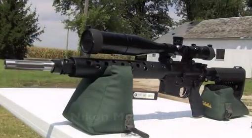

I bought a Colt LE6920 M4 last fall that I installed a Geissele SSA-E trigger and ordered a complete WOA 18" varmint upper with a 1 in 7" twist for more accuracy and longer range with 69 grain Sierra Match King bullets. I also am having the barrel full length fluted to save some weight. It should look similar to this.
http://www.whiteoakarmament.com/xcart/product.php?productid=17555&cat=261&page=1
