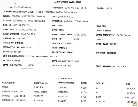

Data card for federal 7.62 special ball, Long Range. This is where I would start...
Reactions: Seymour Fish

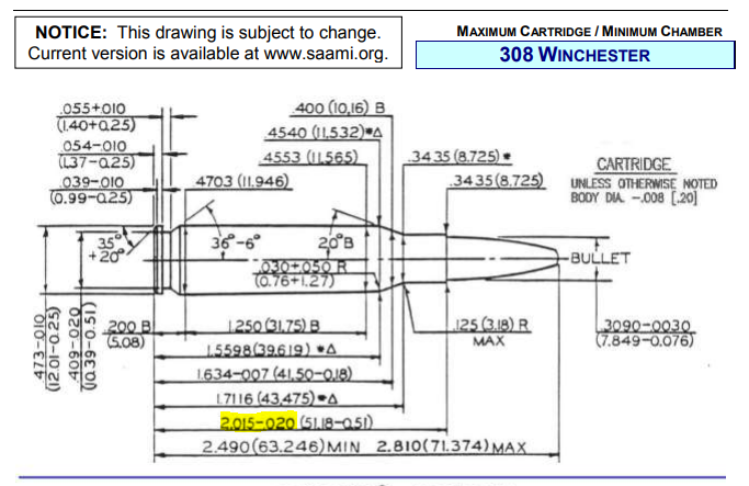

How do I determine case length? I’ve seen people talking about OAL but not case length. I have some reloading books but none of them talk about AR’s. Should I use the same case length for a bolt gun or is there another website I can go to. Y’all have been a great help so far. I’m trying to soak up as much knowledge as I can get from y’all!
I love my AR10, it shoots incredibly well. What took the most time for me was finding the right seating depth... it can be challenging because of the limitations imposed by the mag, can't seat close to the lands. I found the ELD-Match seated to .110" jump works best in mine.
You can use a chamber length gauge to find your maximum length allowed before trimming is necessary.
I and most everyone else just go by the spec.
Saami spec is 2.015-.020 so anywhere from 1.995-2.015 would be acceptable. Most shoot for the middle so I would trim to 2.005.

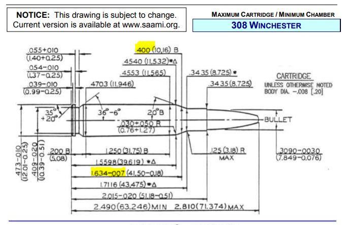

Unless you mean your case length in relation to the shoulders, to do that you need to measure that using a datum using the headspace gauge on your calipers I mentioned above
So for that measurement you would find your fired cases shoulder measurement and then subtract .003-.004 to find what your sized case should measure.
If I understand your question correctly, OAL (over all length) and case length would be the same.
Loaded the LR load with 41.7 gr of IMR 4064 and a 175 SMK at 2.80 for a guys GAP-10. First 2 5-shot groups were .5-.6. End of load development. You might try a 165 gr B-Tip with 42.0 to 42.5 and see what that gets you. It preformed great in a 308 bolt gun I had.
OAL and case length is NOT the same. Case length is just that, how long your piece of brass is. It’s the same for bolt or gas gun. OAL length is how long total that your loaded cartridge is. You can use a Hornady comparator to check where your bullet ogive meets the lands to help set your bullet depth. More than likely, as someone stated above, you will be limited to mag length, and not be able to load your bullet out to get the small amount of jump that a lot of people like. It will be ok though, should still shoot good. 308s can be a little forgiving in that area.

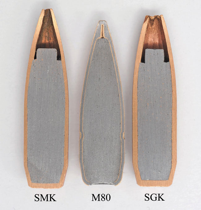

I threw together a couple loads for my large frame 308. 168 Nosler Ballistic Tips and 43gr of Varget and 42.5gr of IMR4064. The 4064 with a 168 Amax is extremely accurate. I did this 3 days before season opener and was happy with the way all shot.
I see a lot of people talking about SMK. Isn’t that a match grade bullet? I don’t think that would work for me since all my shooting is based around hunting. I need to work up a load with hunting bullets such as the Nosler Ballistic Tip or Accubond bullet.
I'm not going to try to talk you out of "hunting bullets" but you should check out the match bullet kills thread in the hunting section before discounting the SMK. I really like Barnes TSX bullets, but they are not a drop in replacement for a SMK- you'll need to work up your own load.
My last 2 deer were shot with 123 gr AMAX bullets from a 6.5 Grendel. The internet says that combo will either bounce off of, or explode on the hide of a WT deer...
Some people make the smk work, I like hunting bullets just to play it safe though.
In looking at it the hollow point gameking isnt that much different but the hollow point version of the game king is known to be much more resistant to opening up (better for going through bones etc) than the soft point version I use. The soft points blow up nicely, similar to the ballistic tip, but maybe a tad more so. Thinking of moving to the tipped game changer though for a bit of a BC boost.
For noslers stuff I like their blems from shooter pro shop http://www.shootersproshop.com/nosl...hed-bullets/shopby/f/caliber/30/isAjax/1.html
