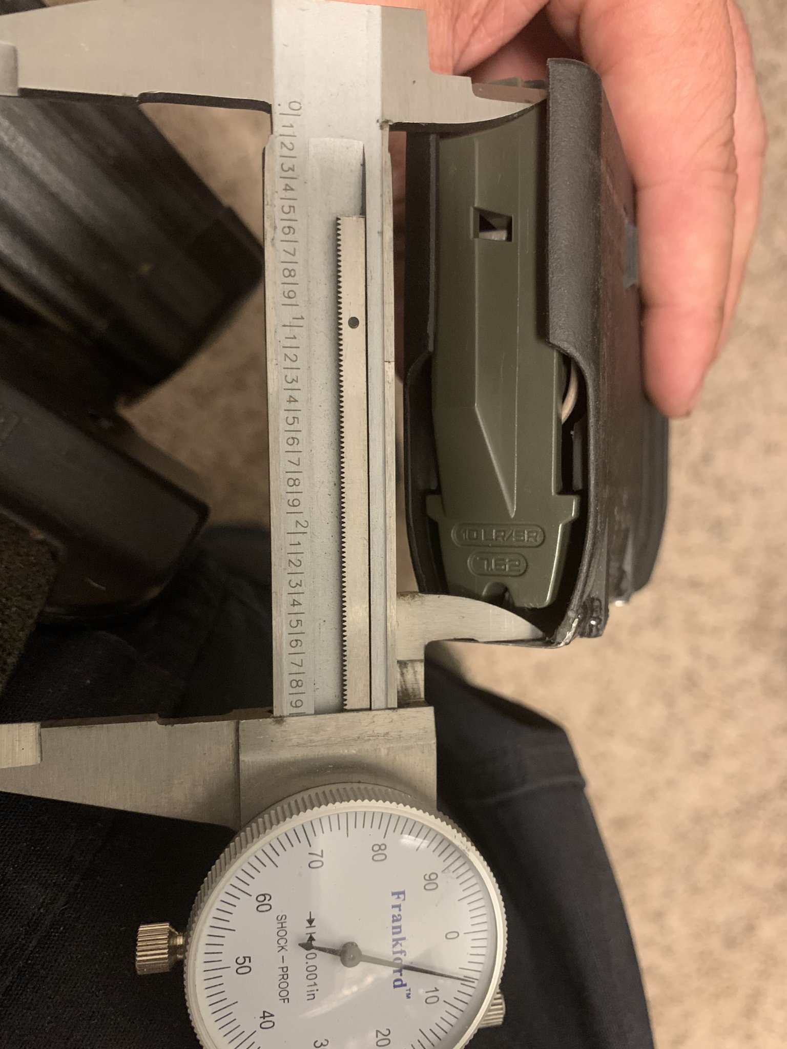

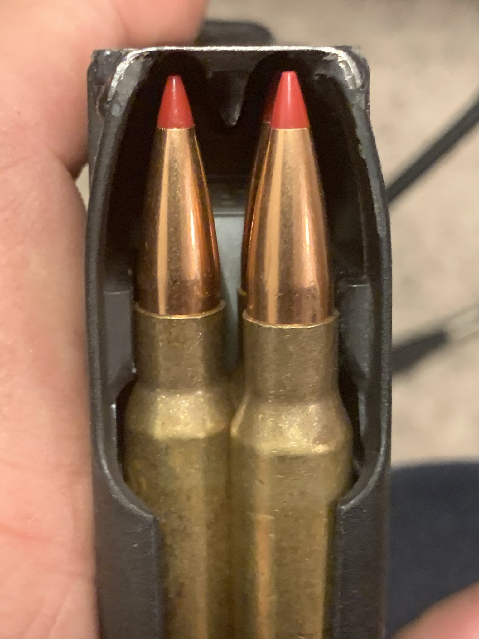

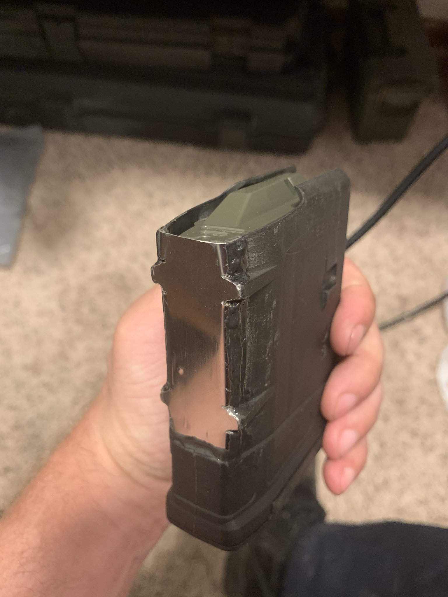

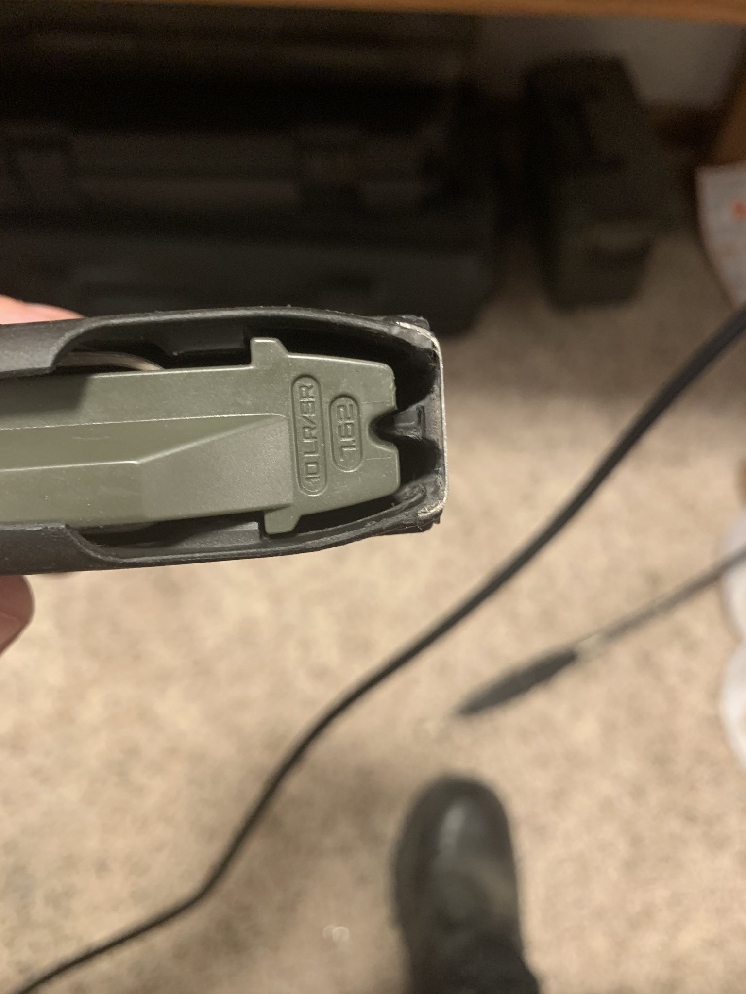

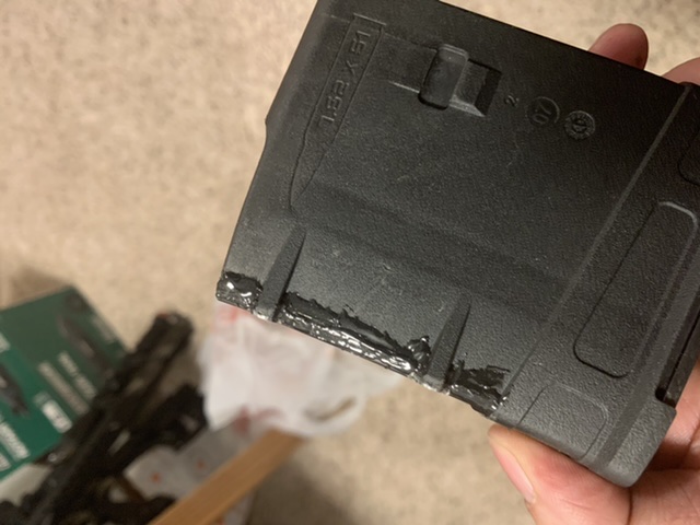

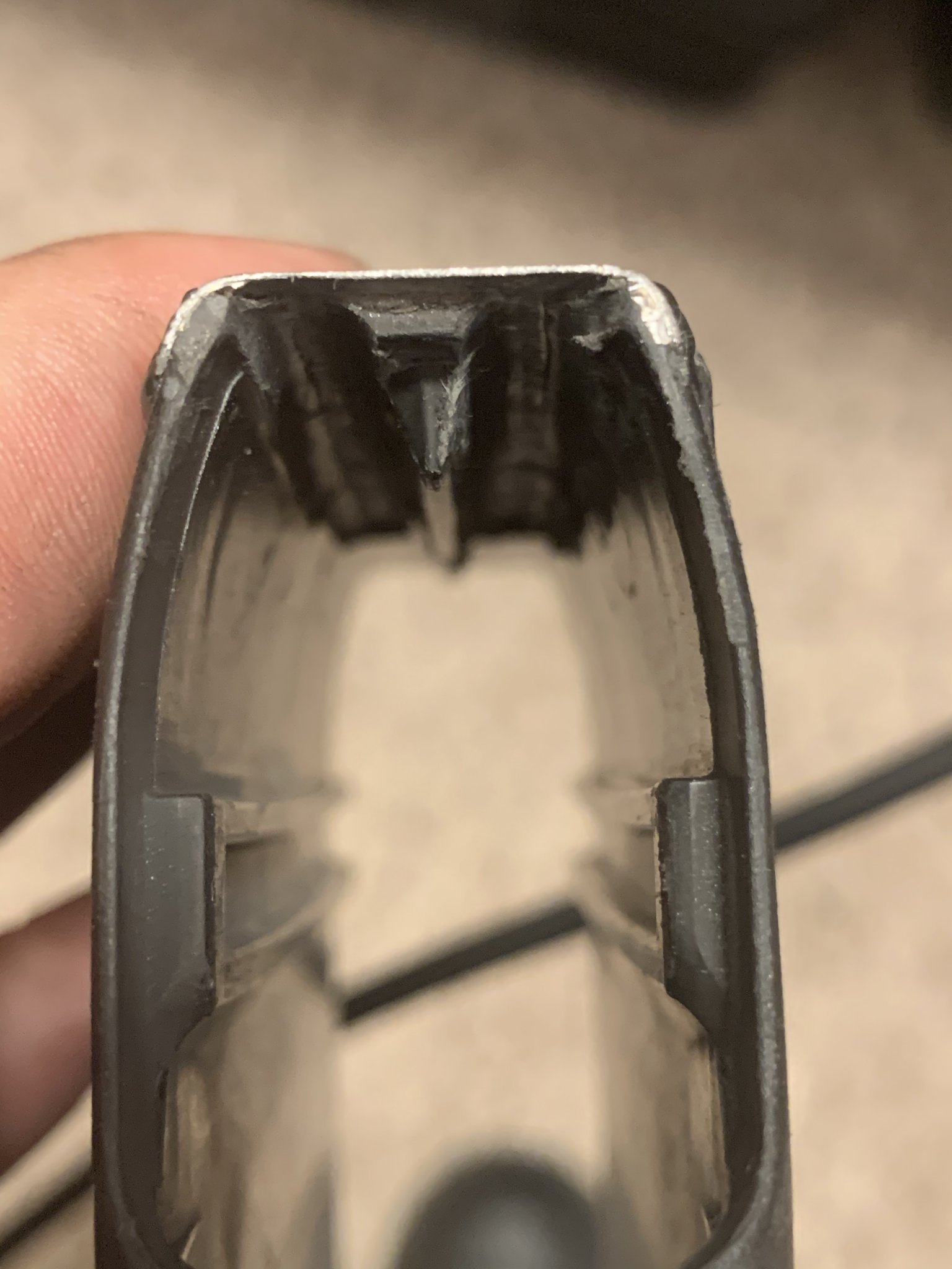

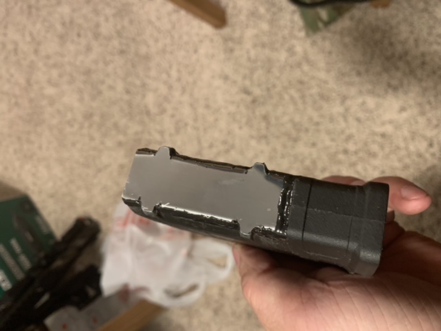

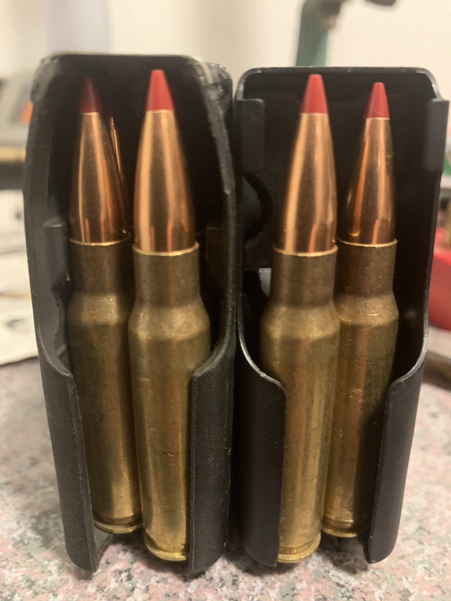

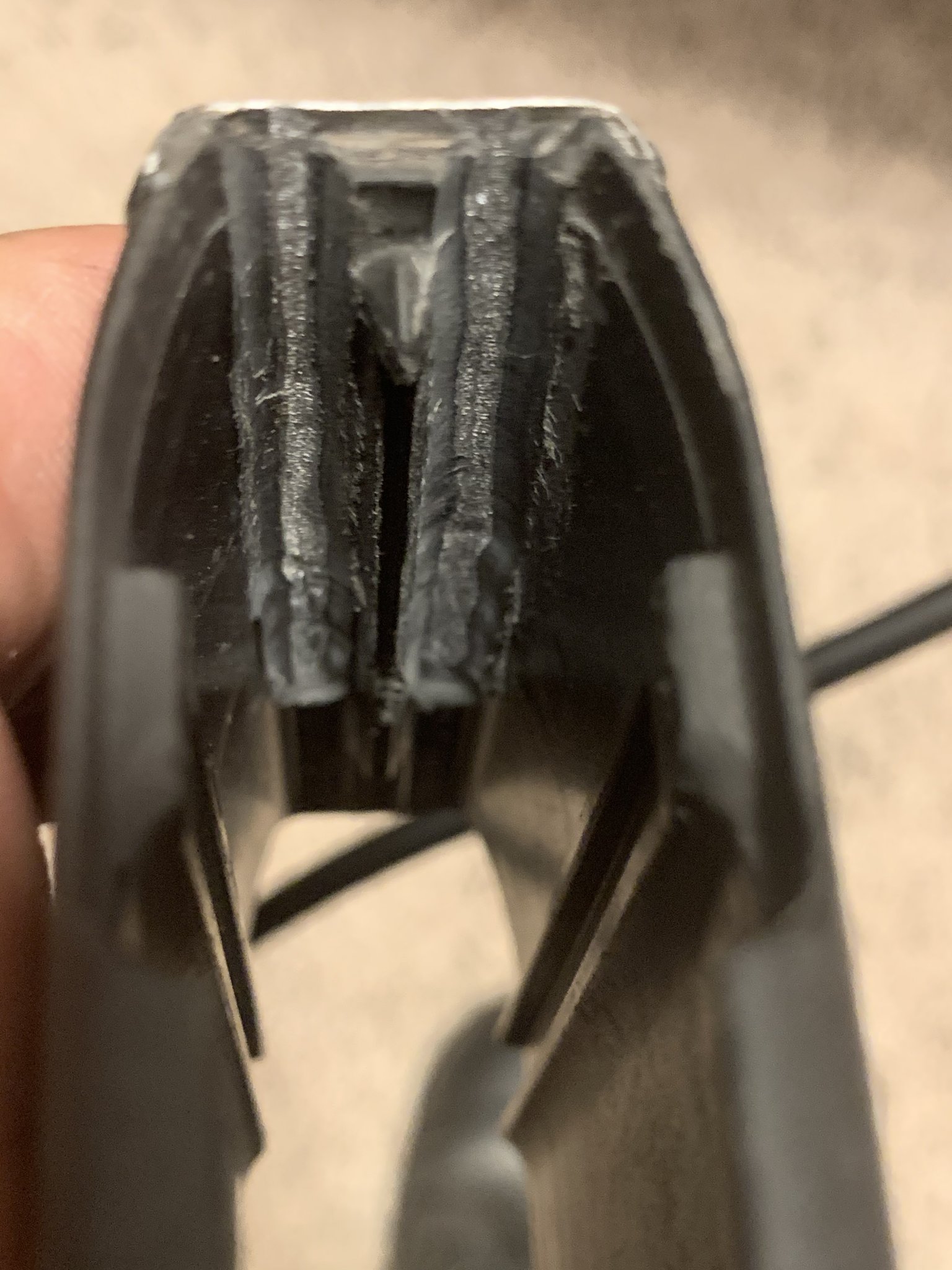

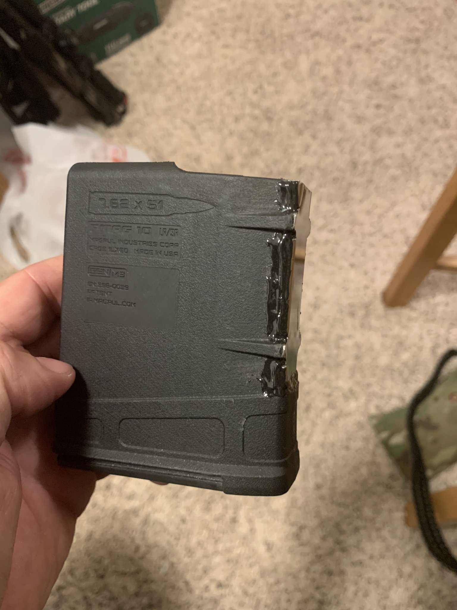

After looking into having some custom mags made and finding out the wait time along with expense, I decided to modify a P-mag and see what I could come up with.
I sanded down the front of a 10 round mag and cut a piece of stainless shim stock to fit. https://www.acehardware.com/departments/hardware/metal-sheets-and-rods/steel-sheets/5203930
I used JB Weld to epoxy it to the front of the mag and used a dremal to grind out the inside of the mag, removing all polymer martial exposing the stainless, creating a channel for the tips of the bullet To fit and ride in.
This still allows the magazine to fit in my Nemo and Ascend Armory lowers, though it is a very snug fit and will not drop free.
With the modification, the new interior dimension on the P-mag is 2.906”
I still need to do a little clean up for aesthetics and polish the inside of the metal channel, but here is how it looks.
The pics with the rounds in them are loaded to 2.83” and the mag on the right is a C-mag for comparison.
I cycled a loaded mag with no issues and just need to test fire it now.

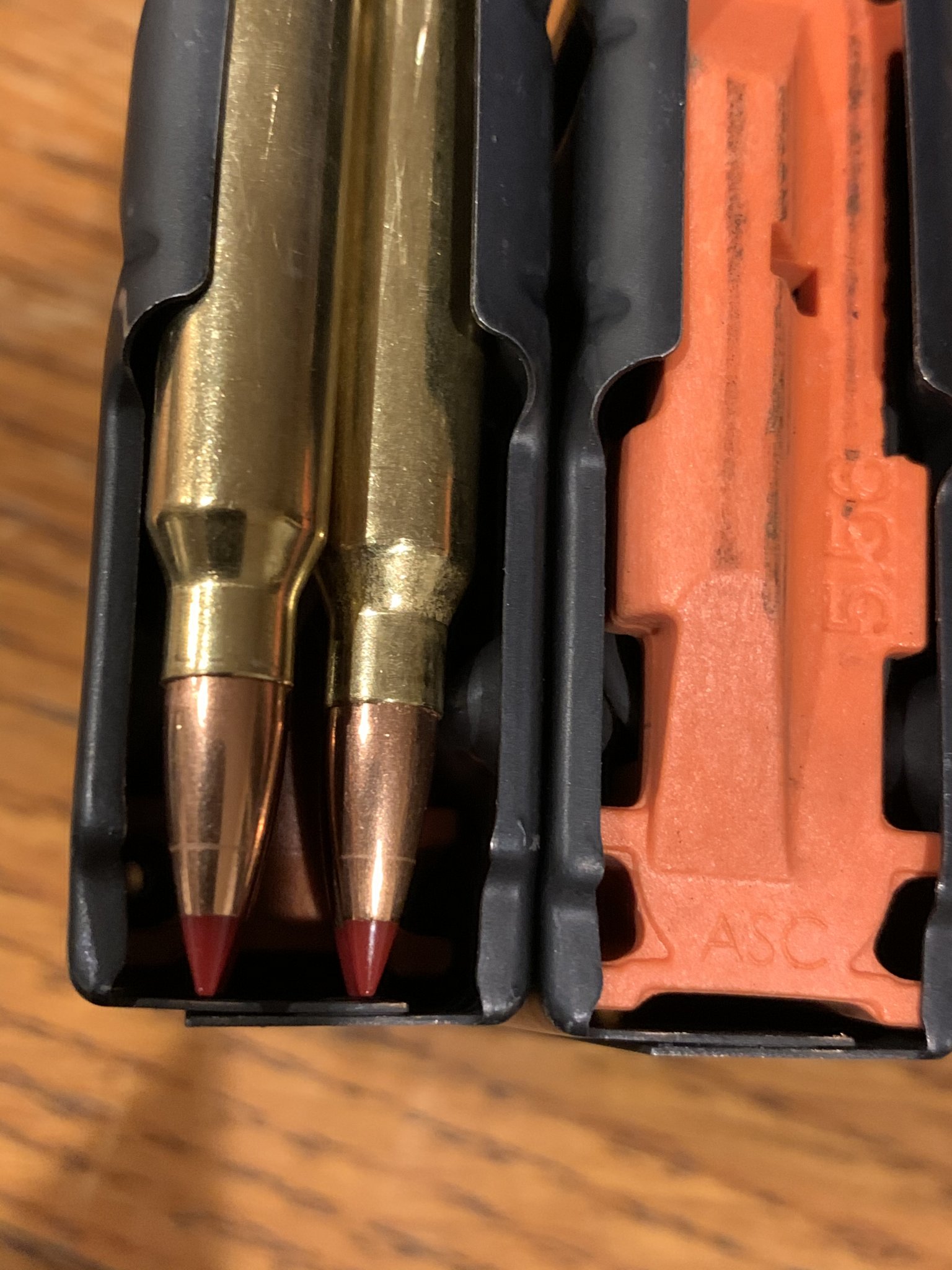

If you get the ASC mags make sure to buy the stainless & not the aluminum. The aluminum mags do not allow longer coals. The stainless 308 says 2.866 + or - .002. I load them to 2.86 & have never had any problems. If your shooting competition then the kac is probably the way to go. Also the same goes for the 556 ASC mags, get the stainless with the orange followers not the aluminum. They say the 556 ASC will allow 2.316 or - .002 but I don’t load farther than 2.30. I have had good luck with the ASC & so have most of the guys I know at the range. The pic is of an ASC with rounds loaded to 2.305

the mag well size does matter for what I am doing with modifying the P-Mag as it is adding 0.010" to the overall length of the mag from front to back. On my rifles, it is a snug fit and the mag will not drop free but it still removes easy enough that it isn't a problem or concern. I'm doing the same thing to test a mag on my bolt gun as well with a Magpull mag to give an overall cartridge length of 2.95" to see if it works.
I figure if it works and is reliable, it's about 1/3 the cost of quality mags and if it doesn't, it was just a little bit of my time and something I had fun doing.

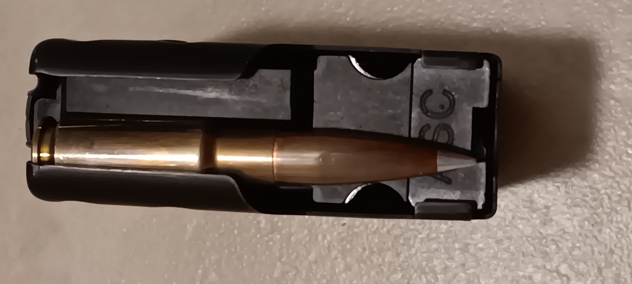

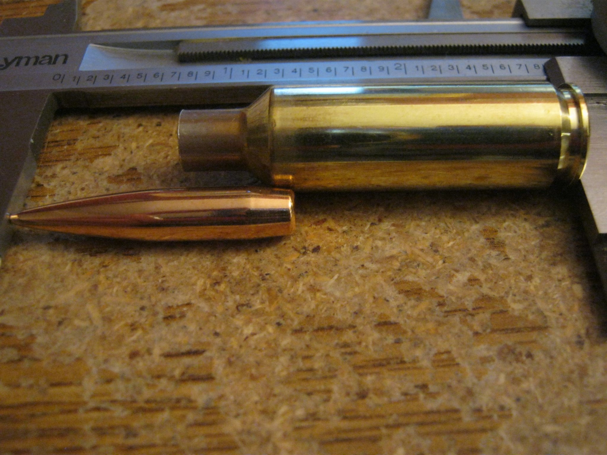

Curious as well if you built the 7 SST. Which magazines did you go with? Here's a pic of a 2.76" coal 338 Whisper in an ASC stainless mag, and I'm measuring 2.868 on the dial calipers if one wanted to nose drag their cartridges in the ASC. I have a 6.5 SST and a 6.8 Western sitting over there (imagine me pointing at safe across room) but have no intention of shooting them until I've worked my way up getting proficient with the toys I built after the 2020 election so I don't get bored with the "lesser" stuff before I get my money's worth out of them (Disassembled the 224 Valkyrie and waiting on a scope mount before I cerakote and take it out for 1000+ yd fun). Initial guestimate for 6.5 SST laying the bullet next to the brass measurements suggest the 144 berger needs 2.80" which makes the ASC ok, but then I start looking at the 153.5 gr long range hybrid and wonder if I'll be cutting the front off this magazine... but that's a couple years from now my problem.
