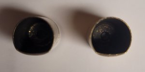

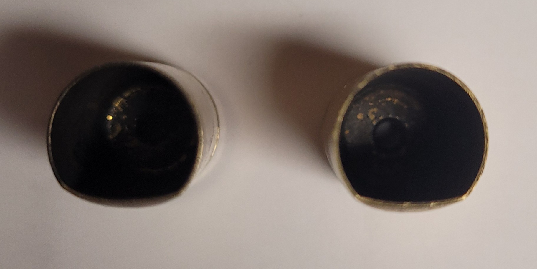

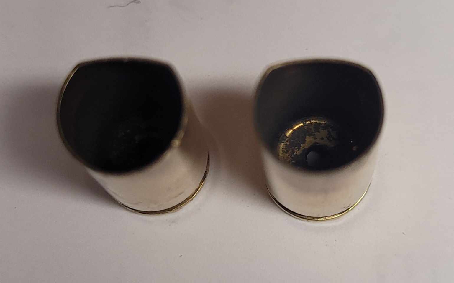

My cases are getting a flat edge after firing from my AR 9mm. Can I still reload these? Not sure why my rifle is doing this to the cases... help?
load away, but the flattening is coming from more than likely too much extraction. Not sure how your PCC is "driven" i.e. blowback, gas, etc, but Id imagine that your cases are being extracted next to/behind you, as its "overgassed". Have you tried a heavier buffer, stronger spring so the extraction comes out more 90 degrees to the ejection port? If you "tune" the extraction, it will stop slamming the cases so hard, and stop flattening them like that.
Similiar way you tune a gas driven AR extraction. Either adjust the gas, or use a stronger spring/heavier piston, and "tune" the extraction so that the cases come out 90-100 degrees from your POA.
Hope this helps.
there is no case deflector on a proper 9mm AR, it is a hot gas deflector and your cases should not be hitting it.
9mm ARs are really tricky to tune. If you care about it, there are several threads on ARFCOM about hydraulic buffers, tungsten weighted heavier buffers (9+ ounces), ramped bolts, stroke length, buffer tube blocks, and all sorts of things; some don't matter much unless you're running full auto, some do
Unless this is a high volume rig, and it runs fine, I'd leave it alone and resize that brass and move on to more pressing matters

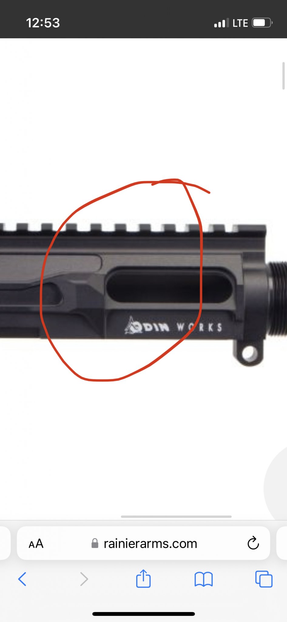

I’ve only seen a handful that didn’t. Most just aren’t as obvious as they used to be due to smaller ejection ports. Most manufacturers have started to blend them into the machining of the upper better for aesthetics. If you’ve ever shot a 9mm upper with a full length ejection port and no deflector, you quickly realize that you end up with empty cases flipped around the bolt as they are thrown off. At least that was my experience when I tried to build around a side charging upper over 10 years ago. My current one is the end result of that failed test and was SBRd on 2013/14 ish. It runs like a champ.

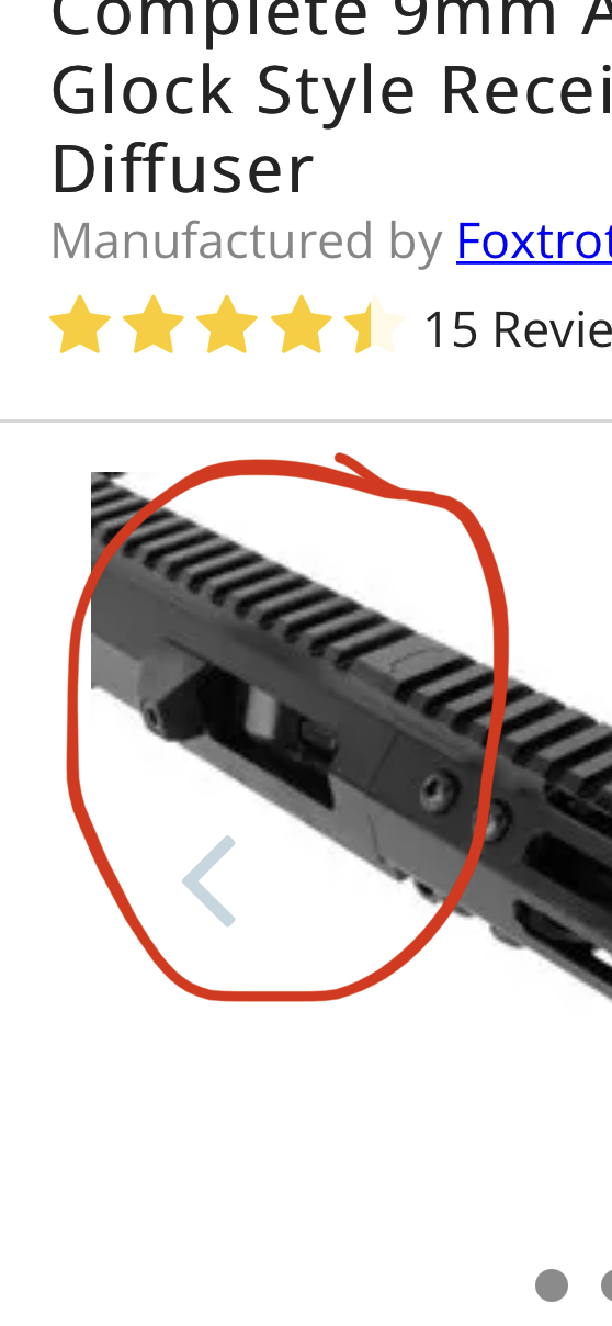

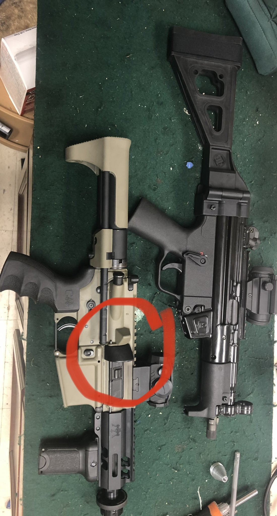

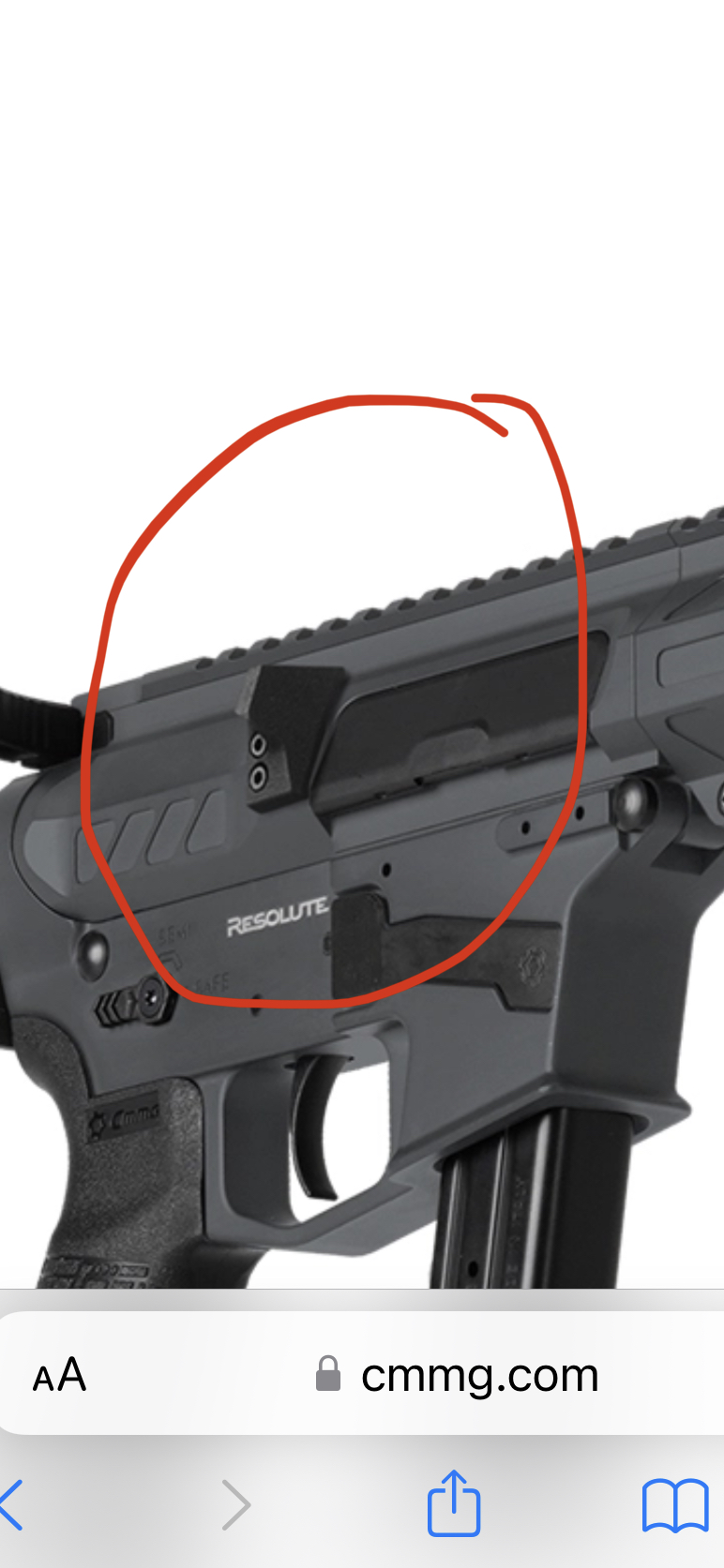

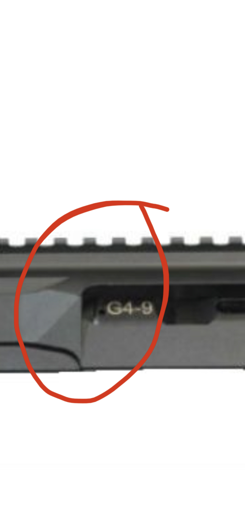

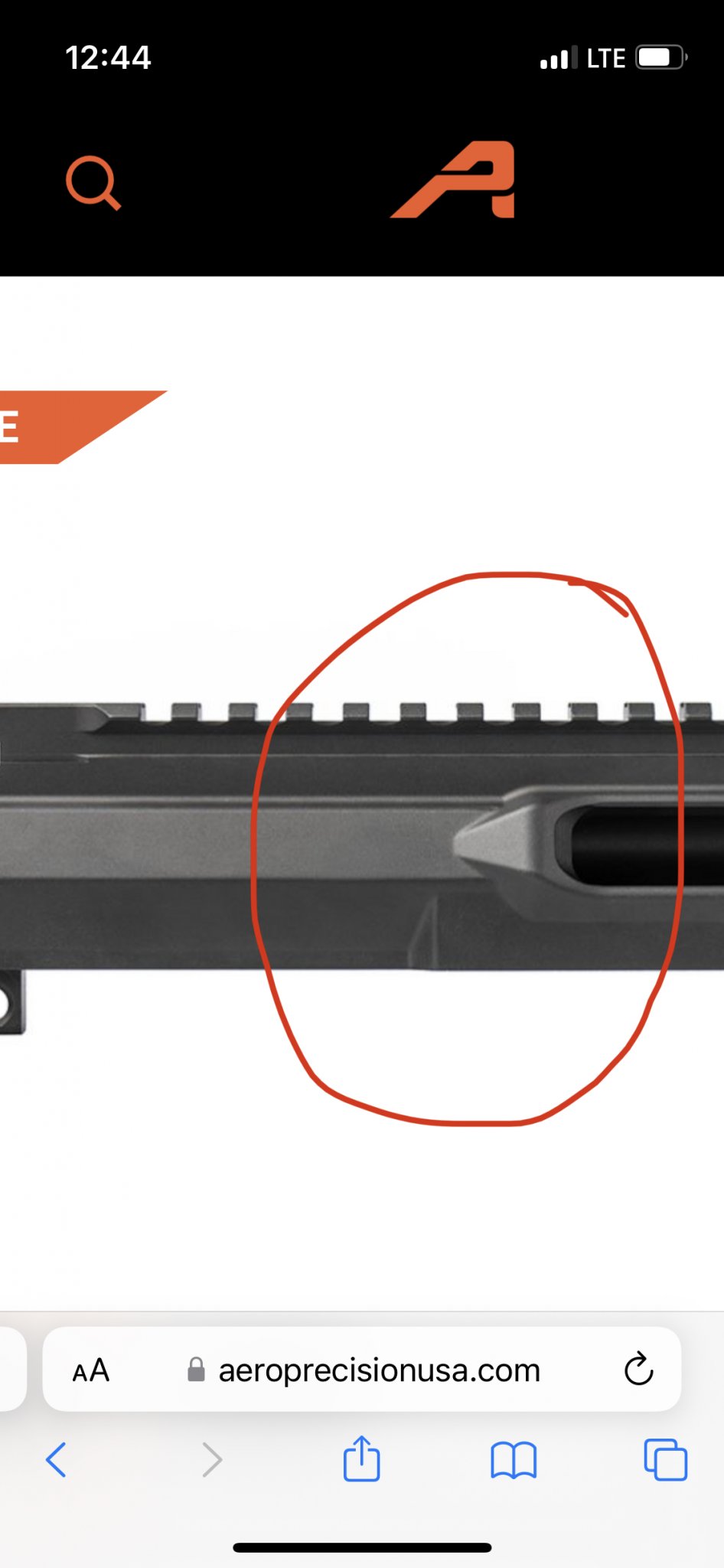

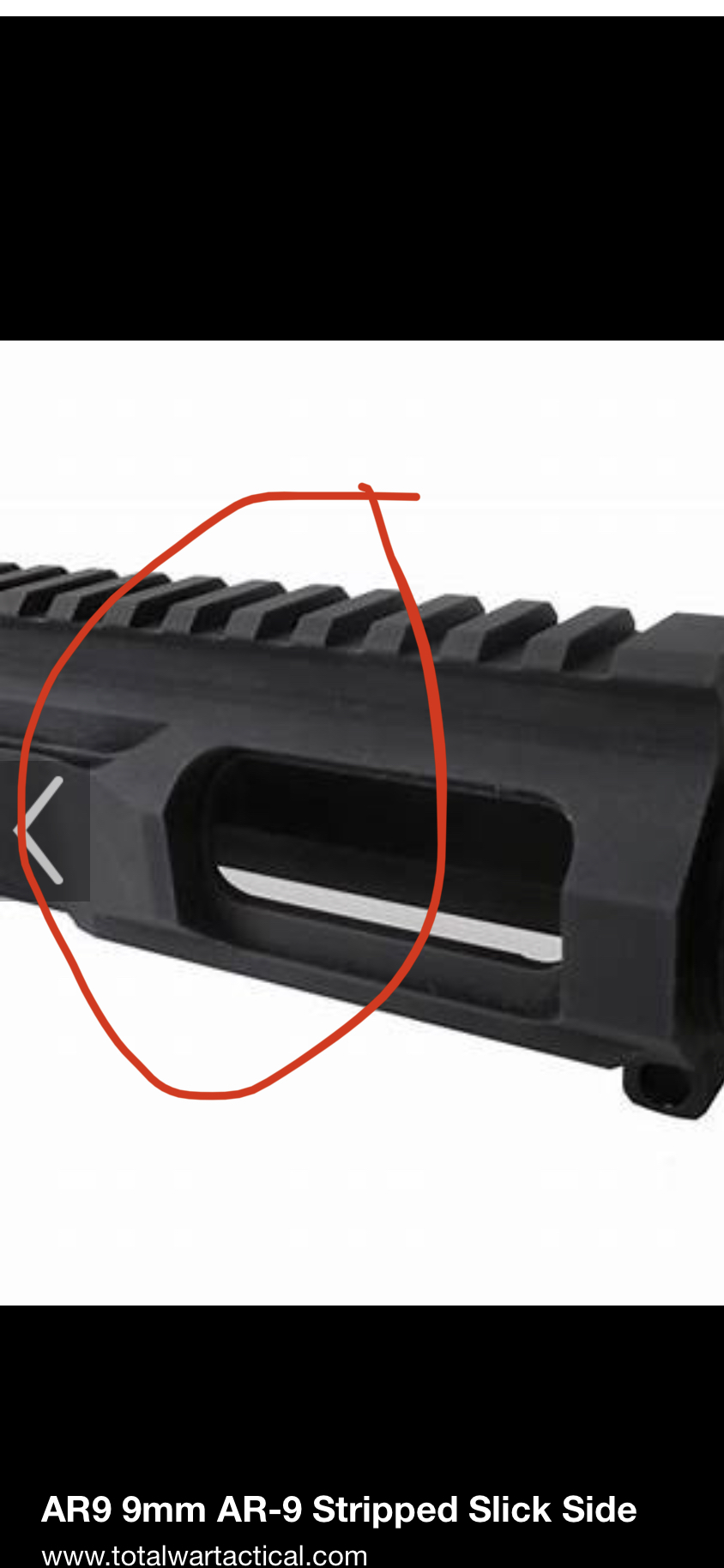

Just a few from a 5 minute search. All dedicated uppers/builds from manufacturers like Aero, CMMG, Foxtrot Mike, PSA. All have shell deflectors either attached or machined in the upper.

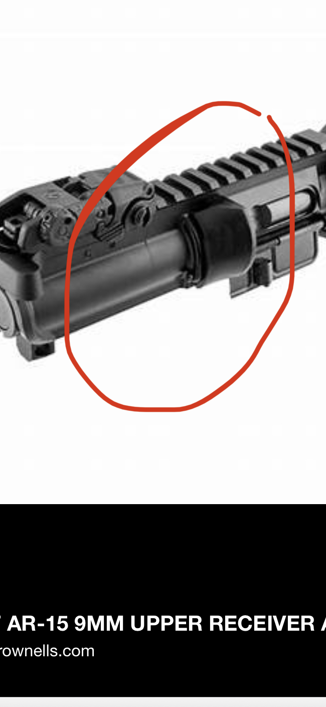

Better go take a look at the OG Colt SMGs in 9mm. That big piece behind the ejection port is a shell deflector. Even the MP5 has a shell deflector on it, a small piece of sheet metal that does the jobView attachment 8149869
Do your homework. It I is NOT a case deflector. Read Black Rifle 2. Hank Tatro design. GAS deflector
It’s actually dual listed. Many well known gun folks even just call it a deflector. Larry Vickers called it a shell deflector as well when he did a video on the 9mm SMG lineup. Depending on what text you read, it is referred to both at some point and time.
As for being a gas deflector, I could lean towards that on the old colt gun. Clearly the new modern setups would not block ANY gas. If it was primarily there for one reason and one reason only, it then I wouldn’t even have replied here. Seeings how manufacturers have moved away from the large version seems even they know what it’s used for.
