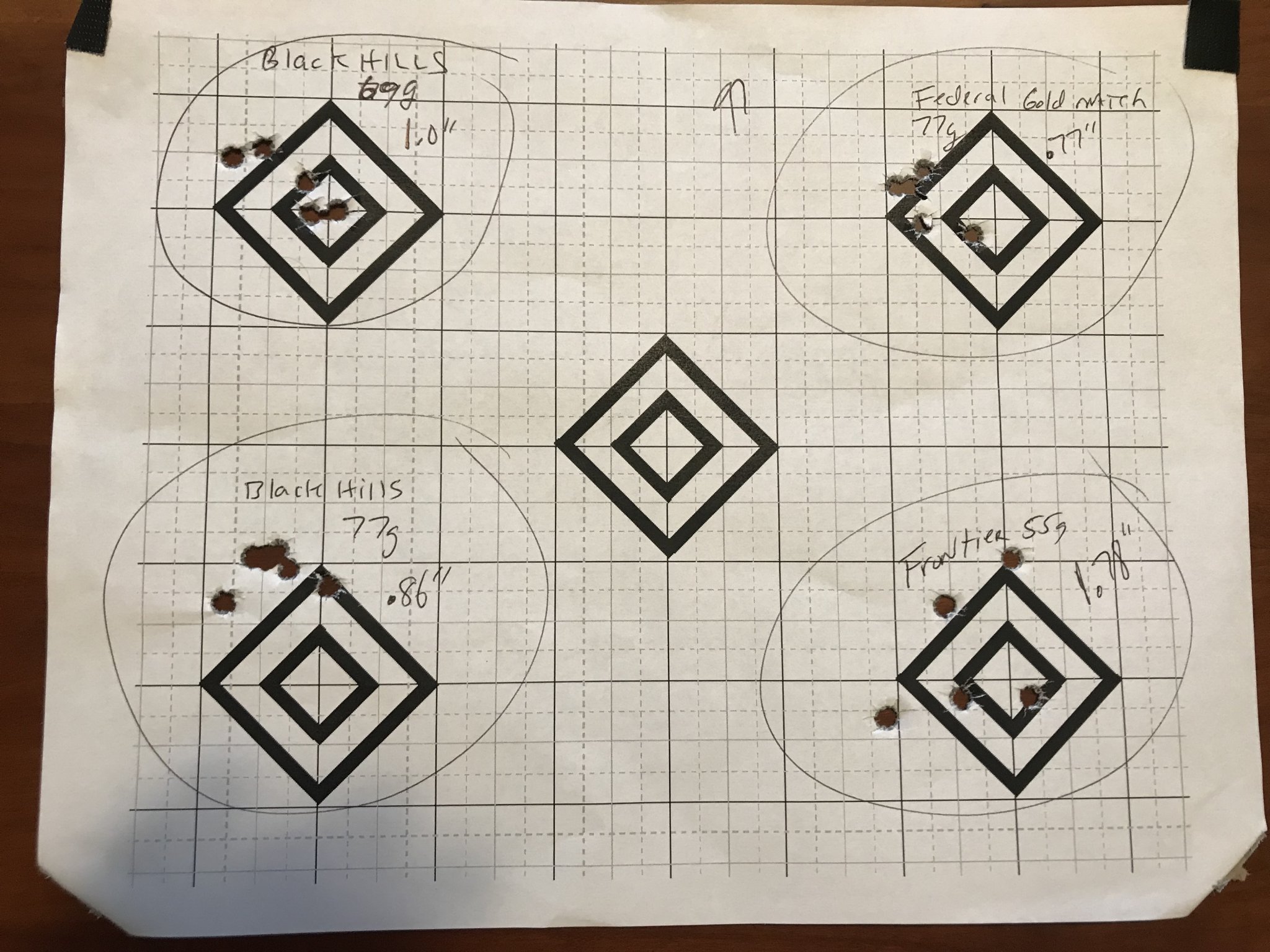

On a bench using a bipod and rear bag. I'm really just looking for a load (factory) that the DD V7 likes but at 2-3 MOA it seems to be a picky eater, or perhaps I just suck for now.
Hornady:
Black 75g BTHP
Frontier 55g
Super performance Match 75g BTHP
Super performance Match 73g ELD
Critical Defense 73g FTX
Federal:
American eagle 55g
TRU 55g
Step one, try some federal gold medal 77gr smk ammo. My brother has a DD and it is well under MOA with FGMM. I don't shoot much factory ammo but from what I have shot I have never seen hornady stuff shoot great out of an AR.
DDs are not precision firearms (at least not the one you have). All but a few purpose built ones are generally 1.5-3moa guns, even with good ammo. The problem you are having OP is that you are trying to squeeze precision out of a mass produced CHF barrel with a large chamber that has had no care taken to ensure it is accurate. A nicer trigger will help a bit, but nothing will address the barrel, chamber, bolt & BCG fit, and so on.
If you want consistent sub-moa performance (5x5 minimum measure) out of your AR, you will need to build or buy an AR that at a minimum has a good barrel (great relatively inexpensive option is a Rock Creek from Craddock Precision for $285).
Nothing wrong with hammer forged, they can be just as accurate as anything. I agree that OPs gun isnt exactly built for accuracy though. My brother's rifle is under DDs hunting line and I think has the nicer barrel in it and maybe was a little more geared toward accuracy. It is a laser with handloads. Still, I would throw some FGMM into OPs gun just to see what it would do. My brothers gun shot the 60g Vmax pretty good but it did not like the heavier hornady stuff. It loves 77 smks.
Maybe my expectations (1 MOA) are unrealistic. My next step, if I can't find a load that produces acceptable accuracy is to replace the barrel with a Compass Lake Engineering barrel from a Bartlin blank. (This is what I really want to do anyway as I'm sure you all can understand:)). My intent was to find the configuration with the least compromises but a rifle that won't shoot 1 MOA consistently just isn't interesting to me.
I now have some FGMM 77g on the way as well as some Black Hills with the same bullet.

I think you are on to something. I think you can get away with more with a heavy precision rifle than you can a 7lb AR, It takes little to disrupt the AR.
Your expectations are extremely realistic. 1 MOA is pretty easy to achieve, the rifle below is a 7lb rifle without Optics.

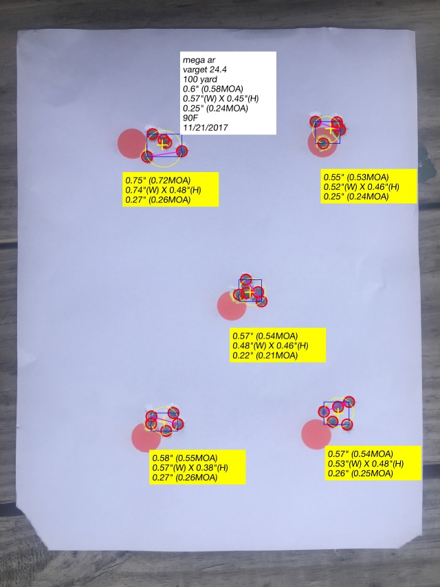

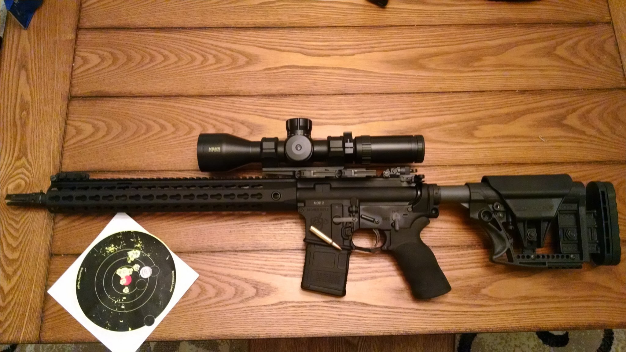

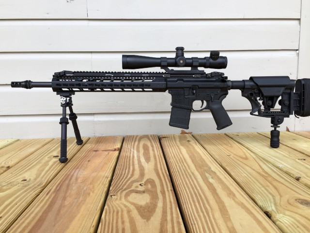

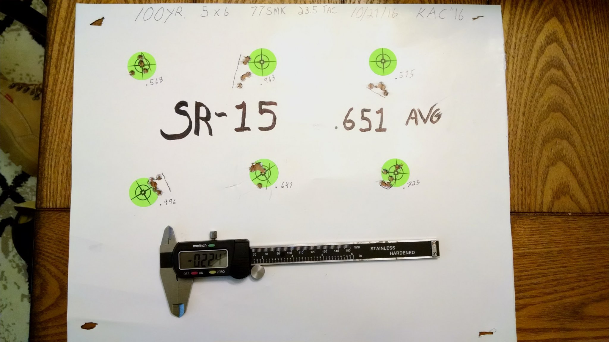

Agree with this. I have 4 AR's that are all under 1 moa for 5 shot groups. A BCM with stainless barrel, Noveske, Wilson and one I built with Noveske 3rd gen upper/lower with a F1 barrel. Use quality parts and ammo and you'll see the results.
What barrel is that? Hand guard?
It's a Larue barrel and Mega MKM upper/handguard. I ran a full length YHM riser between the back up sights because it looks cool lol. I won't be able to resist turning it into one for much longer. Too tempting when all it takes is a barrel, bolt, and mag. I'll prob sell the Larue with the Specwar brake if you are interested. Has about 700 rounds on it.
Edit, just realized @Bulldog Firearms is in the thread. Thanks for the good deal on the MKM bro!

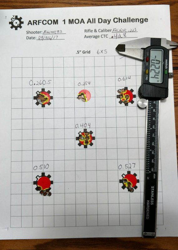

Rock River Arms claims 1 MOA accuracy is the norm. I consistency get MOA if not sub MOA accuracy out of my 16" barreled AR at 100 yards. At longer distances it opens up but generally I get 1 MOA out of it. No floating barrel - no fancy stuff except some extra optics. It's role is a "Street Broom" and in it's intended role I am highly accurate out to 300+ yards.
But I don't expect much more than 1 MOA out to 300 yards nor do I need it. If I need precision then I go to my bolt action. I have seen guys locally shooting handloaded 5.56 out to 600 yards with sub MOA performance and kudos to them. My AR is a Street Broom and 1 MOA at up to 300 yards is plenty good for me. Then again I'm not trying to win or rack up trophies .

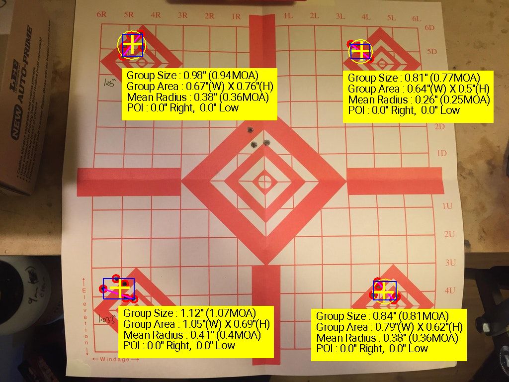

I have a DDm4v5 with a geissele SSA-E that shoots MOA or better 5 shots consistently, and a DIY 6.5 grendel with an aero precision barrel that shoots 1" 10 shot groups consistently with handloads, and sub MOA 5 shots with federal berger match. Neither rifle is particularly special, but they have decent barrels and good triggers.
Hopefully you can drop in a solid trigger and try some heavier ammo, and shrink those average groups closer to 1"!

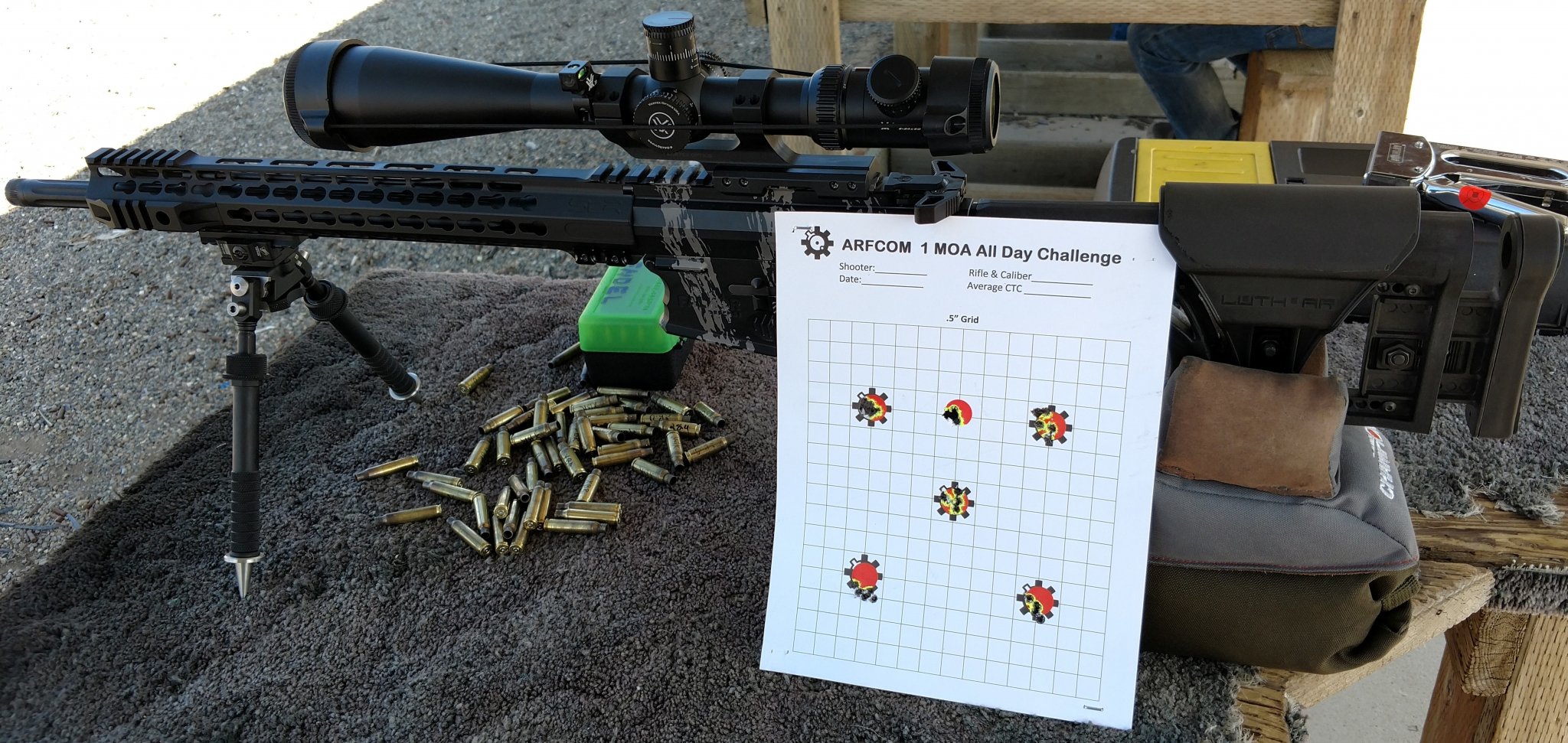

My first AR 15 purchased in 1984 is a Colt Sporter II...A2 features except they were using the last the A1 upper receiver and rear sights.
Didn't have high accuracy expectations but with a bipod, wedge to reduce the receiver movement and loaded with handloaded IMI 55 FMJBT and BLC2 it shoots 1" five shot groups at 100 yards using the peep sights. If the handle was removable I'd probably put a high power scope on it.
Not bad for a $475 milspec battle rifle.

With your setup, you should expect 1-1.5moa 10-shot groups. This is what I typically average when using a chrome-lined government type profile AR with a LPVO. This is off a front bag at 100 yards, seated, shouldering the rifle. Some ammo doesn't do well though for some guns. For example, I average close to 1moa using 75gr Gold Dot, while 77gr TMK in the same gun never shot below 2.5moa (1/7 twist, and shot fine with MK262). You may have to look around a bit before you find the round your guns like. Gold Dot is actually a great place to start, as I have YET to find a gun that won't eat it with amazingly boring results.
Reactions: tna9001

I got out to the range today, I was rushed but the results are promising. Since the last outing, I changed the hand grip, stock, and buffer tube, the ergonomics are much better now, the rifle fits me. I was using a bipod and rear bag on a bench. I really like the VLTOR stock with the A5 buffer tube, I didn't shoot the OEM set up back to back but it seems like the rifle is moving around less under recoil. I feel pretty good with this data as a starting point for a factory AR with a 16" barrel especially considering my scope has a 1 MOA center dot. There is more accuracy in the rifle, I've just got to get accustomed to the platform.
Thank you all for the input!
100 yard 5 shot groups:
Federal Gold Medal 77g
.77"
Black Hills 69g
1.0"
Black Hills 77g
.86"
Frontier 55g
1.78"
