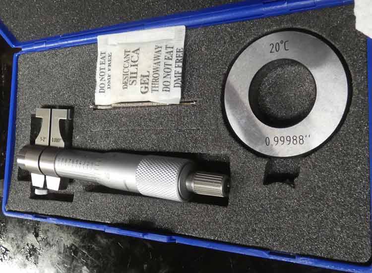

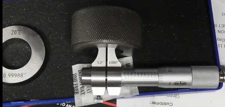

My procedure for an AR-15 is to lap the face (Wheeler tool) and measure bore with this:
Cheap Chinese ($53) inside mic that checks very close to 0.9985" X master.
Would of course need another ring for AR-10 bore.

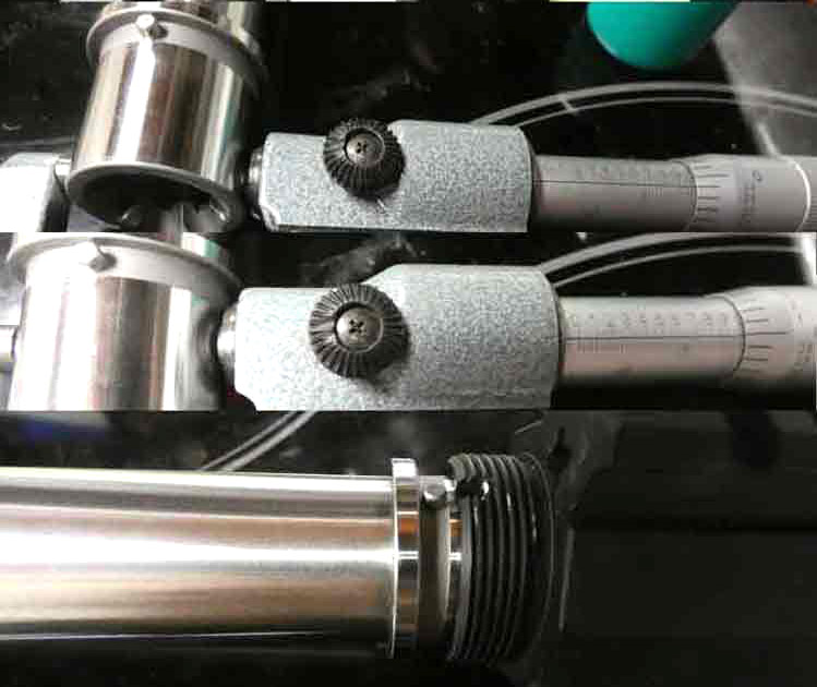

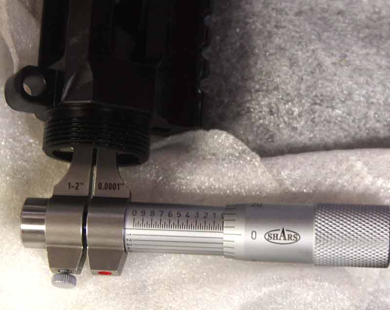

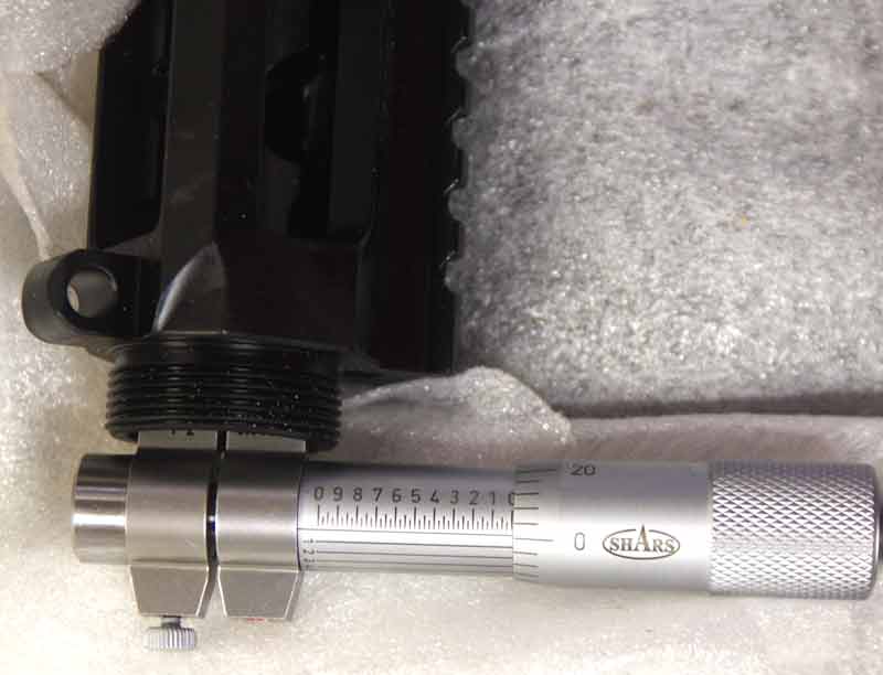

I checked one upper at three depths from the nose @ 0, 60,120 degrees. Got about 0.0003" under an inch.
My extension has a slight taper and almost slides all the way in.
