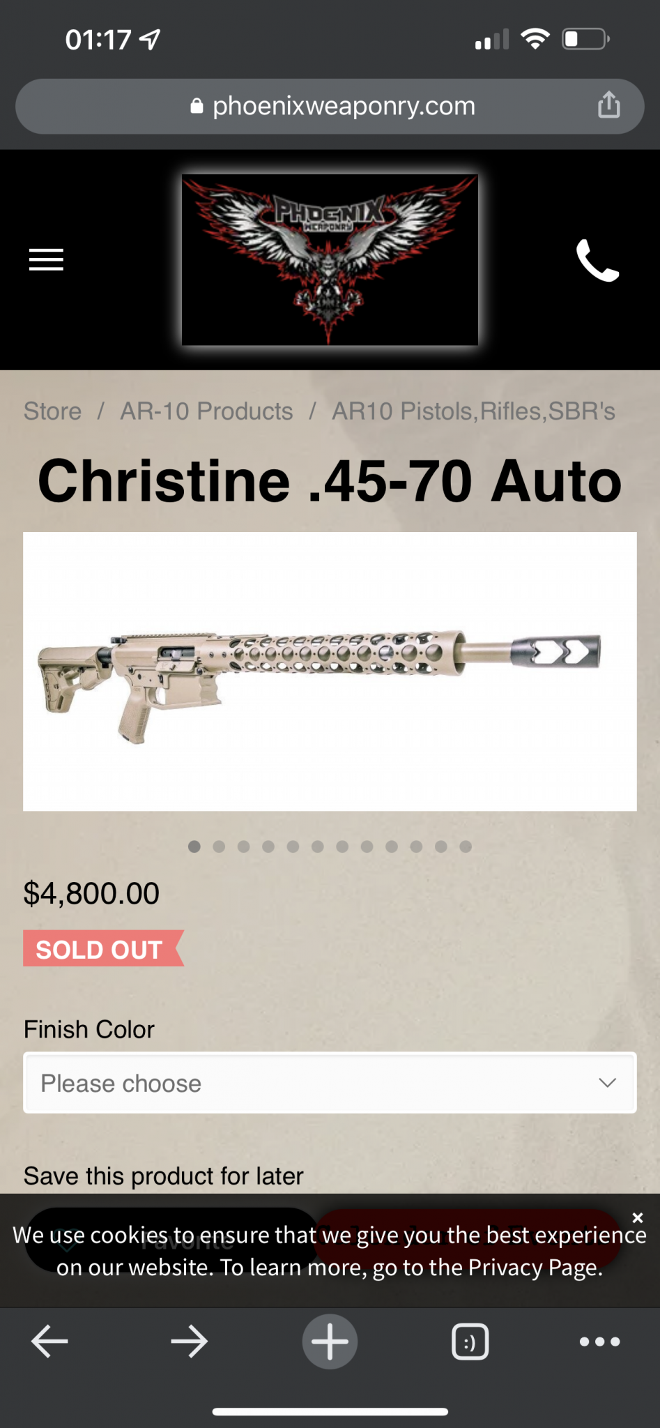

I’d just try and get this one for $2200.
I saw this...temping.

Whats its purpose short barreled 308s with tinynass seems mismatched, people argue this but the 300aac only short barell ar i own aside from 7-10” house guns which are good for small soaces, but any intermediate caliber is min 20” up to 24” and a 5-25/50
Or 56 optic, at a thousand yards cant see shit so bigger the better. First is goal if lr target it needs a bull barrel these so called heavy barrel heat up adter 5-10 rounds then lose all accuracy till cooled 20min, Watching a 6k 300 winmag are with useless carbon barell was goood for 3 shot then could not hit oaoer at 100 yards. Also whatever you do buy a matching upper amd lower or you’ll have endless issues with the total laxk of commonality between brands, if have rhe means just buy this and you’ll have about the most exotic AR10/LR anywhere you fo, that said youll be the coolest on the block

I'm not sure I should drive after reading this.
