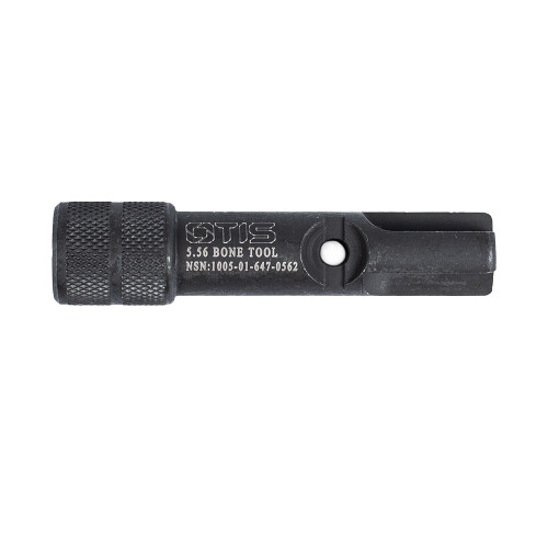

I occasionally use the Otis Tech BONE tool, although I don't get OCD about removing carbon it works sufficiently well.
I've heard that too but like anything, if you're stupid with it it can cause damage. Sit there for five minutes turning away inside the BCG and on the bolt...well that's probably not going to be good. Coming from the days when in my unit we'd use the edges of cleaning rods and coat hangers to clean our M4's to get them past the armorer, a couple quick turns of the BONE or CAT tool probably isn't going to hurt anything in the long run.

Metal-on-metal is not a good idea because it can egg out some of the critical dimensions.

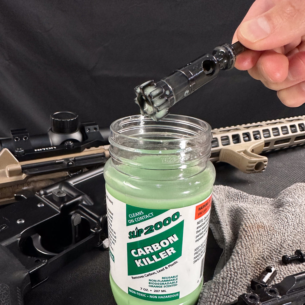

Carbon Killer is good stuff.
When the inside of the BCG looks like it has enough crud that a breakaway could cause problems I throw the BCG into the bottle of Carbon Killer and let it soak.
It does it’s job as far as my needs are concerned.

This is all you need, spray inside the carrier and on the bolt and let it sit for 20 minutes, it will turn the Carbon in to a blue gel. I use the wooden Q-tips and if anything needs to be scraped you can use the wood end of the Q-tip, that way it won't mar anything inside carrier or on the bolt.
Soak in C4 if you're one of those OCD types that actually wants everything squeaky clean.
