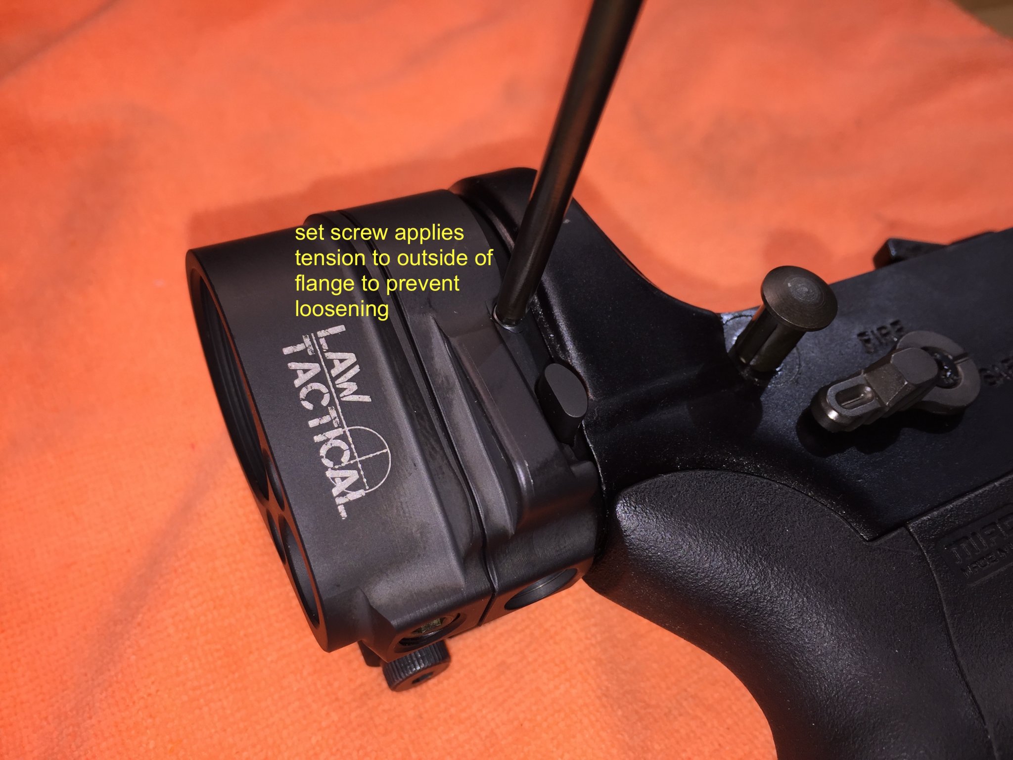

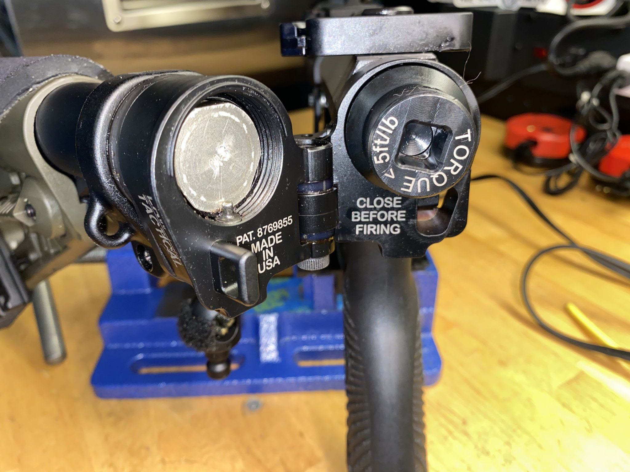

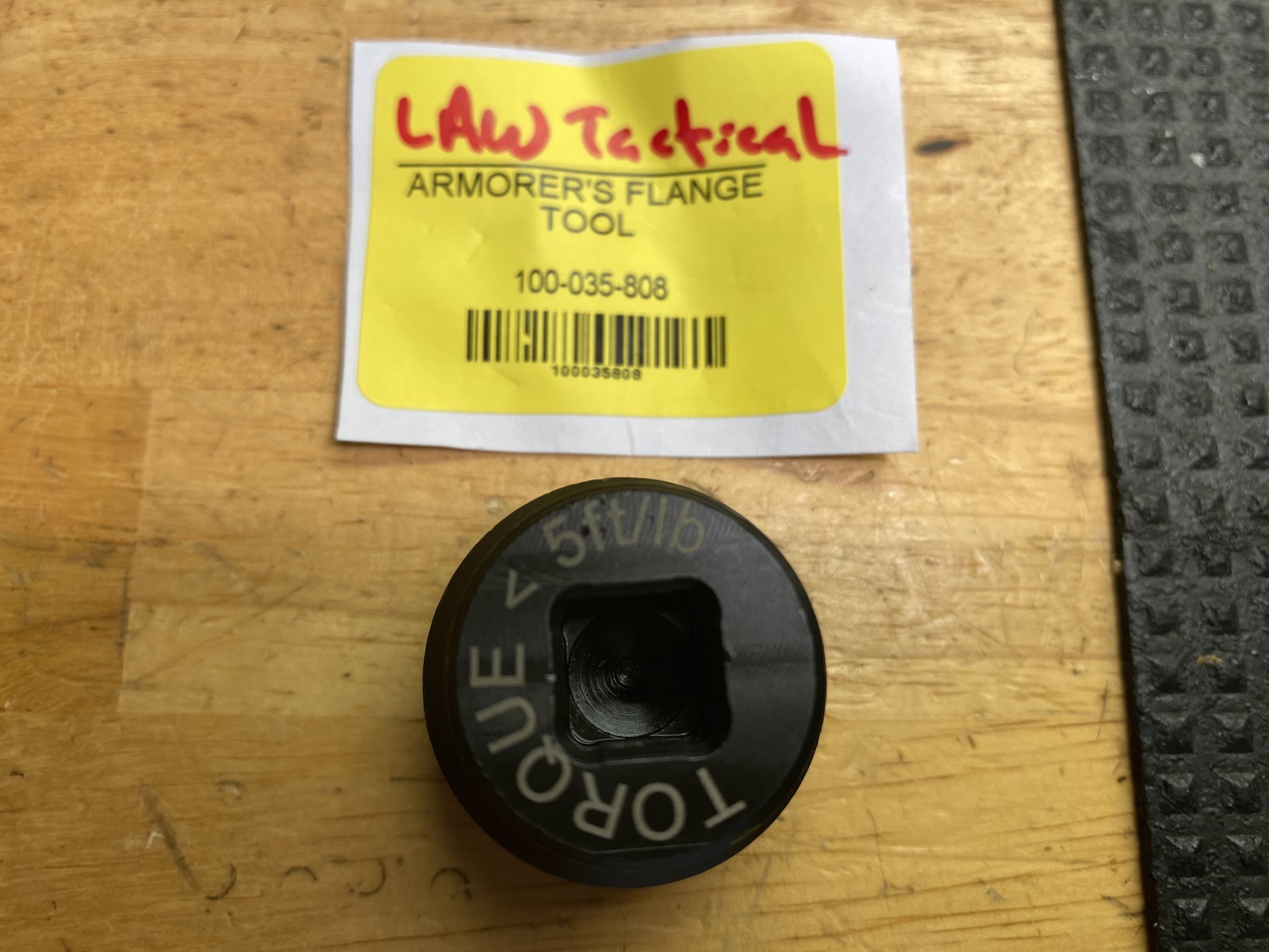

The Law comes with a flexible aluminum "wrench" to install the internal castle nut that is further secured with an external friction set screw.
Whens the wrench "flexes", the recommended installation torque has been attained.
There is a socket attachment that can be used with a torque wrench to install as well; this is the adapter I have used many times.

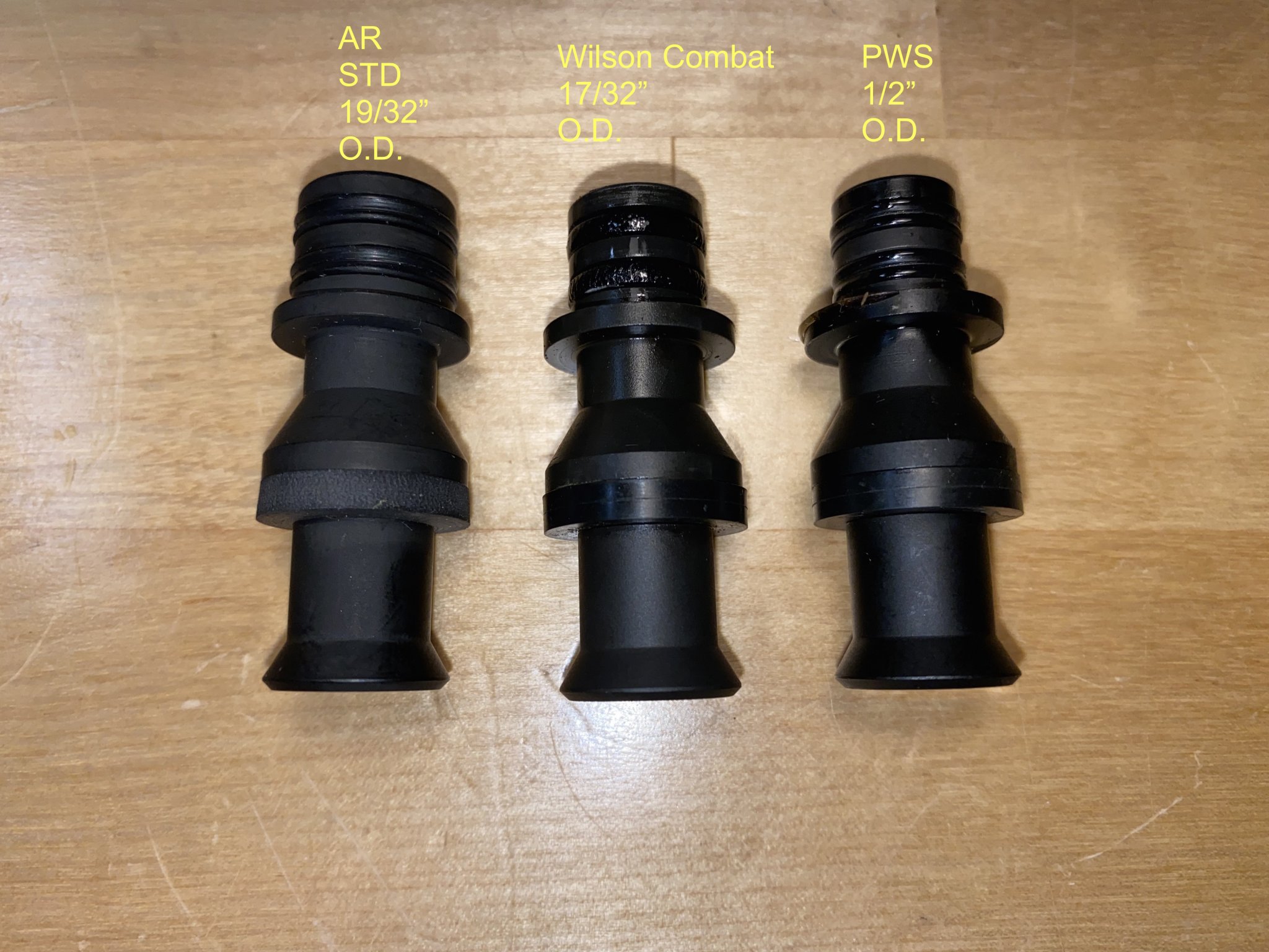

Various platforms have different diameter adapters for the rear bolt fitment.

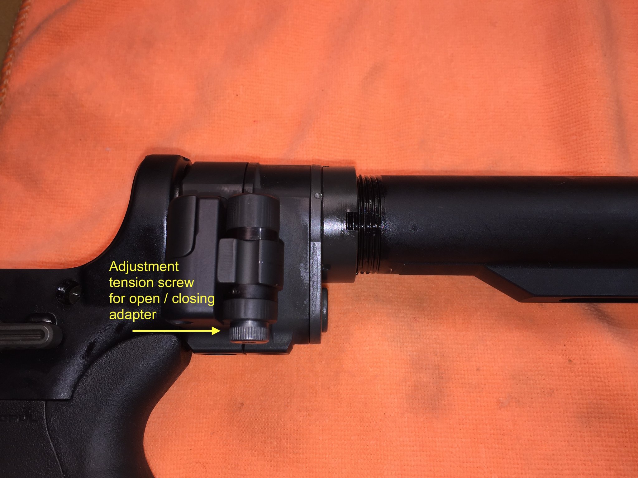

A few of the Law Gen3's I have installed.
IMG_3790LAW TACTICAL GEN 3 M VARIOUS SIZE BOLT ADAPTERS PWS WILSON AR9 STANDARD copy.jpg
I'm mainly just looking for a recommendation on a cheap wrench. There are a ton on amazon, but they don't say that they are AR compatible. The ones that I know are compatible are like $50, which seems excessive.
The firing when folded was just more a curiosity to know how bad it would be in an emergency or accident situation.
Thanks!
I'd start with not looking on Amazon for AR-15 tools too much risk of getting some piece of shit that will flex under load and/or not be to spec and mar the castle nut. Brownells has these two for less than $15.
