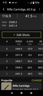

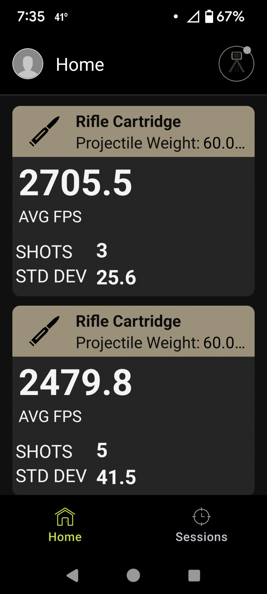

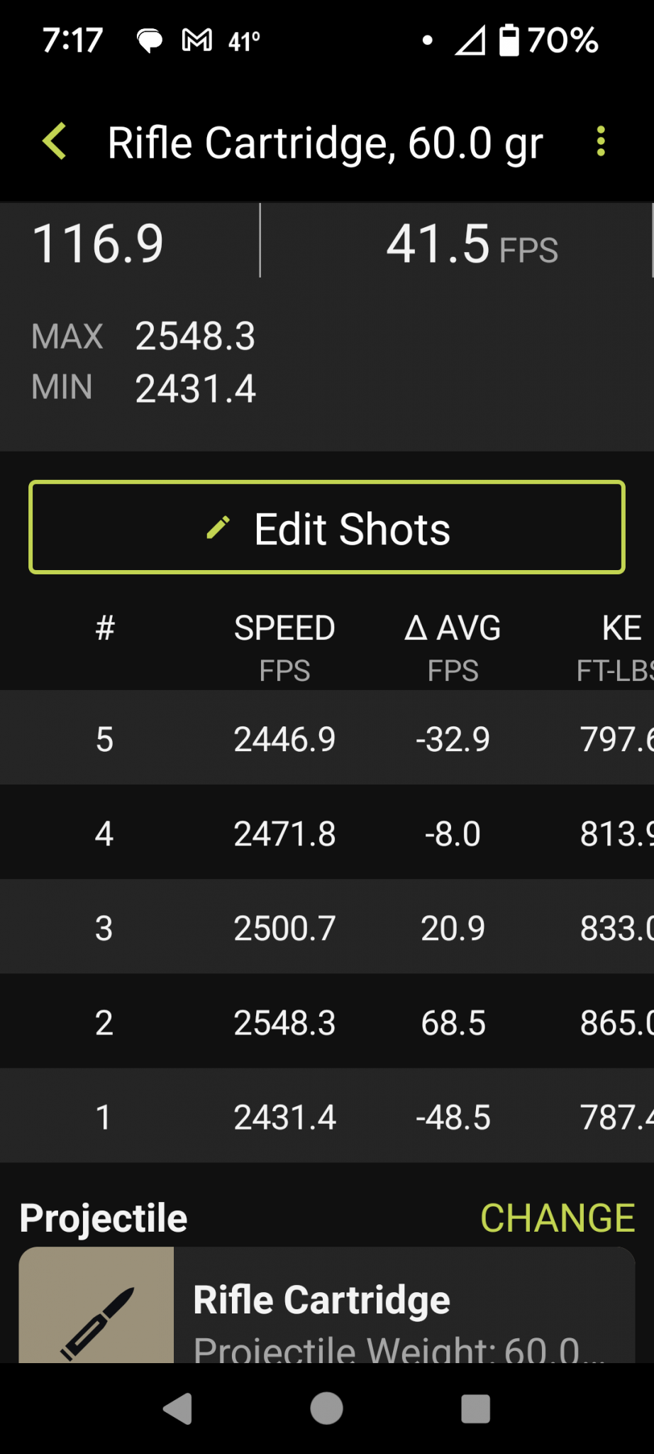

I've been trying to get AR Comp to work in either 6ARC or 223/556 but it seems like it is way slow in both. I loaded 24.2 grains of comp in 223 with a Nosler 60 bt. If memory serves, QL had it expected to be in the 2900 range from my 16" AR. Actual is much lower at <2500 where 8208 runs 2700. My 8# jug of 8208 is well over 10 years old. The 1# bottle of Comp I just bought recently.

I set up a ladder with 8208 and LVR and want to run one for Comp but I don't want to waste any more resources with it.
Alliant 223 data as follows 25.6gr 55SBK 24" barrel 3350FPS That's pretty crunchy, but I loaded some
Back off 50fps per inch (8x50=400) for my 16" barrel to 2950 expected. My actual observed with this load is 2768 with mediocre sd of 28.3
In comparison 25.6gr of 8208xbr yields 2990 with sd of 3.9 and that is with a 5gr heavier bullet. Wish I had loaded some with 55SBK for direct comparison.
Not sure if anyone has ever drawn a direct comparison between comp and xbr but 230fps seems pretty significant and would be greater with same weight projectile . They aren't just too far apart in the burn rates. QL underestimates 8208 and overestimates my particular bottle of comp.

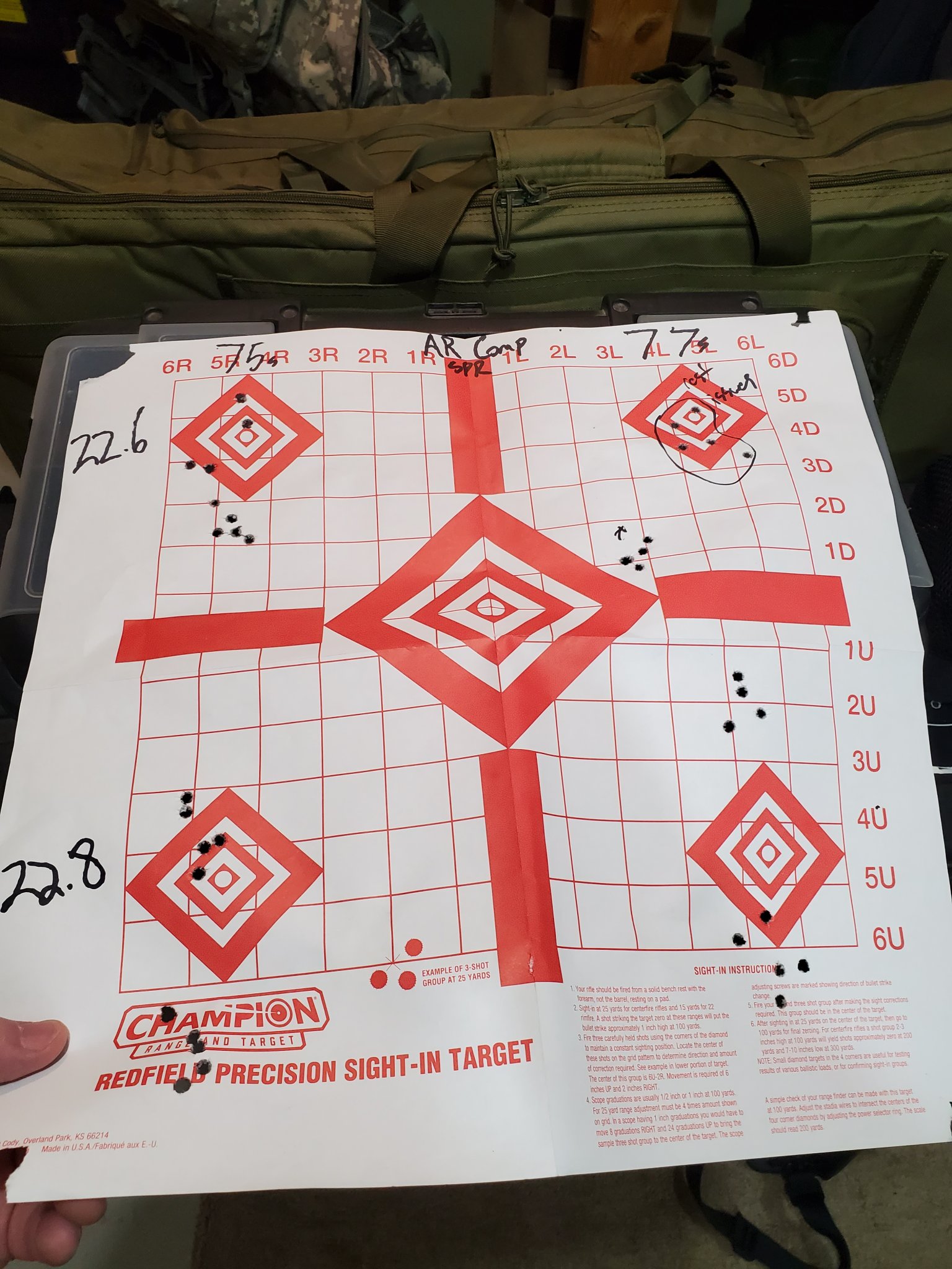

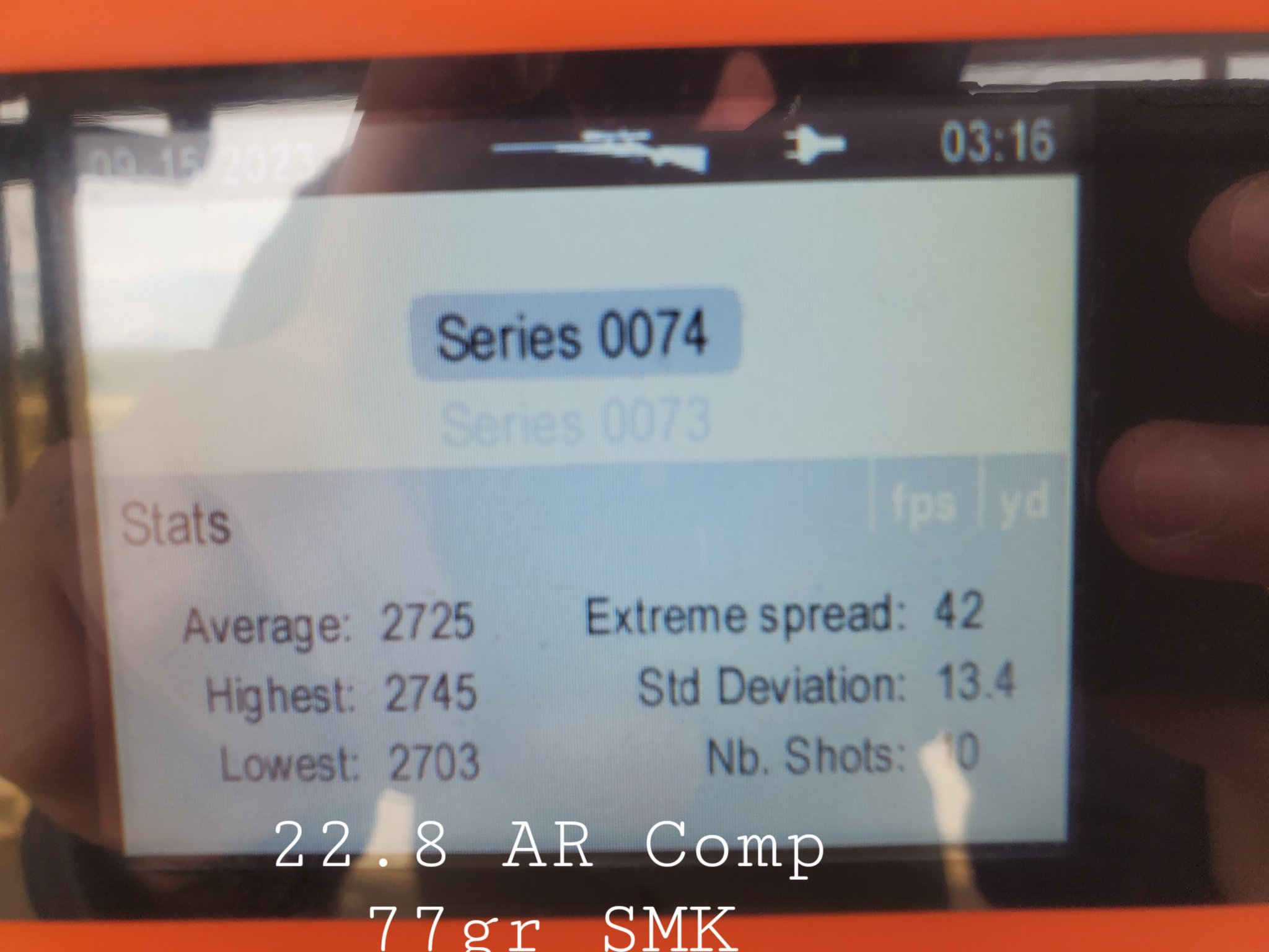

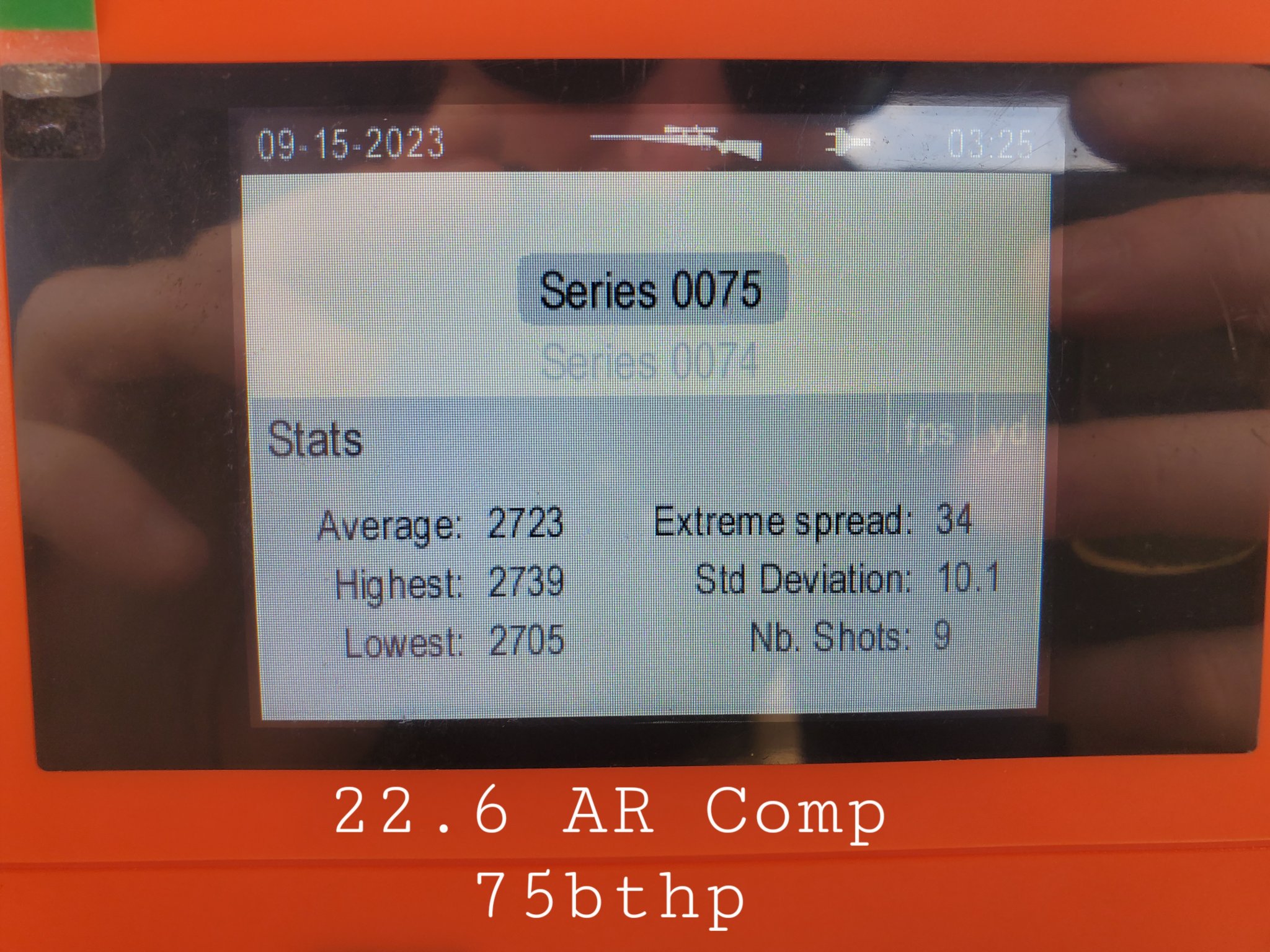

Heres some quick results with the Sierra 77 and Hornady 75, 18" AR.

So jLorenzo gets similar velocity from 22.6gr and 75/77gr bullets that I get with 25.6gr and 55gr bullet. Both same barrels.
rmfield gets similar velocity from 22.3gr and 77gr bullets but 4" longer barrel

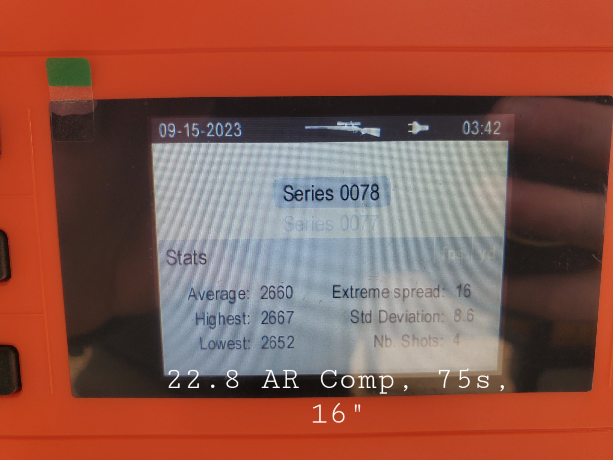

That might have actually been my 18" but one of the pics from that session says 16". I can't honestly remember, let me dig through my load dev targets and see what they say. It couldve been the 16 also. I am at 5000"+ altitude which gives a little boost in velocity also.
Yep those were the 18" white oak barrel. Not happy with the accuracy Ive got from this barrel. This was off a F clas 3 leg rest also.
I did shoot someof the 75s with 22.8 out of the 16" though. 2660.

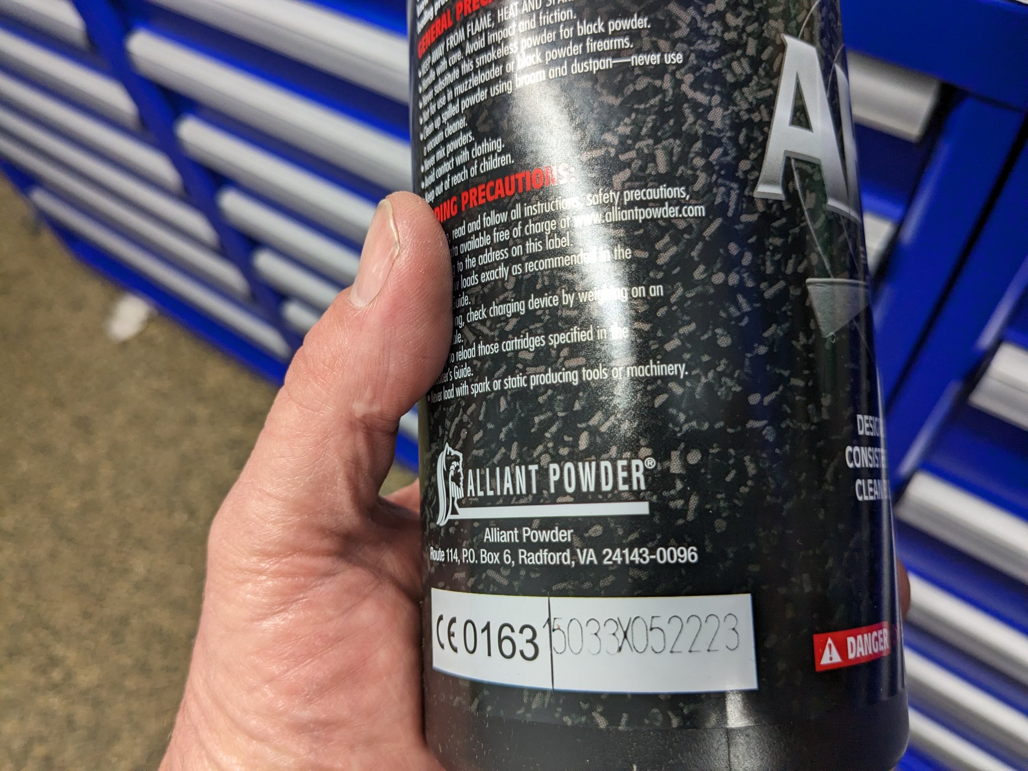

I did get word back that my bottle of comp is actually Reloader 15.
Some quotes: "Yes, there we where able to data back with your powder and find discrepancies with bottling. (human error) This was just a one off saturation and thanks to you was able to be caught before further incidents. Process have been improved and SOP followed."
"The powder you have is RL 15, In the Bottle. Actions have been taken to prevent this from happening again. "
I'm not sure how it was a one off saturation. I would sure think that an entire lot or at least an entire day or shift production would be called into question. I mean it's not like the guy running the line said oh yeah I remember doing one bottle wrong on such and such day...

Yes at one point there was discussion of sending 2 for my troubles. Latest now was one. We'll see. I'm sure they will get me one bottle at a minimum.
That whole deal could have hurt someone by having that sort of mix up. I'm shocked they weren't more apologetic and more accomodating.

Just another reminder to have your head screwed on straight when starting a new jug.
Really disappointing to hear it.
Strange accident for them to have considering how scarce the RE-15 has been lately.
Thanks for letting us know @Diesel Pro
Off to check my ARComp lot numbers....
