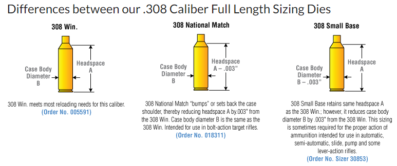

With rare exception, they make it hard to even know what the dimensions of dies are compared to chamber or ammo specs.
If a die is called an "AR" die, and they tell you the dimensions, then you could at least make an informed decision.
Something along the lines of the old diagram that Forester used to show like this one at least tells you what to expect.
Reactions: Near miss
