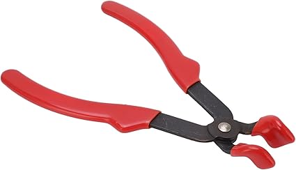

Just use a pair of spark plug boot pliers.
The jaws are rubber coated and if you need a little more grip with them wrap the tube with tape or piece of rubber like bicycle intertube or something similar.
