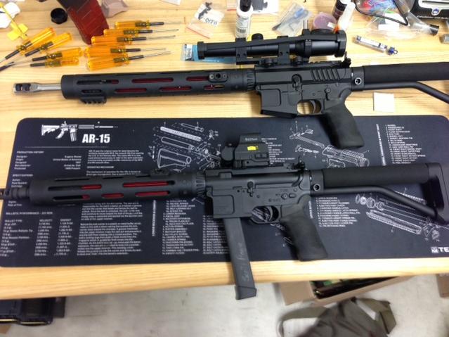

In a matter of hours I will be finishing my 9mm ar build. I am waiting on the fortis rail to be delivered. I researched for MONTHS after I bought the CMMG lower back in February. I decided I needed a 1/10 twist barrel because I want to be able to stabilize the heavier 147 grain bullets. I also discovered I needed a ramped bolt so again CMMG was the bolt of choice. I finally just decided it was cheaper to buy the CMMG upper and customize from there. I built the lower up and put a spikes enhanced LPK in it and then hand stoned all the trigger surfaces for one nice crisp 4lb trigger pull. Have a Vltor stock on it and It will have a heavy car buffer spring and for now just a RRA 9mm buffer but that might be upgraded as well. once I get it all assembled Ill be sure to post pics of it tonight/tomorrow.

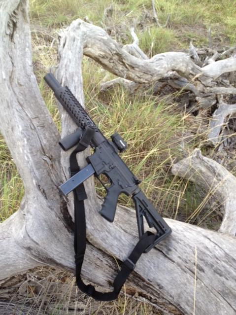

Mine started life as a RRA 16 inch upper receiver but now sports a 9 inch tros 3-lug barrel, swr octane 9 can, rra mag block, CMMG ramped bolt, Metalform/ brownell mags. Aimpoint.
I can dump a full mag into a tennisball or less sized group at 50 yds, almost with my eyes closed.
This is my favorite shooter of them all. It's also a very capable and effective Vermin control on just about anything you can shoot at within 100 yards or less.

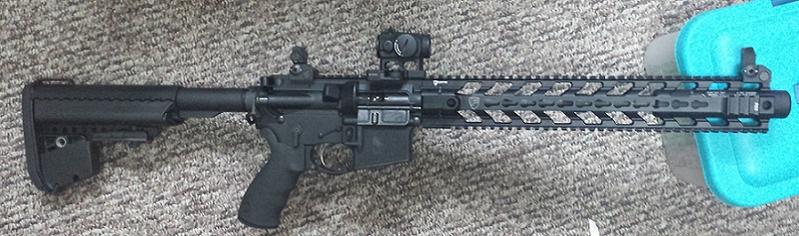

Well here she is, she is shooting very well, very accurate, I am having some double feeding issues but I think it is the buffer/spring combo, Im going to the range with a few different springs and buffer weights to get to the bottom of it. Have about 300 rounds through it and had about 15 feeding issues.
