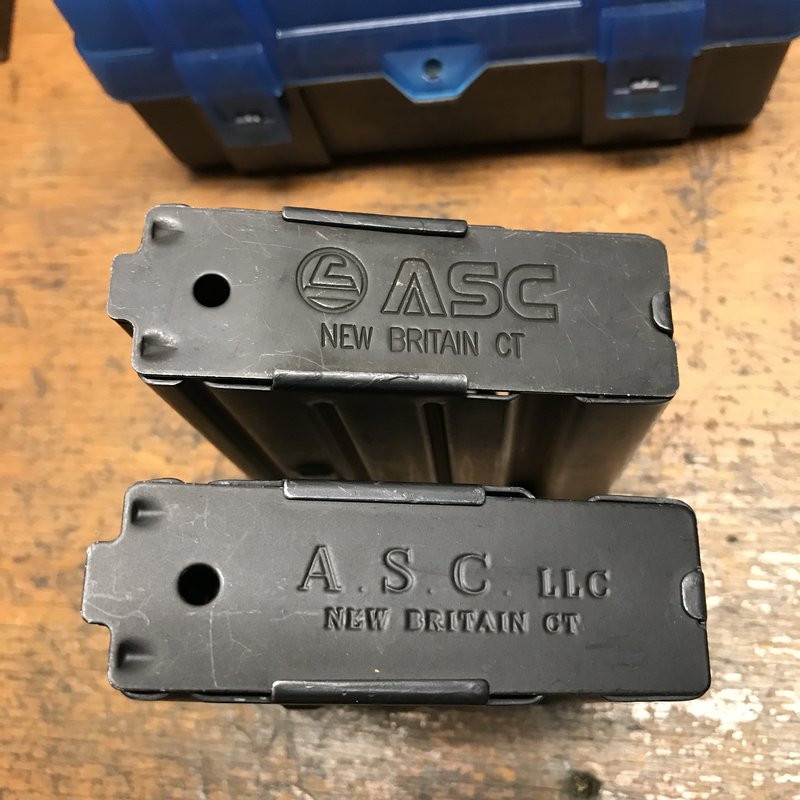

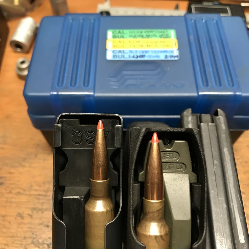

    Magpul limits you to about an absolute max OAL of 2.81-tops. ASC will let you go longer by .040+, at a fraction of the cost of KAC’s, and have proven reliable for me.

    Yeah regular .308 Pmags are really short. Magpul had to make a special 25 rd. Pmag for M118LR which has a COAL of 2.82+.
    I measured a Lancer L7 @ 2.84 and an ASC @ 2.86. I am pretty sure ASC is making Midway’s large frame AR mags.
    Reactions: Keith Pruchnick
    KAC and Larue all day. 2.871" COAL. My optimal COAL for 6.5cm is in the 2.835-2.85 range depending on bullet. Others have used ASC but I have not in large frame gasser. I use ASC in my AR15's for COAL around 2.32 and they run great.

    Here are mags for a side-by-side comparison. You can see by the metal overlap that the DPMS is about .040" shorter than the KAC.
    L-to-R PMAG - DPMS - KAC
